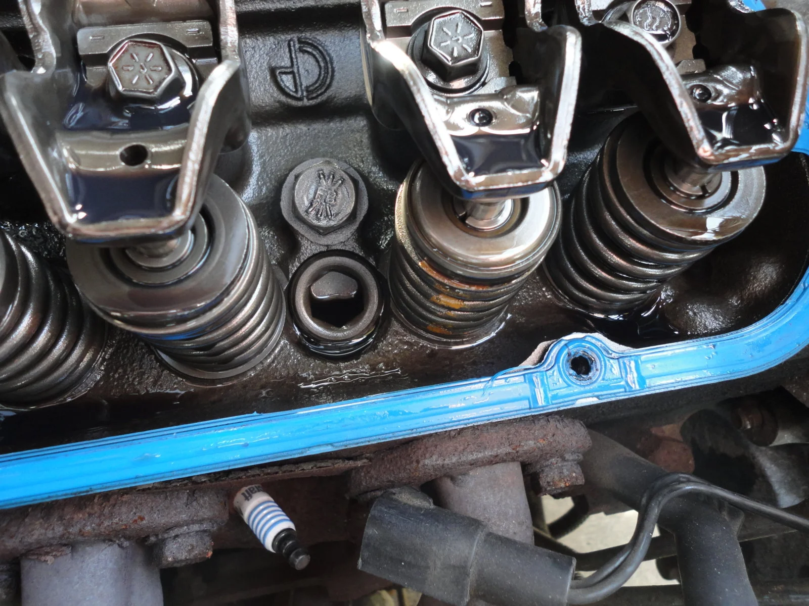

Included are some pictures. I removed the upper intake and passenger side valve cover today. I saw some rust on one valve spring. No coolant anywhere. Lighting from the camera makes it appear there is more rust but there is none. It looks very good under there. The first picture is about where the cover gasket leaked when I put it on last summer. I re-tightened it after repositioning the cover but maybe the gasket is not good, not sure. The leak stopped. When I thought there might be coolant leaking in the same spot, I can't actually say it was coolant. Not sure where the rust on the spring came from. All the rest are good. I did notice the gasket between the throttle and EGR spacer looks to have leaked in the past. Much crystalized coolant around it. Plus a small puddle of coolant in the lower intake manifold directly under that spot. No other leaks or residue found. No coolant in engine oil on dipstick either. No cracked head or freeze plugs. Puzzled.

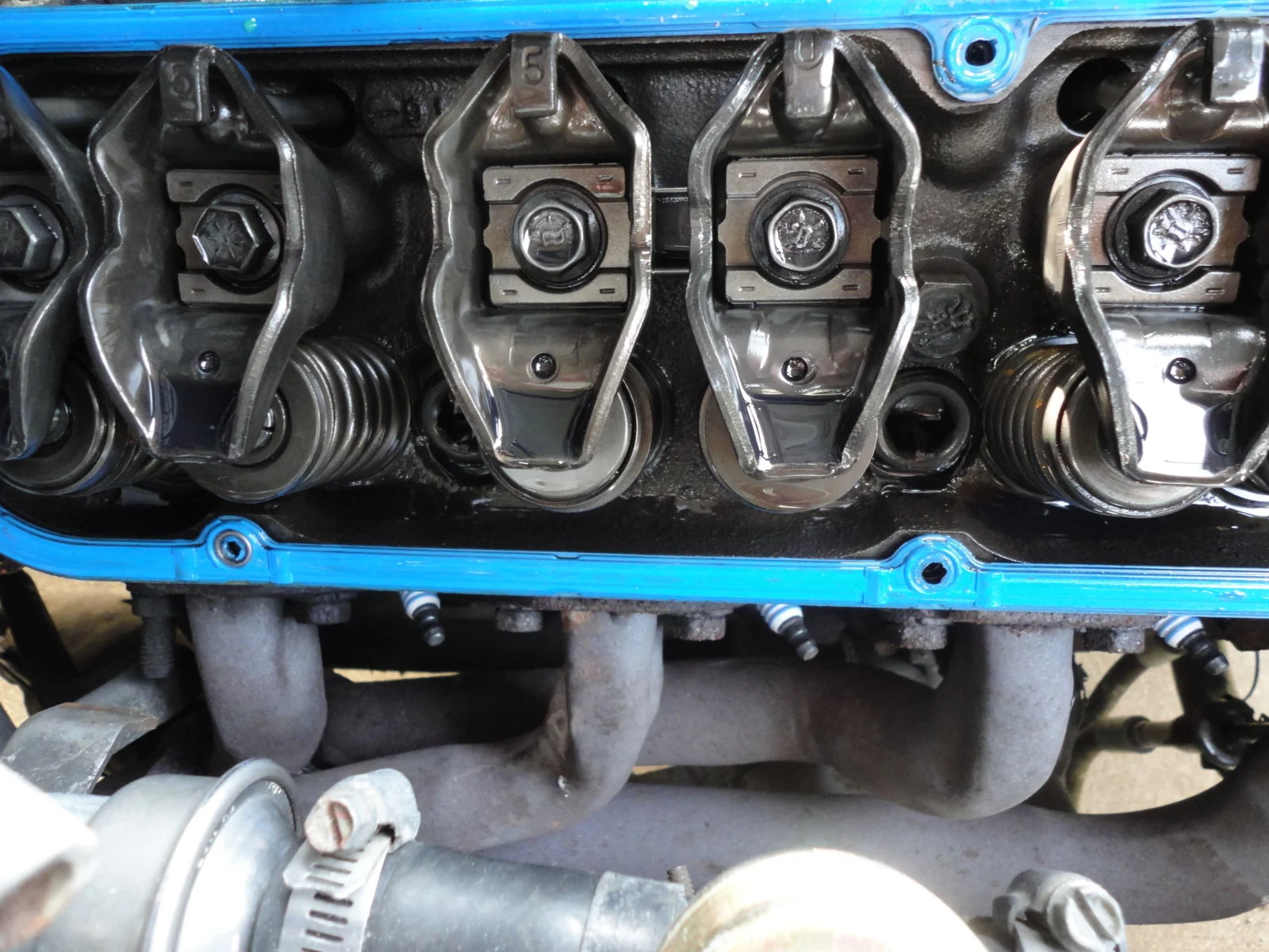

Here's the rust.
