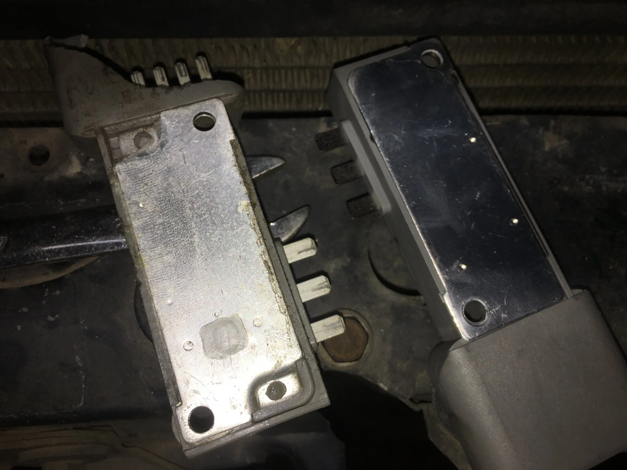

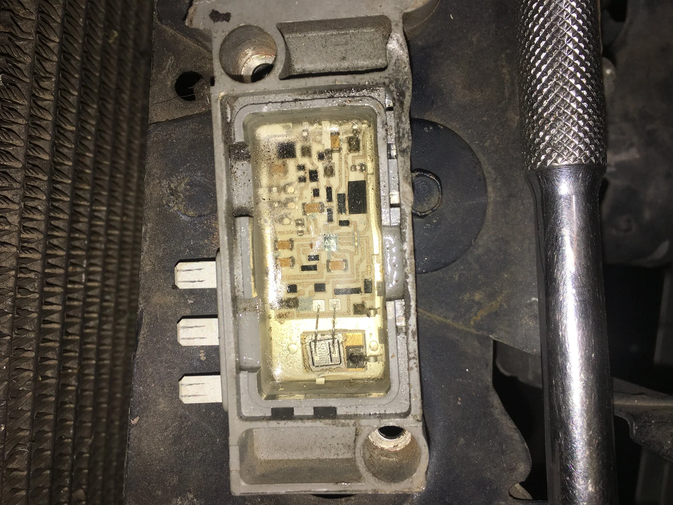

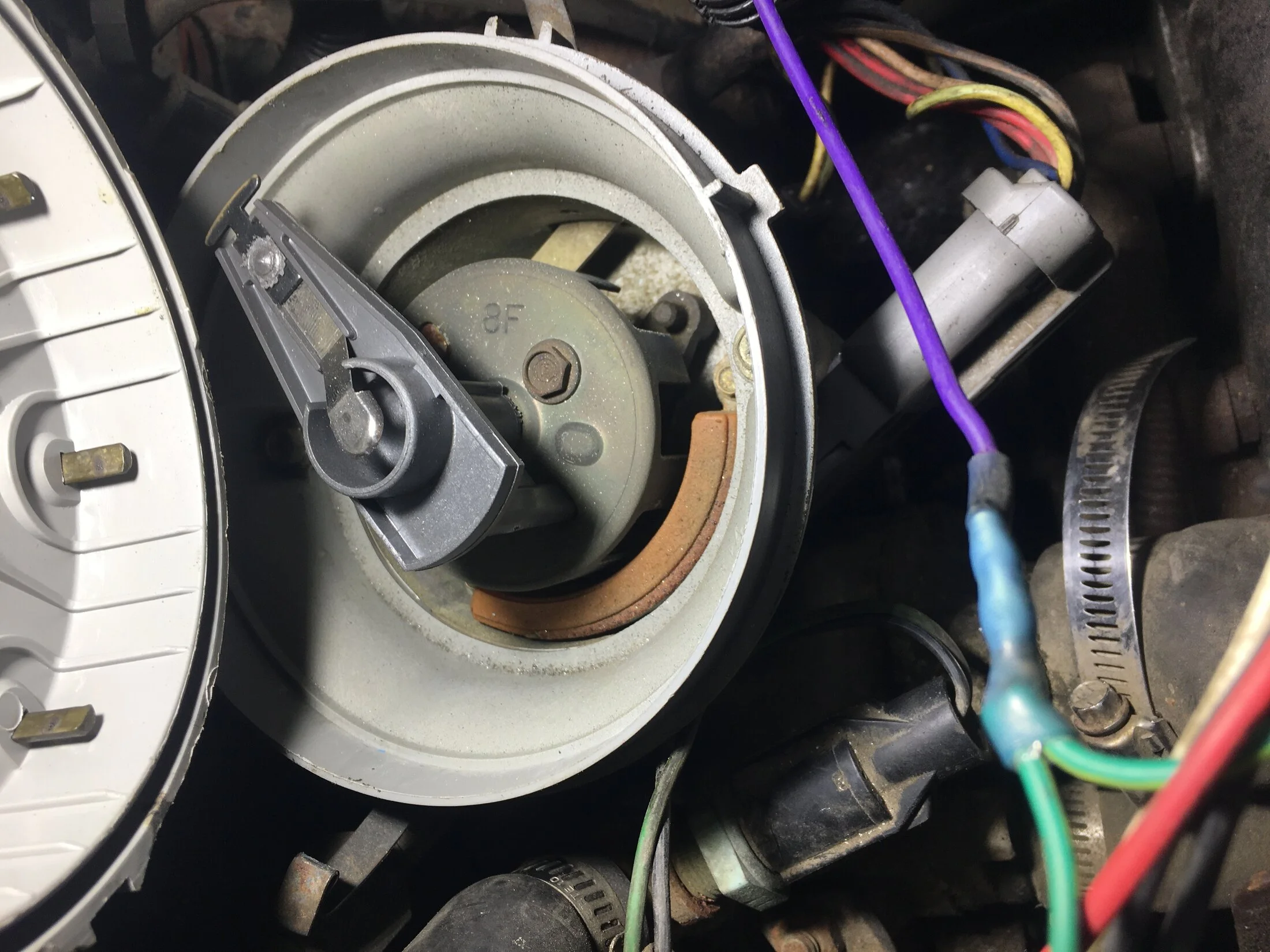

They already replaced the ICM on the distributor (Due to no spark) and had pulled the distributor to do so. I've attached pictures of the one I replaced and what's interesting is you can see the one I pulled off looks like it got hot in a matter of 30,000 miles. It really makes me lean towards an ignition problem rather than fuel. Let me know your thoughts. I pulled the distributor cap and took a picture on the inside. It almost looks to me like I should replace the stator/pickup coil first.

If you are going to replace the TFI module then you need to find a FoMoCo unit and not an aftermarket.
You're the second one to say that. I'm not taking any chances so I just ordered the TFI from Rock Auto. I did not realize they had OEM thanks for the link. I'll check with the ECU company tomorrow. I'm getting tired of working on this thing and throwing money at it :doh: Any idea where the ECU is located?
