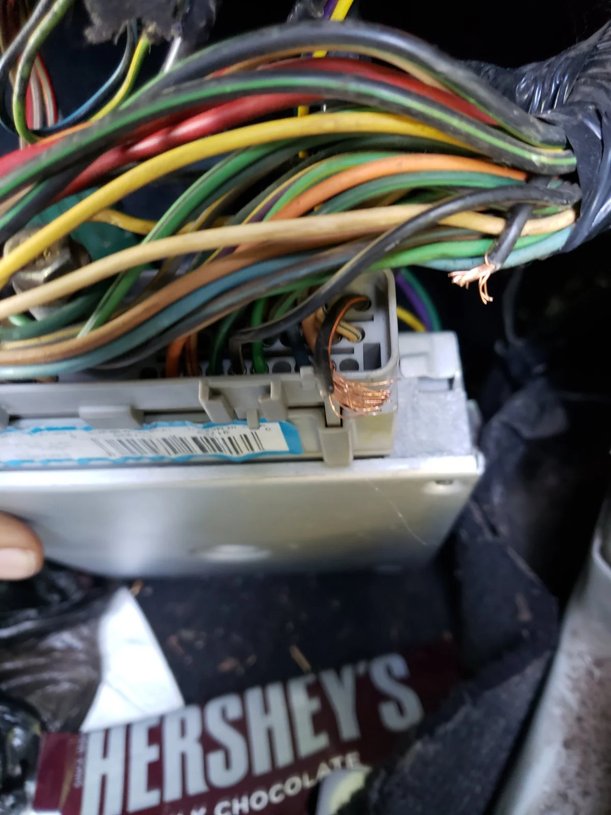

Night have found the issue. Think that's connector 60 and it's just kinda cut.

You saving that chocolate bar for later?

Haha no shes just accumulated a fair bit or garbage over this past year being more of a project than a car. Also cant seem to locate a wire that's connected to pin 46.

Pin-1, Black/Orange stripe, KAPWR (Keep Alive Power)
Pin-46, Black/White stripe, Signal Return for many sensors (ECT, ACT, TPS, etc)

Ok so obviously reconnect the black and orange. Is there a fix for just missing the other one?

It's there, you're counting from the wrong side. Now you know where pin-1 is, you can figure out all the others.

Yeah just thought about that lol. What's the best method for reconnecting? I was told to solder but have no experience so way wondering if there was another solution.

You were told correctly, solder & heat shrink.
You could try a butt splice, but they usually just pull out.
There are heat shrink solder seals, $1.66 for 10 pieces. They might have these at the auto parts store. Remove ECU from connector, wrap a towel around all the other wires & a heat gun does the job. I put these on my watch list. Practice on another pair of wires first.
You want the red ones.

Reconnected and got the heat shrink on there. Now its crank no start unless with starter fluid but it doesnt stay on. Gonna go through the checklist little later today.
