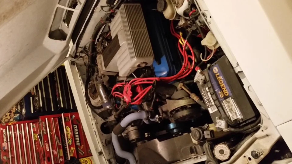

Hello, I am a new member to this forum. I am from kentucky and have a 1988 GT, 5 - speed. It has a B 303 cam, explore intake and mass air, smog delete, full exhaust.
So my problem is when I get it out, and it warms up and say I stop for gas, when I go back to start it, it starts for a split second then dies, and won't start back unless I hold the gas to the floor. It doesn't always do this but I would like to get some ideas why it may be doing this. Any help is appreciated. Thank you guys

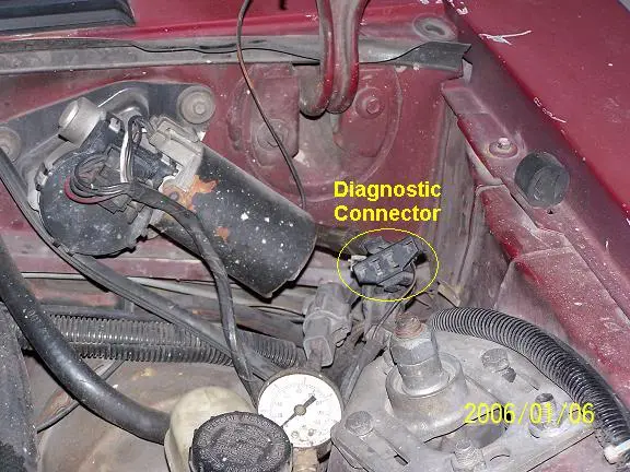

Dump the codes: Codes may be present even if the Check Engine Light (CEL) isn't on.
Dumping the computer diagnostic codes on 86-95 Mustangs
Revised 26-July-2011. Added need to make sure the clutch is pressed when dumping codes.
Codes may be present even if the check engine light hasn’t come on, so be sure to check for them.
Here's the way to dump the computer codes with only a jumper wire or paper clip and the check engine light, or test light or voltmeter. I’ve used it for years, and it works great. You watch the flashing test lamp or Check Engine Light and count the flashes.
Post the codes you get and I will post 86-93 model 5.0 Mustang specific code definitions and fixes. I do not have a complete listing for 94-95 model 5.0 Mustangs at this time.
Be sure to turn off the A/C, and put the transmission in neutral when dumping the codes. On a manual transmission car, be sure to press the clutch to the floor.
Fail to do this and you will generate a code 67 and not be able to dump the Engine Running codes.
If your car is an 86-88 stang, you'll have to use the test lamp or voltmeter method. There is no functional check engine light on the 86-88's except possibly the Cali Mass Air cars.
attachment.php
The STI has a gray connector shell and a white/red wire. It comes from the same bundle of wires as the self test connector.
89 through 95 cars have a working Check Engine light. Watch it instead of using a test lamp.
attachment.php
WARNING!!! There is a single dark brown connector with a black/orange wire. It is the 12 volt power to the under the hood light. Do not jumper it to the computer test connector. If you do, you will damage the computer.

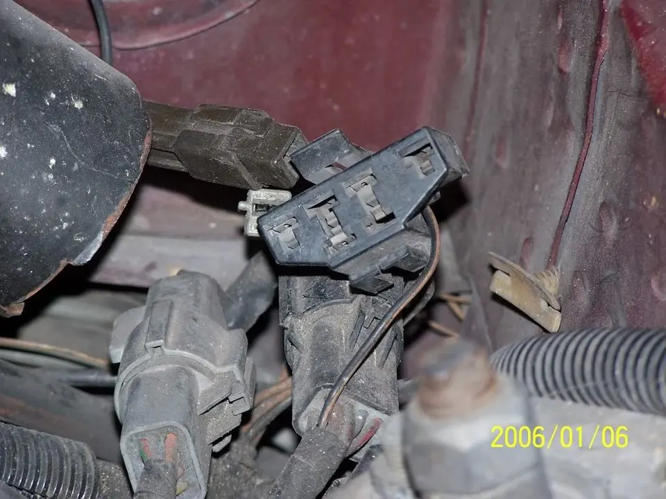

A noid light available from any auto parts store, is one way to test the injector circuit to see if the injectors are firing. The noid light plugs into the fuel injector harness in place of any easily accessible injector. Plug it in and try to start the engine: it will flash if the injector is firing.
I like to use an old injector with compressed air applied to the injector where the fuel rail would normally connect. I hook the whole thing up, apply compressed air to the injector and stick it in a paper cup of soapy water. When the engine cranks with the ignition switch on, if the injector fires, it makes bubbles. Cheap if you have the stuff laying around, and works good too.
B.) Pull an injector wire connector off and look for 12 volts on the red wire when the ignition switch is on.
C.) No power, then look for problems with the 10 pin connecter (salt & pepper shakers at the rear of the upper manifold).
See the graphic for the 10 pin connector circuit layout.
salt-pepper-10-pin-connectors-65-jpg.68512
The injector power pin is the VPWR pin in the black 10 pin connector.

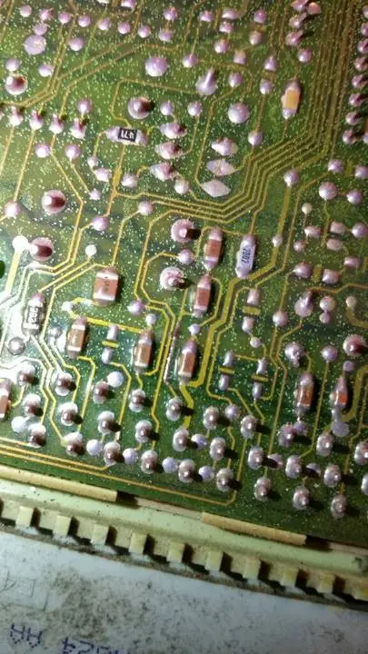

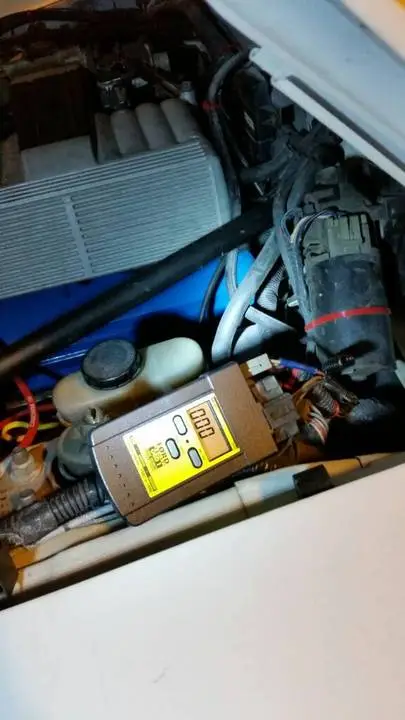

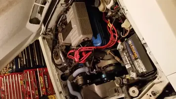

1988's don't have a functional check engine light, so keep that in mind. You just need to remember to randomly check for codes.
I had this same issue with my Mustang way back. When the car was hot, it would crank and crank and not restart UNLESS i held the gas to the floor. Then it would start up.
Ran the codes...ended up being a bad ECT sensor. Replaced it and problem solved.
Ok so it took me a while to get back to this post. I really appreciate everyone that responded!!! I bought the fancy code reader and got it in today. It says to 1. Turn on car- 2. Hook up and press test. Well when I do this It doesn't read codes. So some info I know on car...
1- it was a factory auto car, turned into a 5 - speed. Has the A9L computer in it now
2- I assume it was a speed density car from factory? Now mass air
I'm new too the foxbody and I'm very mechanical inclined so I understand anything, but new to the old type cars
Please and thank you for any feedback!!!!
okay since your car was switched to mass air have you removed the vacuum hose from the bap/map sensor? Also have you checked the computer ground? I have the same code reader as you and if you have the key on run and press the test button it should read any stored codes.

Ok, I done the first step of this ground check. From the black/white wire on the test connection and battery ground igot like 2 K (killa i think)ohms? Then unhooked computer and check between pin 46 on harness and black/white wire. Like .2 ohms. So I checked the pins on ecm- 46 to 40 and 60. OL, open load, nothing. I have another computer that I just pulled out of a good running car. The ecm test the same. Both cars run fine. The donor car didn't have a Check engine light on (but not to say it was pulled or something) I had just bought the donor car 2 weeks ago for the tranny. Then parted the rest out (don't kill me, the body was bad) and I got some great parts for my car. I just wanna fix mine right. And one more question. Where does the O2 sensor harness hook up at where I can check whether it has the auto one in it still?
Thanks again for all the help. I'm just trying to get my baby perfect!
Ok I just took the ECM apart and it's fried like the one on the link to fix it. So I think I will try and solder it, but my thing is what can I do to make sure it doesn't fry again?
Edit-Both ecm's are fried
