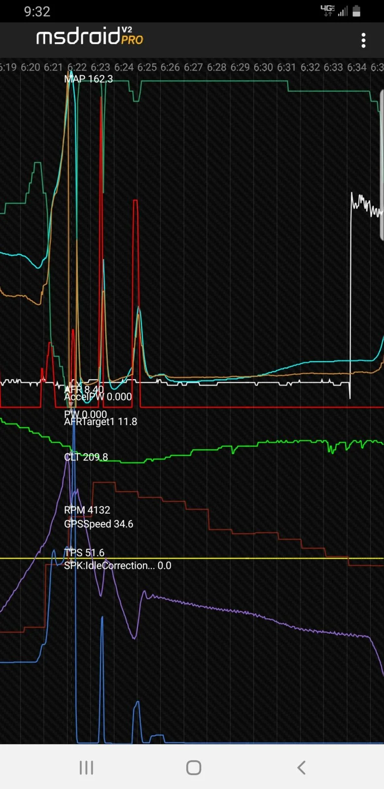

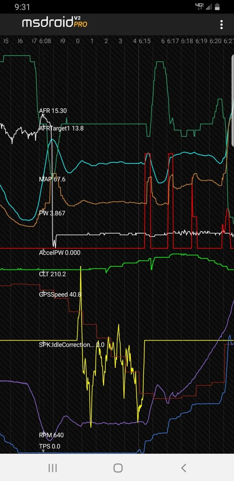

Ok...so...I forgot to update this thread. The car is now starting and running again. My cranking PW was way off ( due to base tune I loaded from MS when I first got MSPNP2 ) causing the car to flood on cold start. Talked to Steve and changed plugs and loaded necessary corrections. Project is kind of stalled at the moment. Gotta feel this car payment for a couple months to smooth out my finances. Lol
Dusty starts up every time with a prime and a crank. I'll post the updated tune and log as soon as I can.
