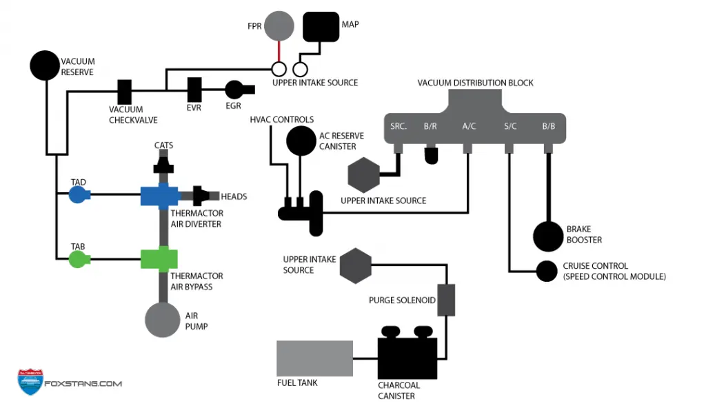

That is the other end of air injection stuff, Thermactor
Mustangs.
The thermactor air diverter either pumps air into the head or the exhaust, that pipe your referring to is for the exhaust side of the diverter valve
