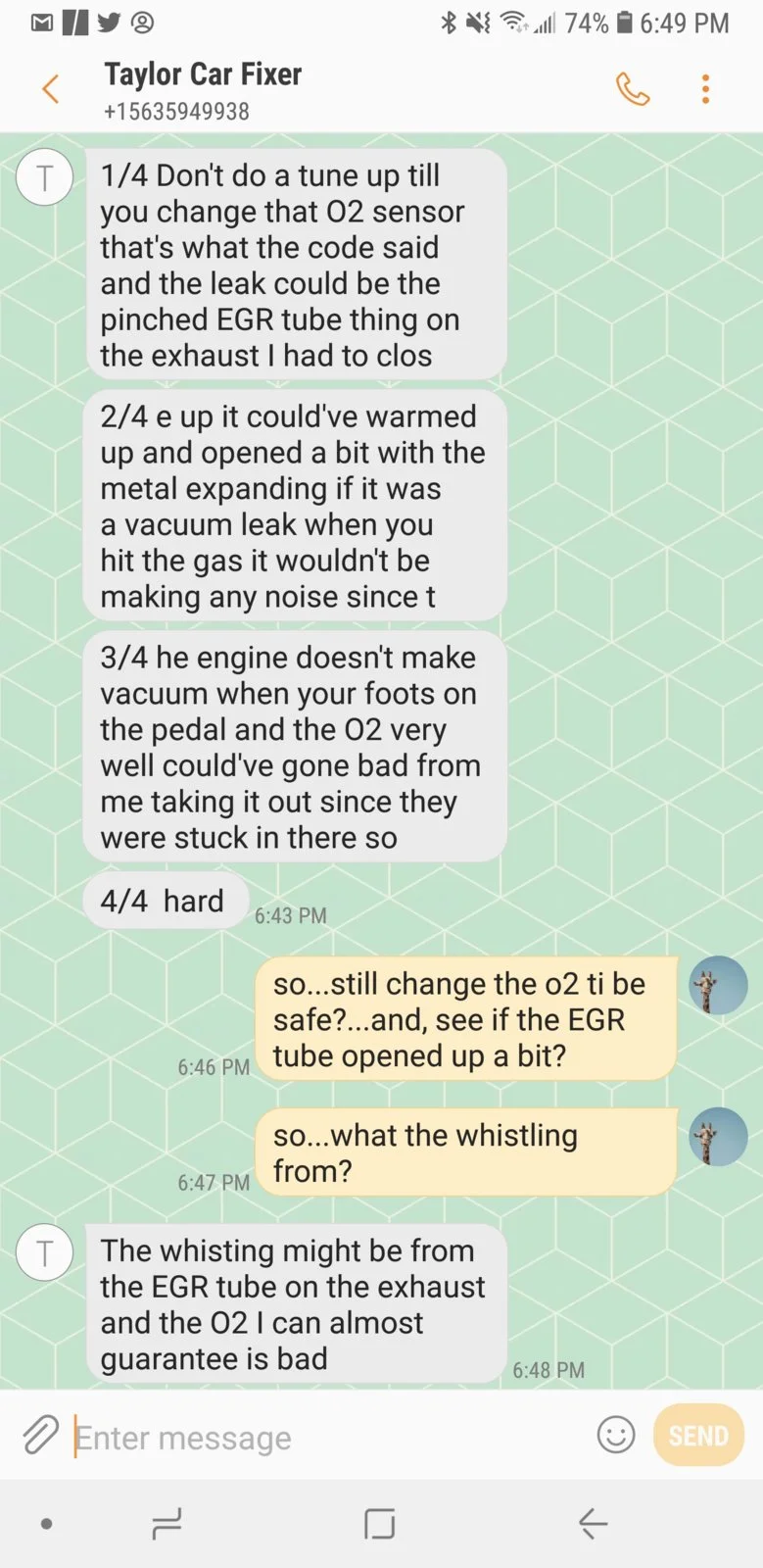

Engine 1989 header xpipe cel
I was accused of attaching a whistle to a friends truck under the hood at the bottom of the radiator, drove him crazy try'n to figure it out, I'm kinda of a practical joker.
and it was never proven that I did it :rolleyes:
Well understand that a whistle at speed cannot be diagnosed over the internet, what you hear as a whistle may be described as a squeal by someone else. A miss aligned body panel or a tear at an opening in the radiator support can produce a whistle. Even a window not sealing well can make a whistle noise.
true...gotcha

yea...jricher, gave me a great write up....most of the things seem intimidating...I did clean the IAC, cleaned the MAF....I'm thinking a leak or o2...just pisses me off...new pipes sounds great, but no power....kinda embarrassing...
Don't remember what you have as far as bolt ons but if your cel is lit it's in limp mode, reduced power, go through the checklist, don't skip around, believe me it will help you resolve your issue. I had to go through the list twice with a low rpm bucking issue when I realized I would have to undo a bunch of stuff I did. Took a while for me but it does work.
A leak in the exhaust from not being properly installed could set off O2 sensor codes. Sounds like you might have a leak where the mid pipe is bolted to the headers. Do you hear any ticking? When my passenger side header gasket went bad (from not being properly tightened) it sounded like a metallic tick. It basically sounded like a noisy rocker until it warmed up. Either the O2 sensors were damaged, or you have an exhaust leak from one of the flanges not being properly tightened and/or adjusted in place (probably causing the whistling). Does it whistle when you rev it?
