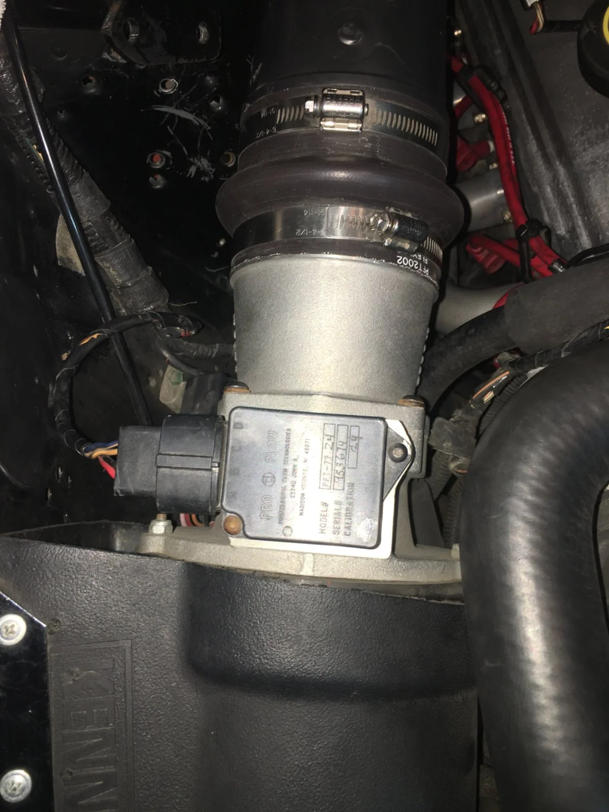

Walbro 255LPH fuel pump
Pro-m Mass Air Meter - PFT - 77 - similar to now Pro M 80. says its calibrated for 24lb injectors
EGR block off plate
24LB Fuel Injectors

Have thought of looking into Pro-m & mirco/megasquirt computers. Our gut feeling it does not know how much air/fuel its getting then rich, computer issue. We also think the noise might be a bad rocker arm.
Plan on testing the MAF sensor (voltage & ohms) in near future | https://foxstang.com/complete-efi-sensors-fox-mustang-eec/

Figured out the fuel pressure regulator was bad. It was allowing fuel to be pushed into the upper intake, can check that off the list... Idles like a champ now.
