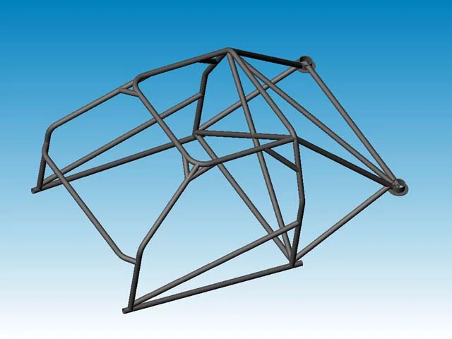

I am basing a cage design on this (thanks Ted) and turning the hatch into a rally car someday....(see attachment).
