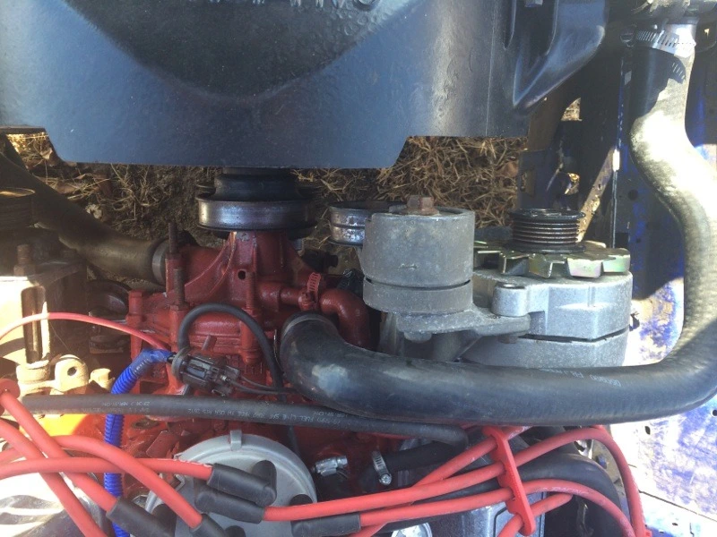

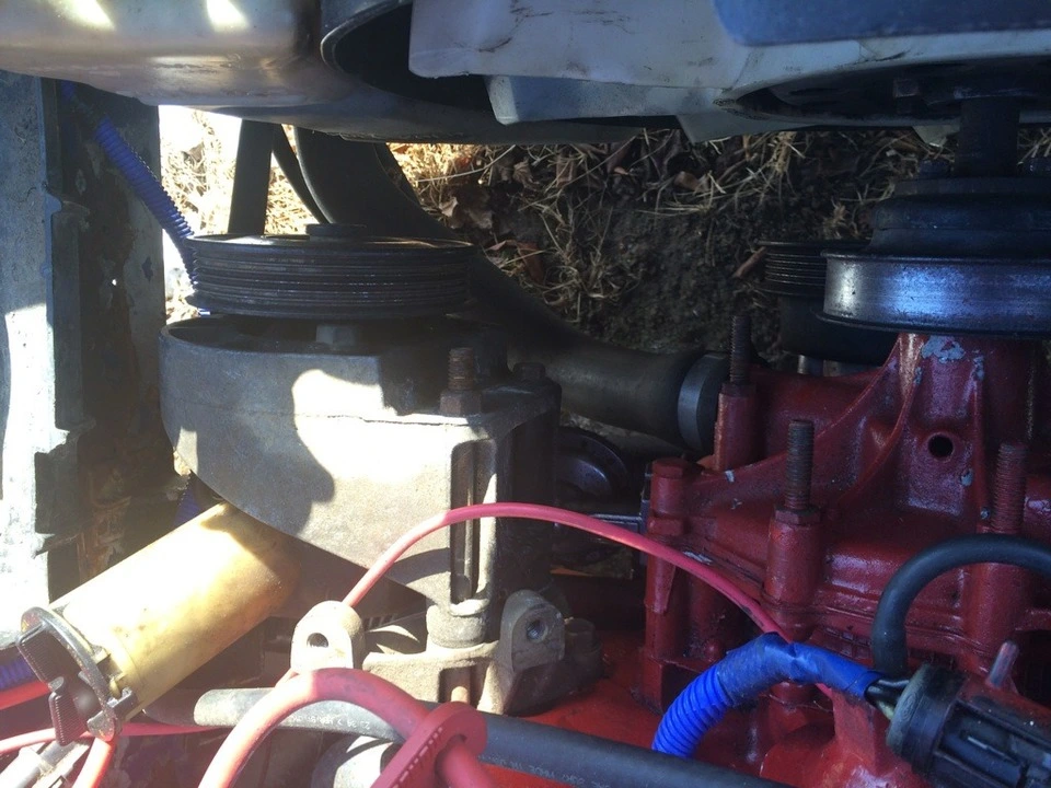

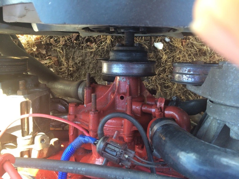

Hi I'm new to the forum and no I did not search normally I would but I'm in a kinda time crunch. I'm going to look at and possibly buy a 1990 lx notch back. The car has 1980 302 engine in it. The owner says it needs both the alternator and power steering brackets replaced. I have found a few on summit and jegs. He has the accessories (alternator and power steering pump) from the 1990 engine that would be used. What I need to know is what brackets should I be looking for? He said he tried using the 1990 5.0 brackets but they cracked and through the serpentine belt. Also would I be able to use the factory specified serpentine belt for the 1990 5.0 even though it is a 1980 302 engine.

The 1980 will be a flat tapper block, but should not be a relevant issue. i would want the brackets from all either 1980, or 87 -93. I do not have a Hollander exchange, but the 90 brackets and 90 accessories should be a fine match.
You will need the matching pullies as well as i beleive prior to 1984 the mustang was using V-belts.
Basically find a photo of a 1986+ Mustang 5.0 engine. You want those bracketrs and pullies.
My 79 5.0 had a serpentine set up from the factory. So that should not be an issue. I hope the accessories have the 90 pulleys, but that is an important part of the set up.
If all parts match, it should not be a big problem at all.

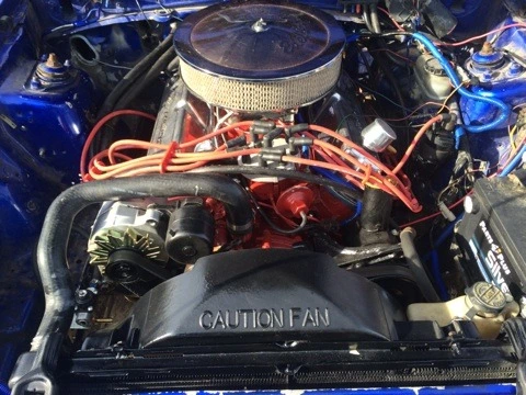

Need a pic of the engine...specifically current accessory setup and pullies.
From the pic though, it looks like the later 6-rib pulley system was used.
BTW, IIRC, the 5.0 alt/PS bracket is cast, and frequently has marks on them that appear like "cracks". In reality, unless involved in a vehicle crash, pretty hard to break that thing.
