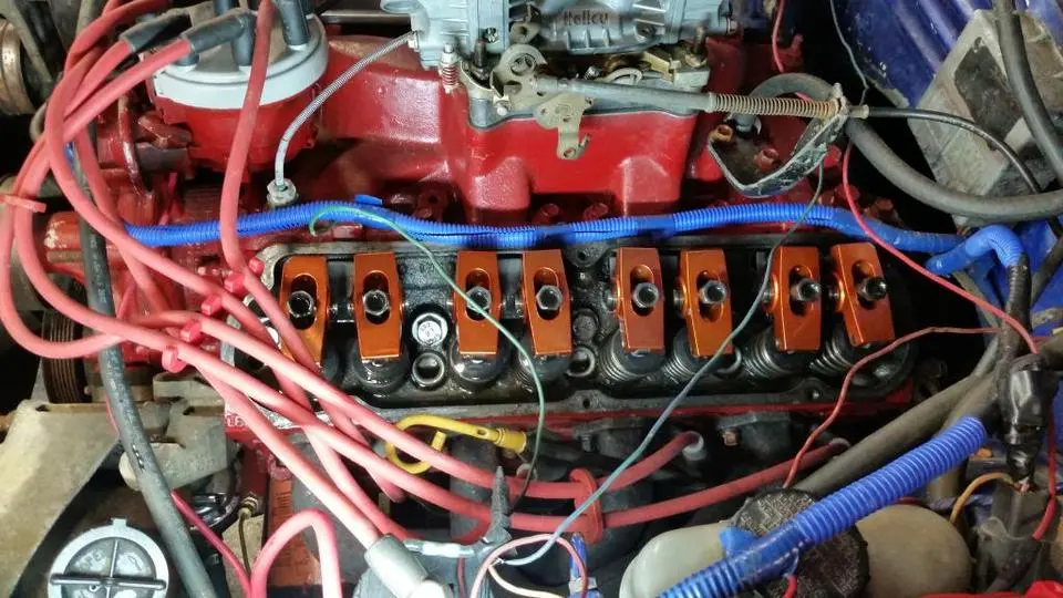

If you are keeping the engine, I would want a roller cam engine.
Just because it has roller rockers, does not mean it is a roller cam engine. When we refer to this, we mean the lifters that ride on the cam itself have rollers. If that is a 1980 block, it would be a "flat tappet" cam engine, meaning the lifters are flat where they meet the cam lobes, and because of our lovely EPA, you have to run zinc additive in the engine oil now.
Ok I see what you are saying and can this converted? Also does this apply (epa) if the vehicle does not have to go through emissions. But I have purchased royal purple high mileage oil which has added zinc to the oil.
With a carb on a 1990, I don't think you're going through emissions. Lol, as far a converting a non-roller to accept a roller cam, easy. Look at the bottom of the page on this link:

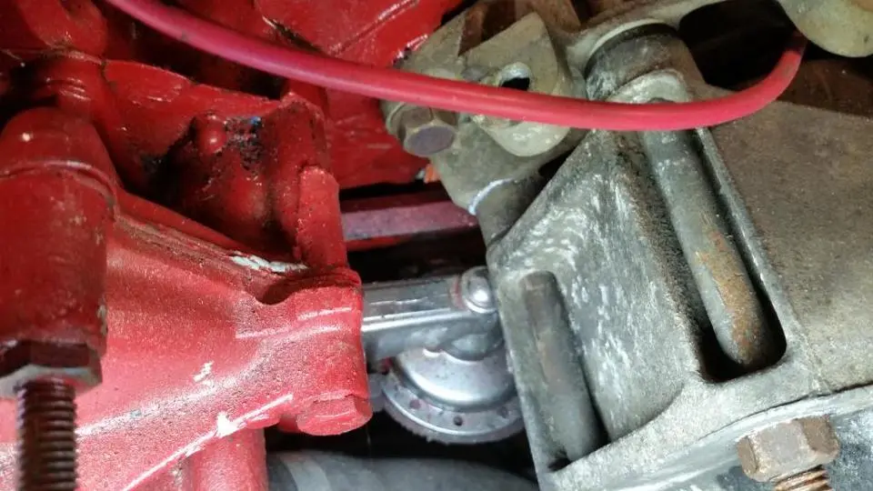

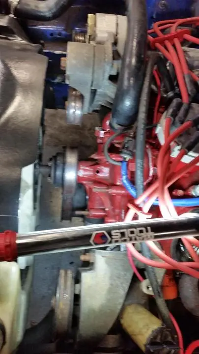

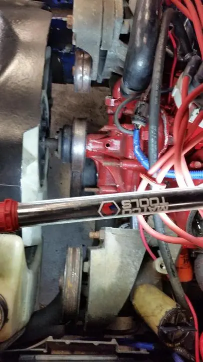

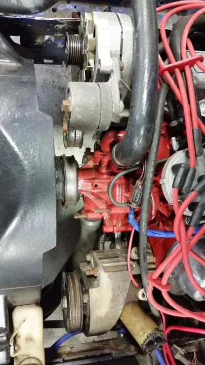

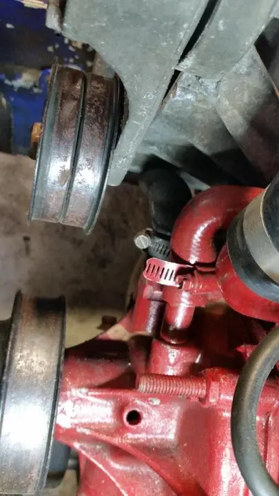

Ook haha and thank you I'm glad to be back in the mustang world. I found which bracket was broken and waiting on the piece from foxresto. The only thing I'm concerned about is it looks like the belt will touch itself in the routing going past the tensioner to alternator and back
I do not see where the roller lifter vs. rocker was confused. If the owner is honest about it having the E cam, it has either stock or aftermarket roller lifters too. But the OP will not know until tear down or after a tedious process.
And I agree about not passing emissions testing with a carb in place of EFI. But if that is not required in his county, the OP's mechanical experience can help make up for any other hacked part of the conversion and still make it worth buying.
I'm going to assume that it has been changed because of the sound of the engine. I've heard flat tappet motors and they have a distinct valve train noise. Although I'm aware that I truly won't know until the engine is apart. The guy I got the car from wasn't too knowledgeable about the motor except for the obvious things and the cam and it being bored out. He got the engine from a friend who builds engines professionally. The motor sounds very healthy and I do plan to eventually take it down to find out what all is done to it. The car needs some Tlc but I'm glad that I got it just a few things to figure out with the belt setup and then clean the half ass wiring up.

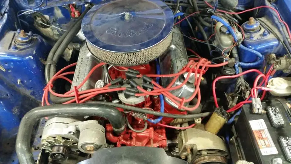

This should be pretty easy. Only assessories the car is running is the water pump, power steering and alt.
Looks like the tensioner and alternator are in place, and that looks like a late model setup there. On the driver's side of the motor, the front support for the A/C accessory bracket was removed and they just bolted the P/S pump to the inner mount, which is wrong.
However, the Ford racing A/C delete should clean that up nicely
