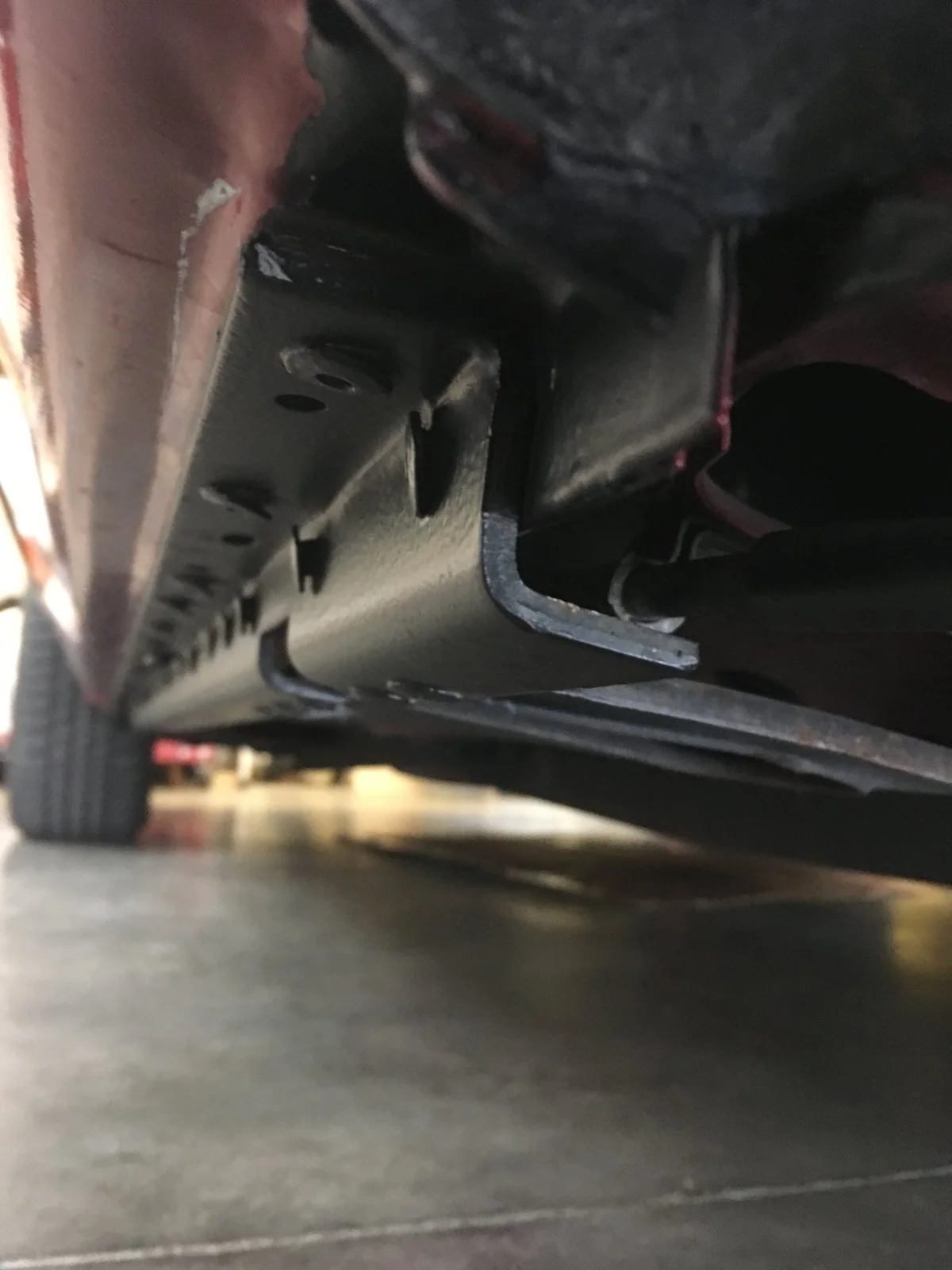

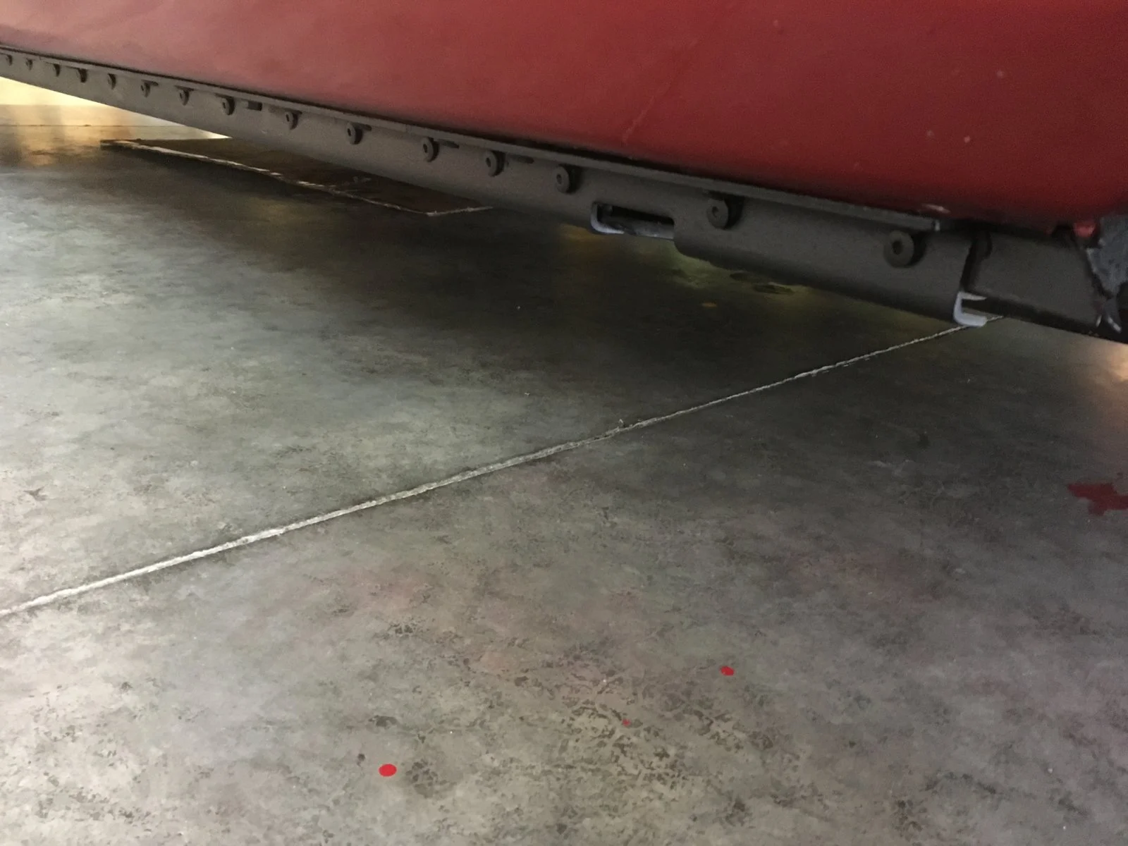

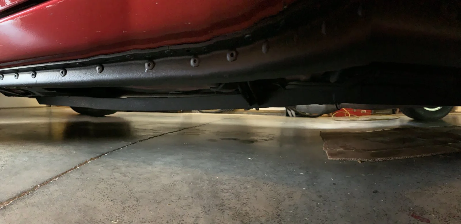

I purchased this 1990 LX convertible last spring. I noticed that it had steel J rails riveted to the length of the underside of the rocker panels. Once I got it home and looked closer at these rails I realized these were not factory. Who ever installed them didn't make sure the rivets pulled flush. I did see photos of one other convertible that had these rails with the same type rivets. Is anyone familiar with these J rails? Are they an after market item or some home made solution to stiffen the body? I'm considering removing them and have the holes filled (If I can find a body shop capable of doing a good job) Any suggestion, thoughts??

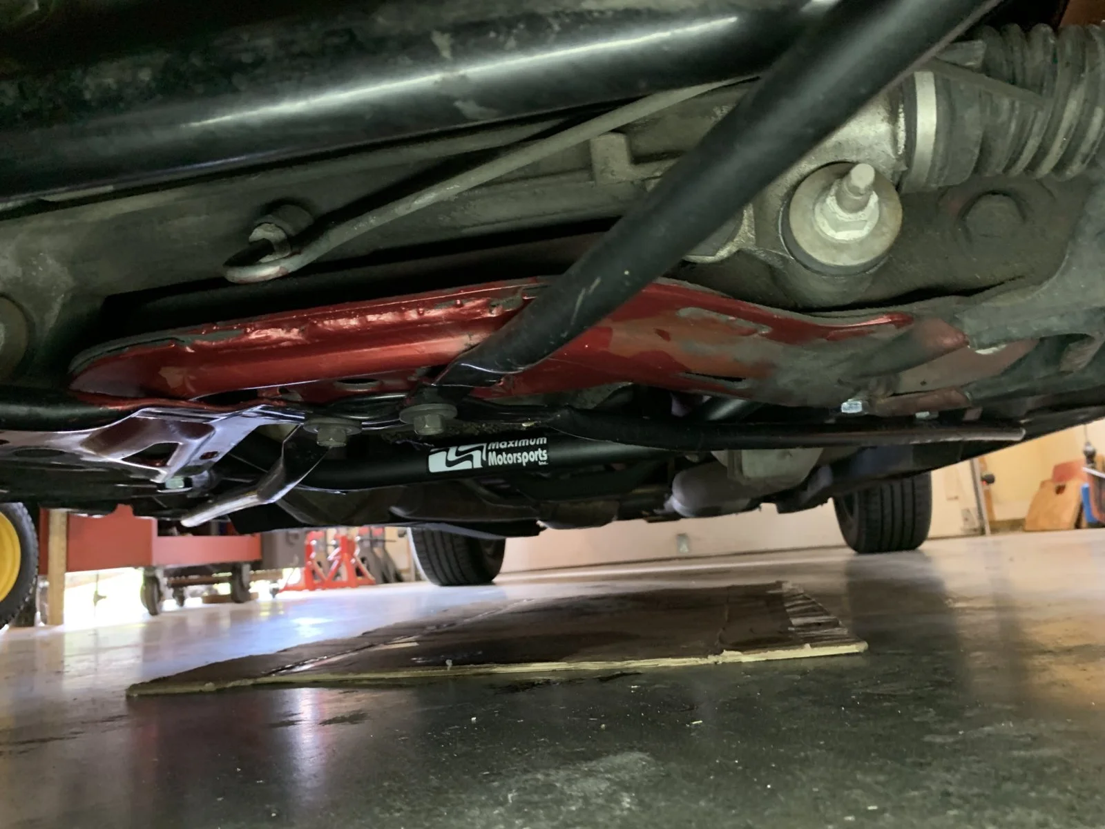

All foxbody convertibles started life as a coupe, the factory sent them to a third party to have the roof hacked off and the convertible conversion done to them. Those J rails are there to stiffen the factory unibody since the roof is now gone and not providing structural support. They were installed at what you could consider 'factory' before they ever hit the dealers lot. My convertible has them as well, you should consider having a set of subframe connectors installed on the car if they are not already. These will help stiffen the body much more than it is now by tying the frame rails together. MM is a great company and there products are top notch if you go shopping around i highly suggest giving them a look.

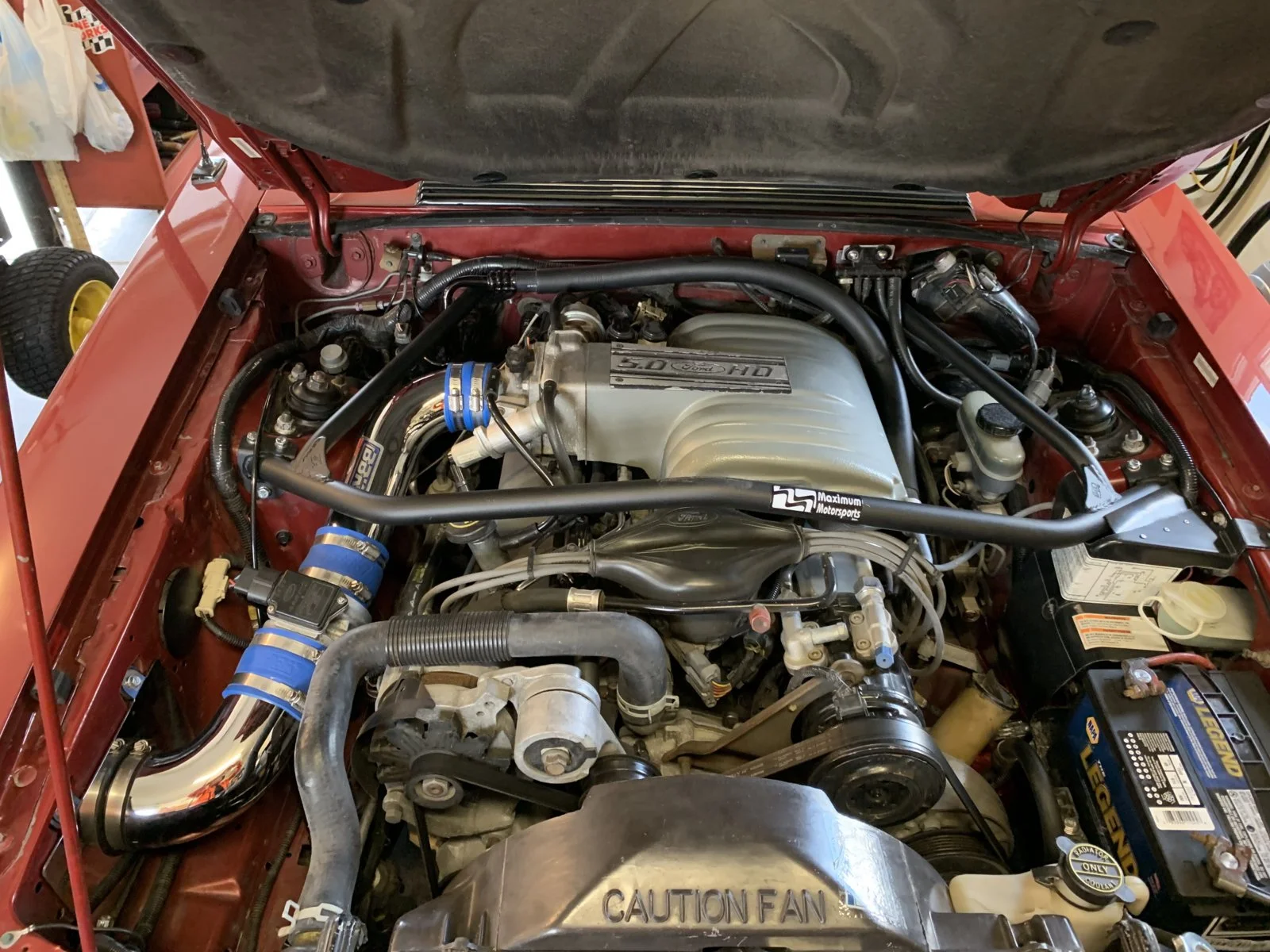

Thanks for your response. I feel better about those J frames now. Think I will leave well enough alone. I have added the MM frame connectors and the shock tower brace and the K member brace. I also put on the BBK cold air intake (seemed to open it up a little bit) and the Flow Master exhaust. (the 2 chamber mufflers) Sounds decent but I thought it would be a little louder haha. Next step I think I'll upgrade the sway bars. Probably the Eibach set, wondering how much difference from the stock ones?
