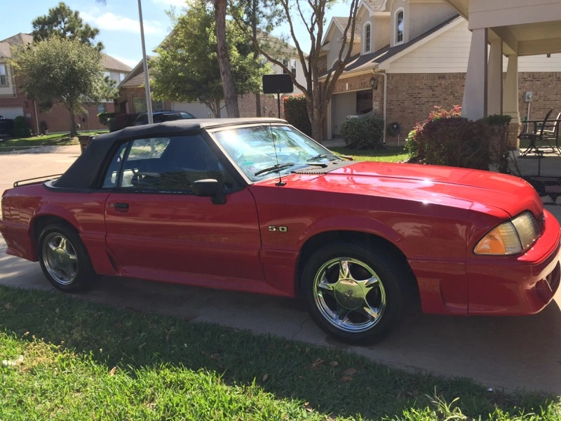

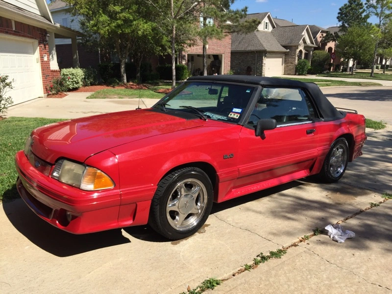

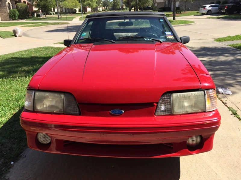

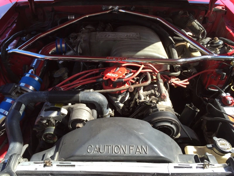

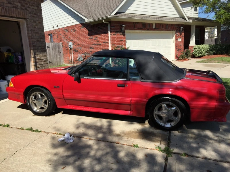

Figured I'd show my progression,
Basically stock, BBK CAI, MSD Ignition, H-piped with super 40s and drop offs. New spark plugs, 19lb injectors and radiator. Oh and a strut brace. The previous owner got in a front crash, and "repaired" the front, but the bumper hangs low, just needs a new radiator support. He also replaced the front seats with black power seats. Other then that its stock. I plan on rebuilding the engine and transmission this summer though. I'll post when i get something new put on, won't happen that much because im in high school lol.

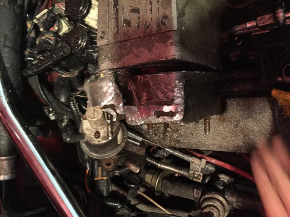

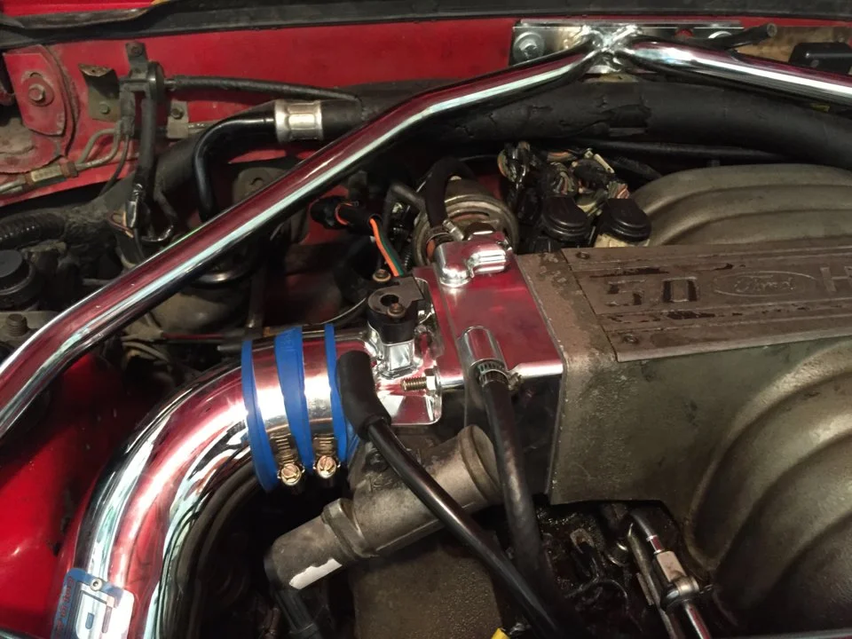

Man. I got a new acuufab 70mm TB and spacer.... Got the old TB out but this egr spacer doesn't want to come off... I've soaked it with wd40, beat the crap out of it with a rubber mallet, flathead and hammer, double nutted... You name it. Anyone know a better way to get it off??

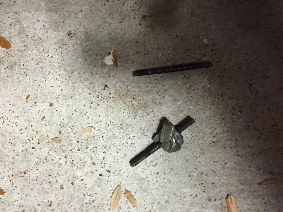

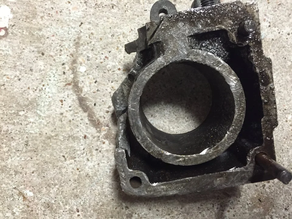

Finally got the spacer out!! Not the way you expect though... Managed to pull one stud out by double nutting, and the 2nd stud got cut out with a jigsaw lmao. Used a crowbar to yank the spacer off and 2 studs broke off.... Then used an ez out to take them out!!!! All for a little throttle body. Glad it worked it in the end.
