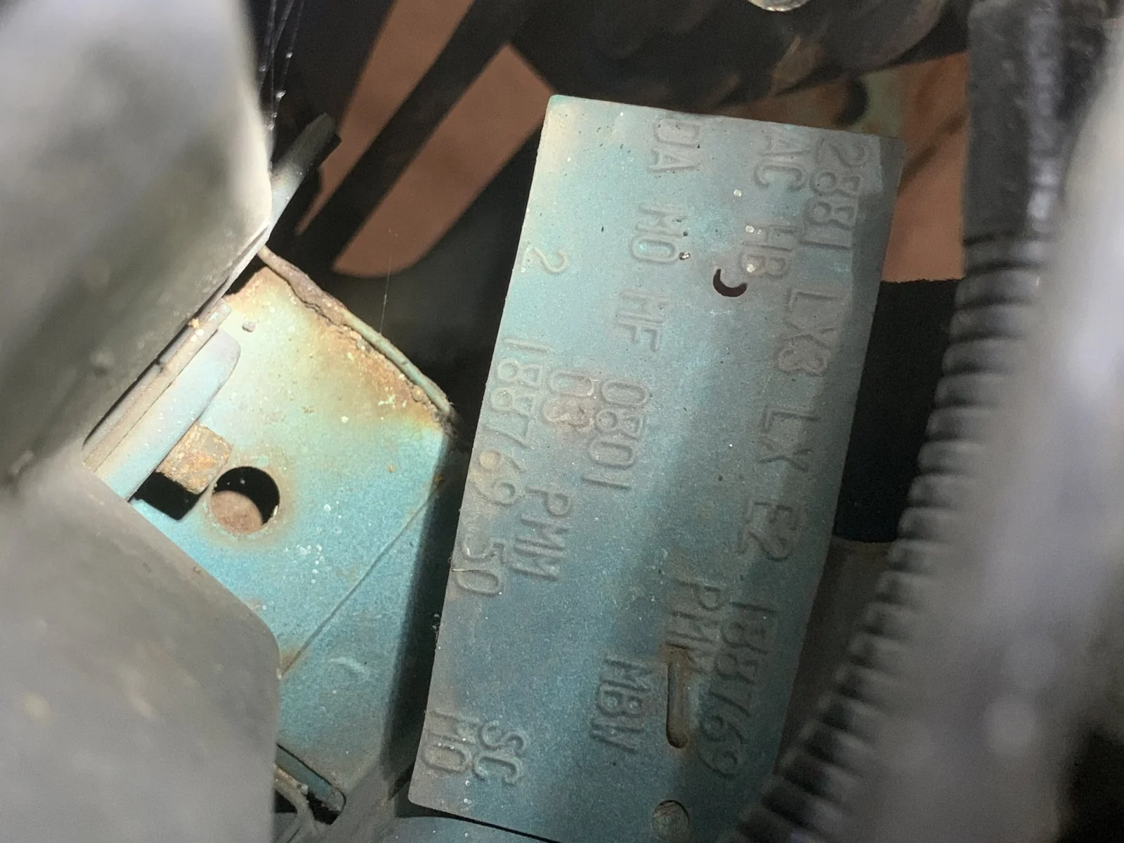

C Calypsostang New Member May 19, 2019 5 0 1 Virginia May 19, 2019 #1 May 19, 2019 #1 I recently purchased a 1991 LX and was needing help decoding the Buc tag since the doors are from a different year. I’m wanting to repaint!

Mustang5L5 That is…until I whipped out my Bissell Mod Dude Feb 18, 2001 43,275 17,965 224 Massachusetts May 19, 2019 #2 May 19, 2019 #2 Reactions: General karthief
Mustang5L5 That is…until I whipped out my Bissell Mod Dude Feb 18, 2001 43,275 17,965 224 Massachusetts May 19, 2019 #3 May 19, 2019 #3 From the pic, I would assume calypso. The buck tag says PM which is the paint code for it. Got a pic of the car?

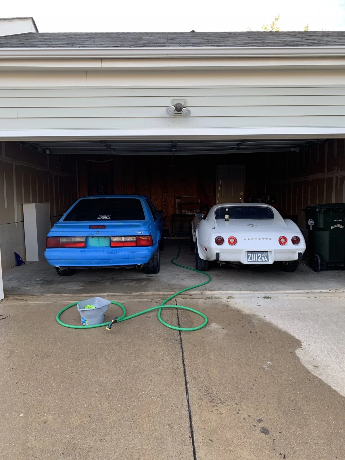

C Calypsostang New Member May 19, 2019 5 0 1 Virginia May 19, 2019 #4 May 19, 2019 #4 Mustang5L5 said: From the pic, I would assume calypso. The buck tag says PM which is the paint code for it. Got a pic of the car? Click to expand... The person who had it before me painted it an awful spray paint blue! Do you by chance have any idea what the rest means? Attachments C5025AF5-D102-48CD-B866-7AF2D0411CAF.webp 255.5 KB · Views: 213

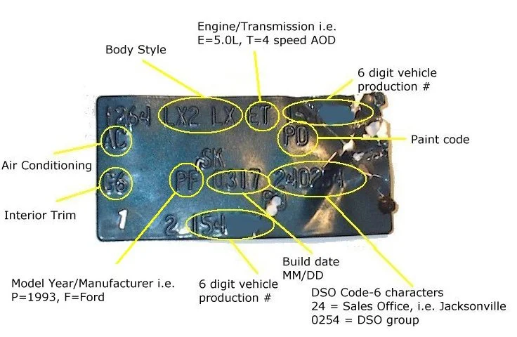

Mustang5L5 That is…until I whipped out my Bissell Mod Dude Feb 18, 2001 43,275 17,965 224 Massachusetts May 19, 2019 #5 May 19, 2019 #5 Try this 1979-93 Capri & Mustang Buck Tag Decoder foxchassis.com
F FoxChasis 20+ Year Stangneter Dec 23, 2003 589 276 93 May 20, 2019 #6 May 20, 2019 #6 Had to fix some bugs in the code so that decoder should work for this entire tag now.
C Calypsostang New Member May 19, 2019 5 0 1 Virginia May 20, 2019 #7 May 20, 2019 #7 FoxChasis said: Had to fix some bugs in the code so that decoder should work for this entire tag now. Click to expand... Thank you very much it all worked out.

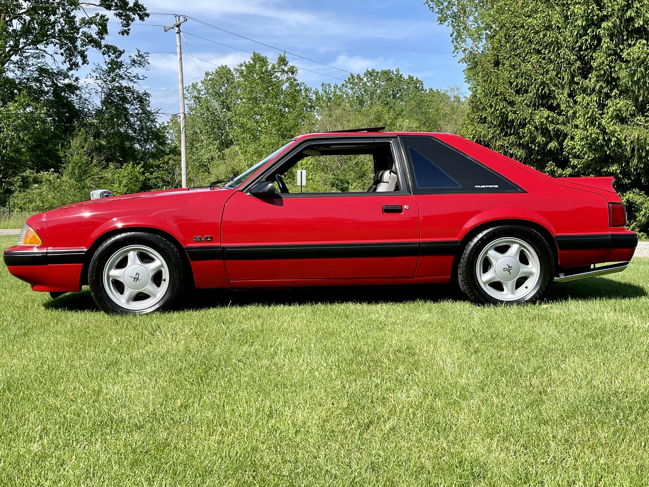

M mcpheemotorcarshotrodshop New Member Jun 25, 2023 1 0 1 Jun 25, 2023 #8 Jun 25, 2023 #8 Calypsostang said: I recently purchased a 1991 LX and was needing help decoding the Buc tag since the doors are from a different year. I’m wanting to repaint! Click to expand... Our Mustangs were built with exact same options except color 14 days apart! Attachments 2022-05-28 16.40.02.webp 1.1 MB · Views: 103
