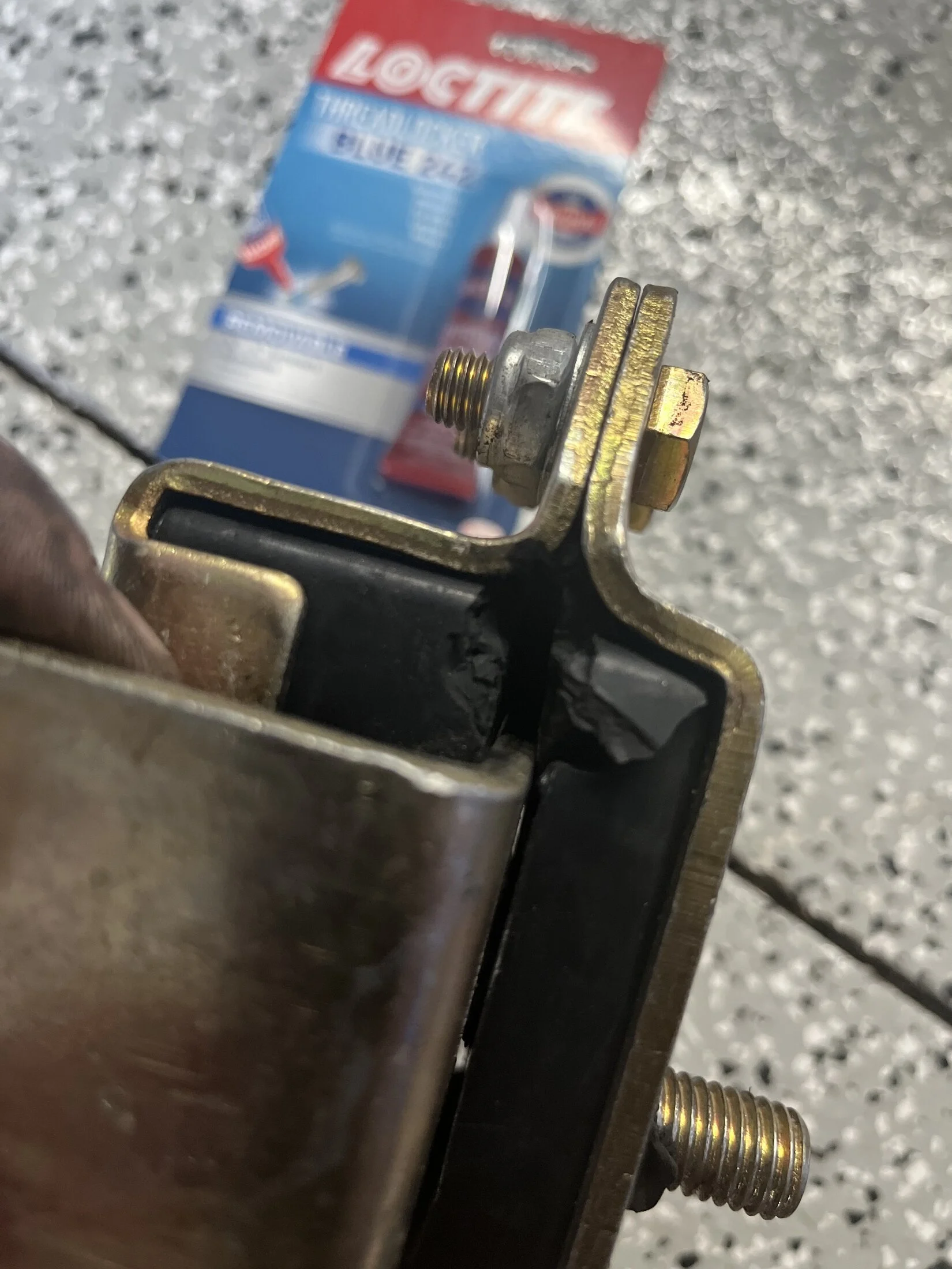

I have an issue with my 1991 Fox Convertible. It started shaking on a roadtrip to a meet. My friend noticed that the passenger side motor mount was broken. So I replaced that today n checked the driver side n all tightened to specs. Took it for a spin n still shakes like crazy. The engine is stock. Am I missing something? It never shakes like a Harley Davison motorcycle before. Forgot to mention that it shackles leaving a complete stop n when it shifts to second. Seems like something is easier loose or broken.

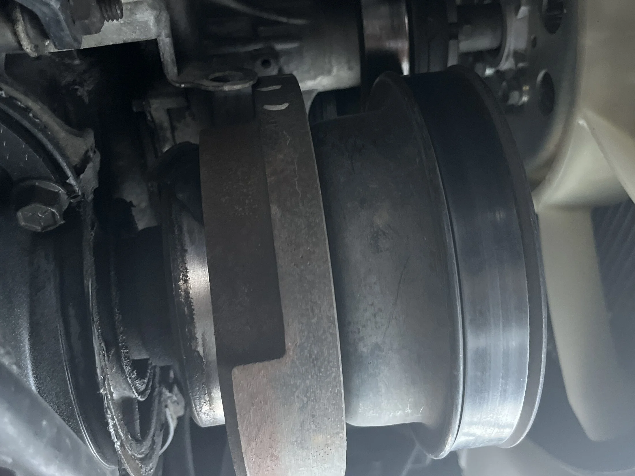

Well. Well I found the problem. Broken balancer. Rubber is coming out the top. That’s what broke my motor mounts.
This one is a good read with a lot of brands and varying opinions on them.
Just me but I’m not one to buy a crappy part just because it has a lifetime warranty that and the work to replace the balancer isn’t just swapping a radiator cap.
Get a good balancer like a power bond or better and call it done.
