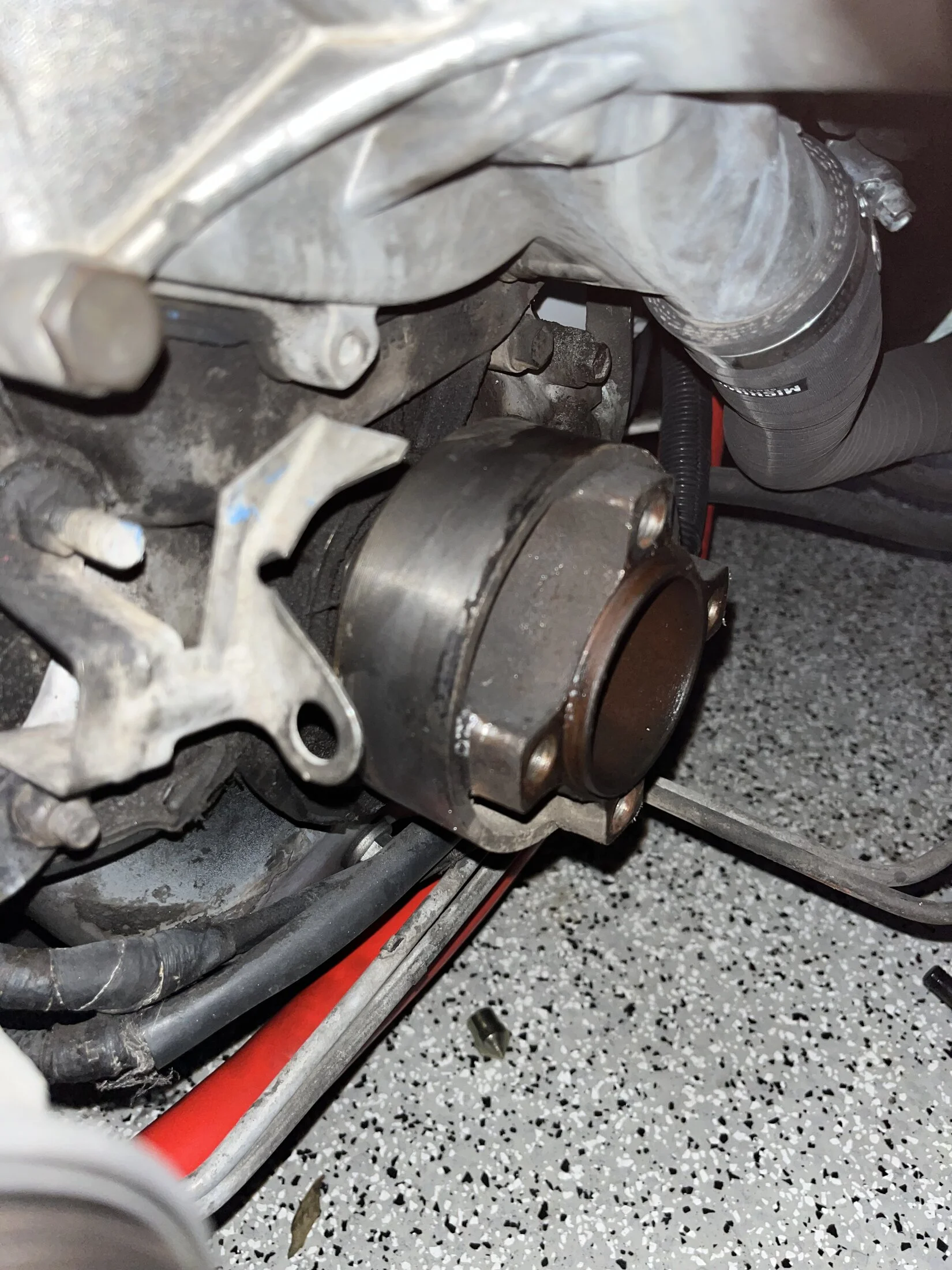

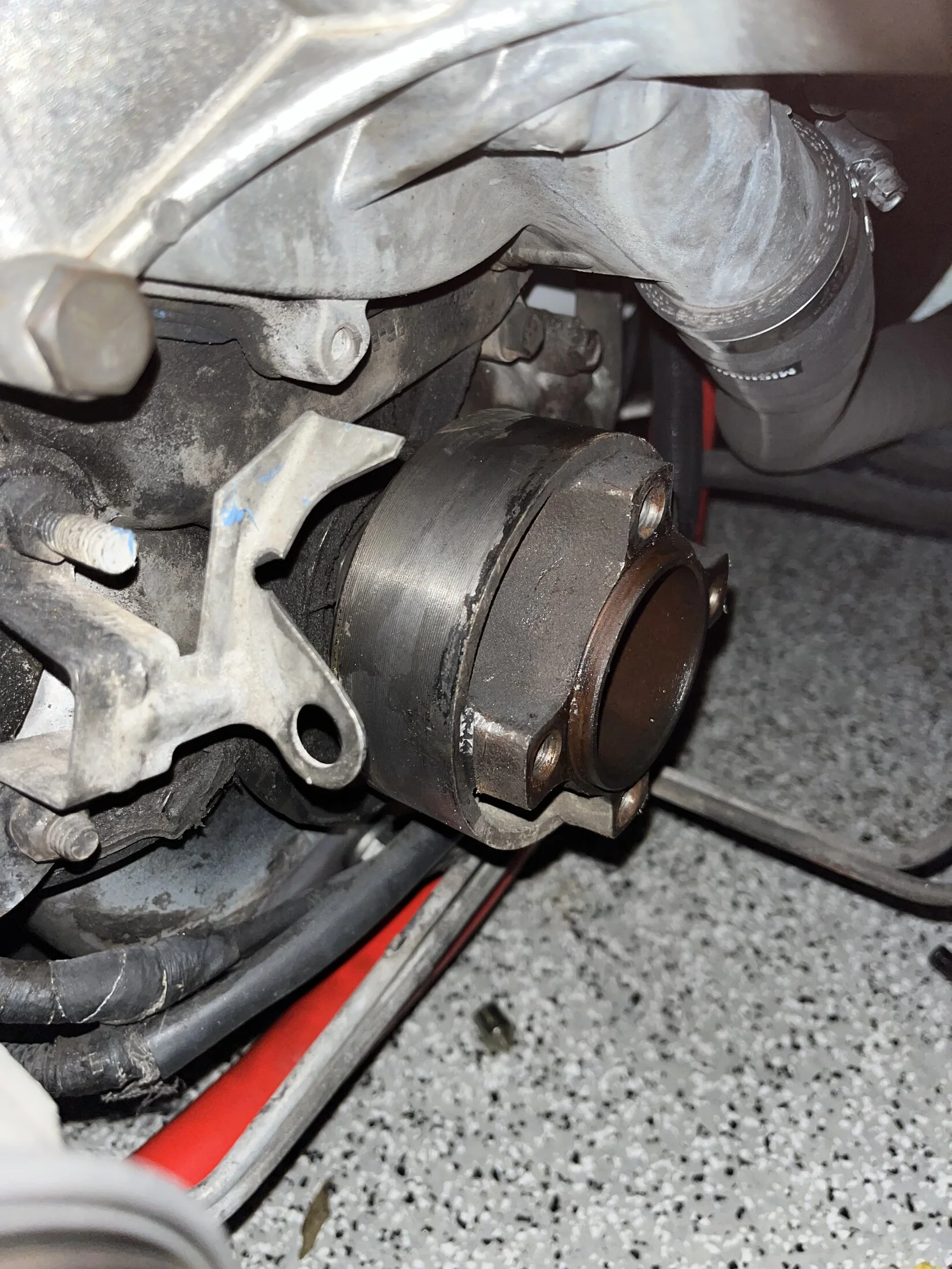

Hi All,
I’m replacing the harmonic balancer on my Fox n having issues removing it. How can I remove it? As you can see some of it already fell off. I posted a picture of the new one.
Thanks for your help again!!!

You need a puller.
Something like this: https://www.amazon.com/Professional...le-Mitsubishi/dp/B08FD1FQSC/ref=sr_1_5?sr=8-5
You local parts store may have one for loan, rent, and/or sale.
I rented one from O’Reilly. The middle bolt is tight as hell n can’t take it off. The crank turns as I try to take the bolt off. I used a pipe wrench to try to grab it but that didn’t work. I was avoiding to take the radiator off but looks like that’s going to be the option. Can I use an impact gun to remove the enter bolt? I have one from Harbor Freight that has forward n Reverse only.
Pick a spark plug that is easily accessible, shove some rope inside the cylinder, don't need a lot, turn the engine by hand till it stops, use a breaker bar to loosen the nut.
Is this a stick stang :rlaugh:? Just put it in high gear, chock the tires.
