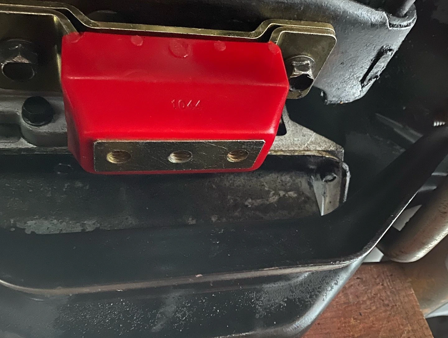

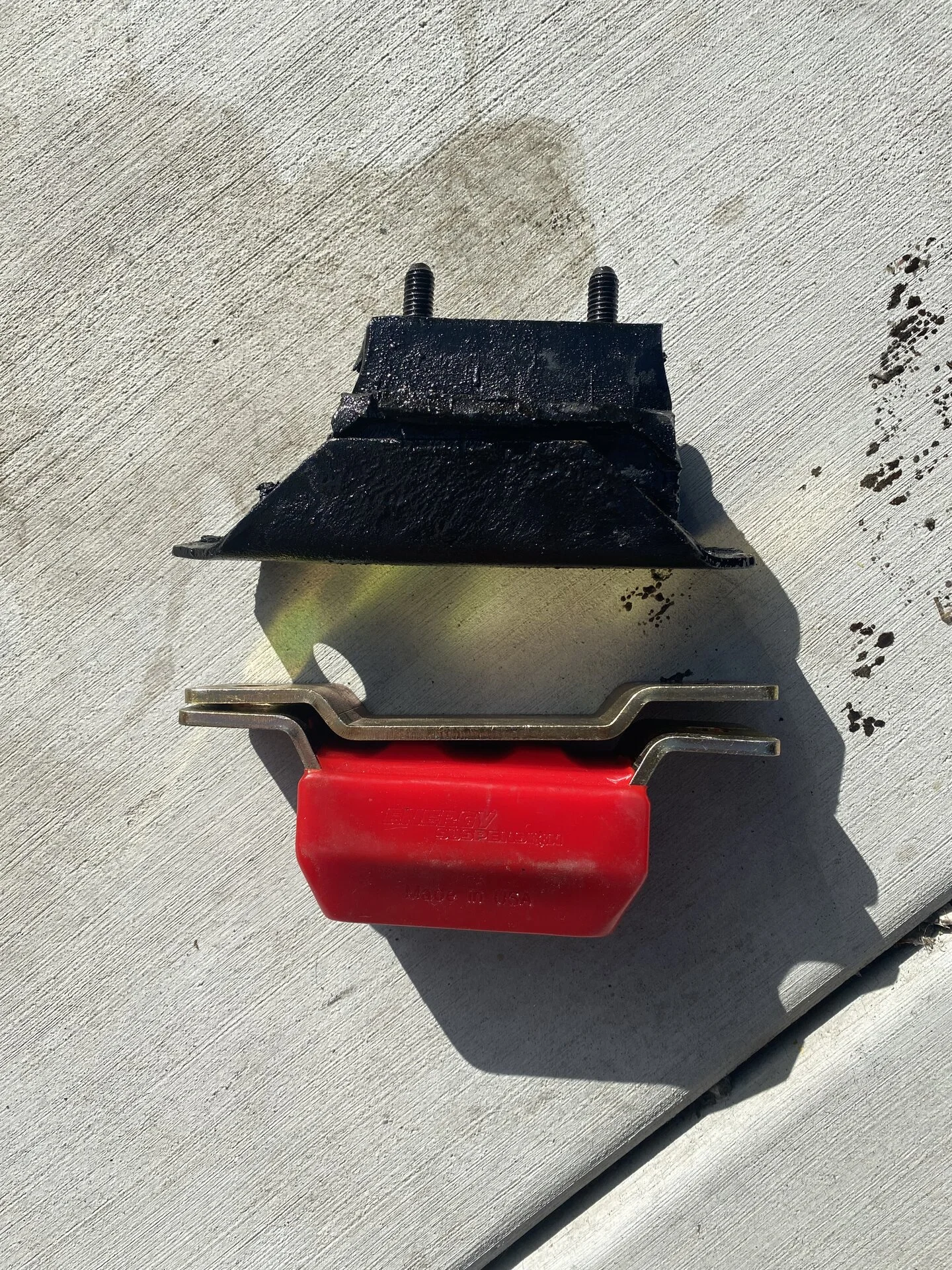

I was finally able to get it off!

Nice work! Nice trans mount. Looks like the energy suspension mounts I used for the engine and trans.
I should of read the instructions. I don't know how is a novice supposed to file the holes for the two screws when that transmission cross member is freaking steel
I used a Dremel to make the holes bigger. Put on some safety glasses and gloves and began to Dremel away.
Reactions: Gs1987GT
Yes, I had to enlarge the holes in the cross member as well when I installed the energy suspension trans mount
