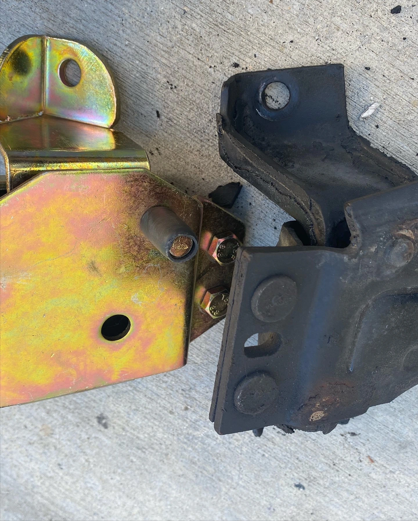

Hi All,

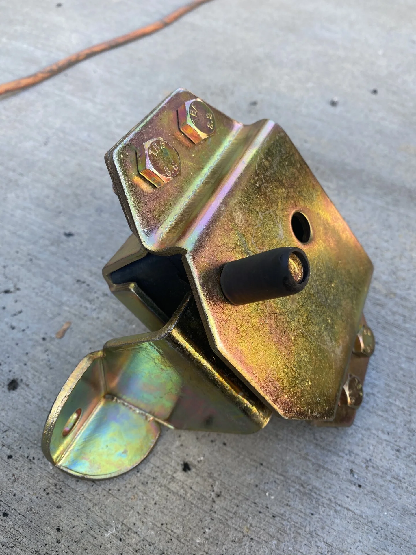

my motor mounts on my 1991 Mustang LX 5.0 convertible are really in need of replacing. So I bought some poly ones from LMR.

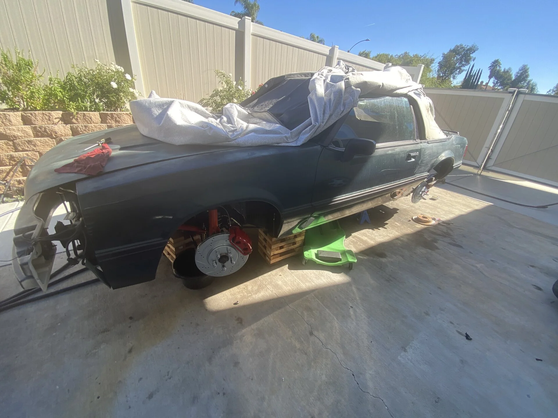

My question is where do I lift the engine up so I have enough clearance to remove n add?
I do not have an engine lift. The car sits on tire cribs.

Carefully position a few blocks of wood on the oil pan (not on the drain plug) and Jack from there carefully. That's what I did when I installed the energy suspension poly mounts on my car. It worked well, but be ready for a fight. The energy suspension mounts are physically larger than the stock rubber mounts and can be tricky getting them in and past everything.
Be very careful removing the mount bolts from the block. I snapped one off which became a nightmare. Good luck, hope all goes smoothly for you.

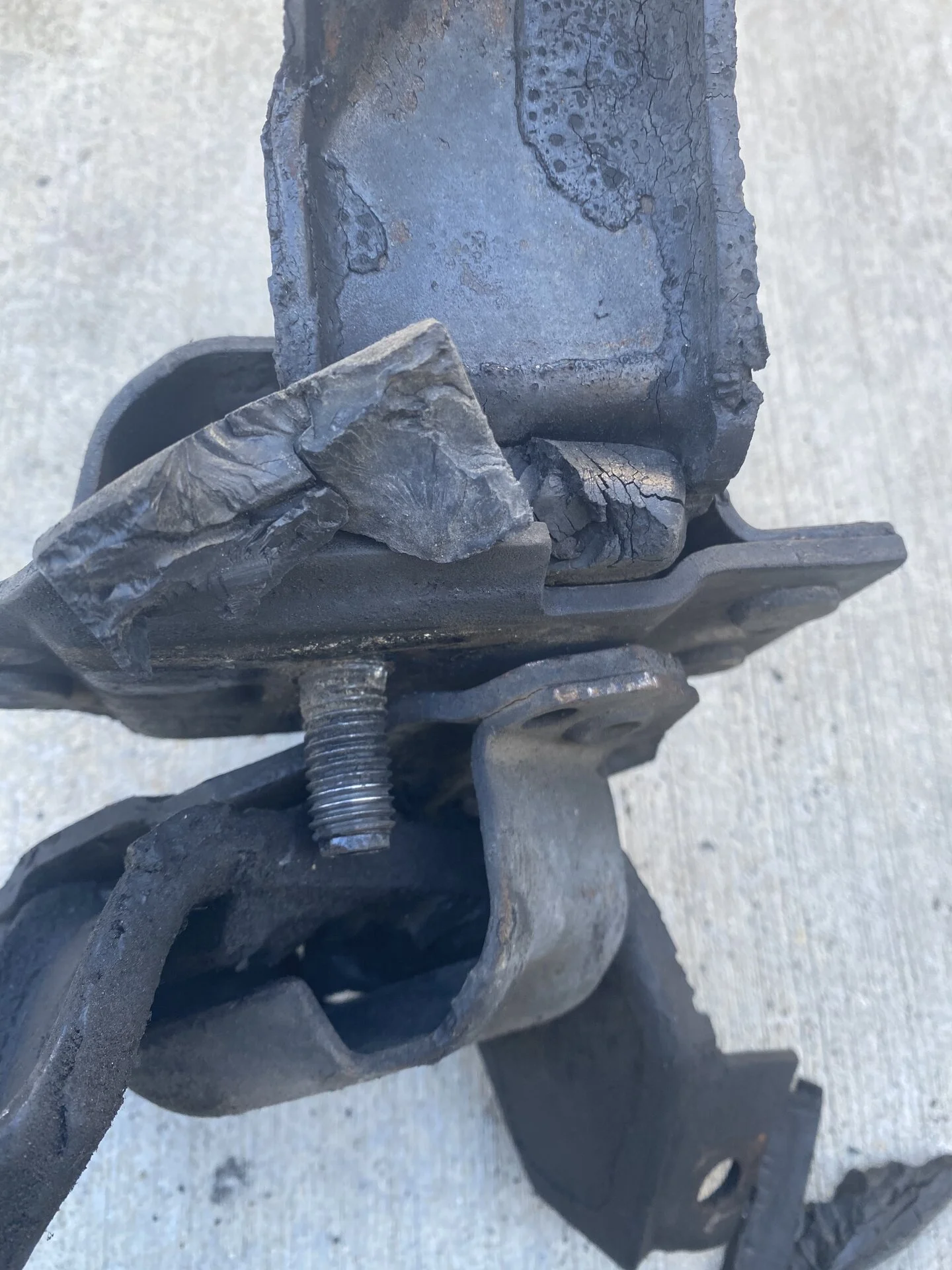

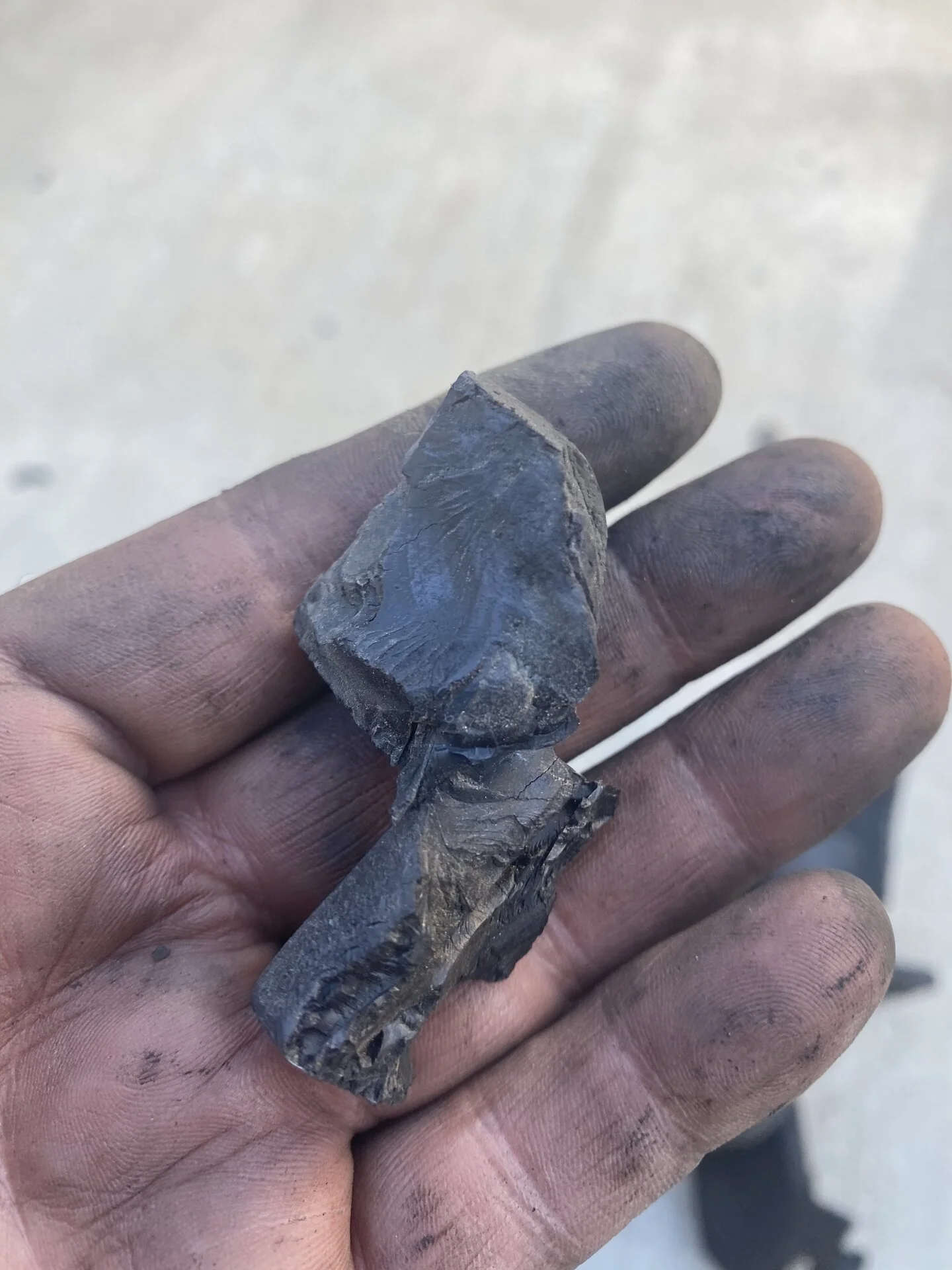

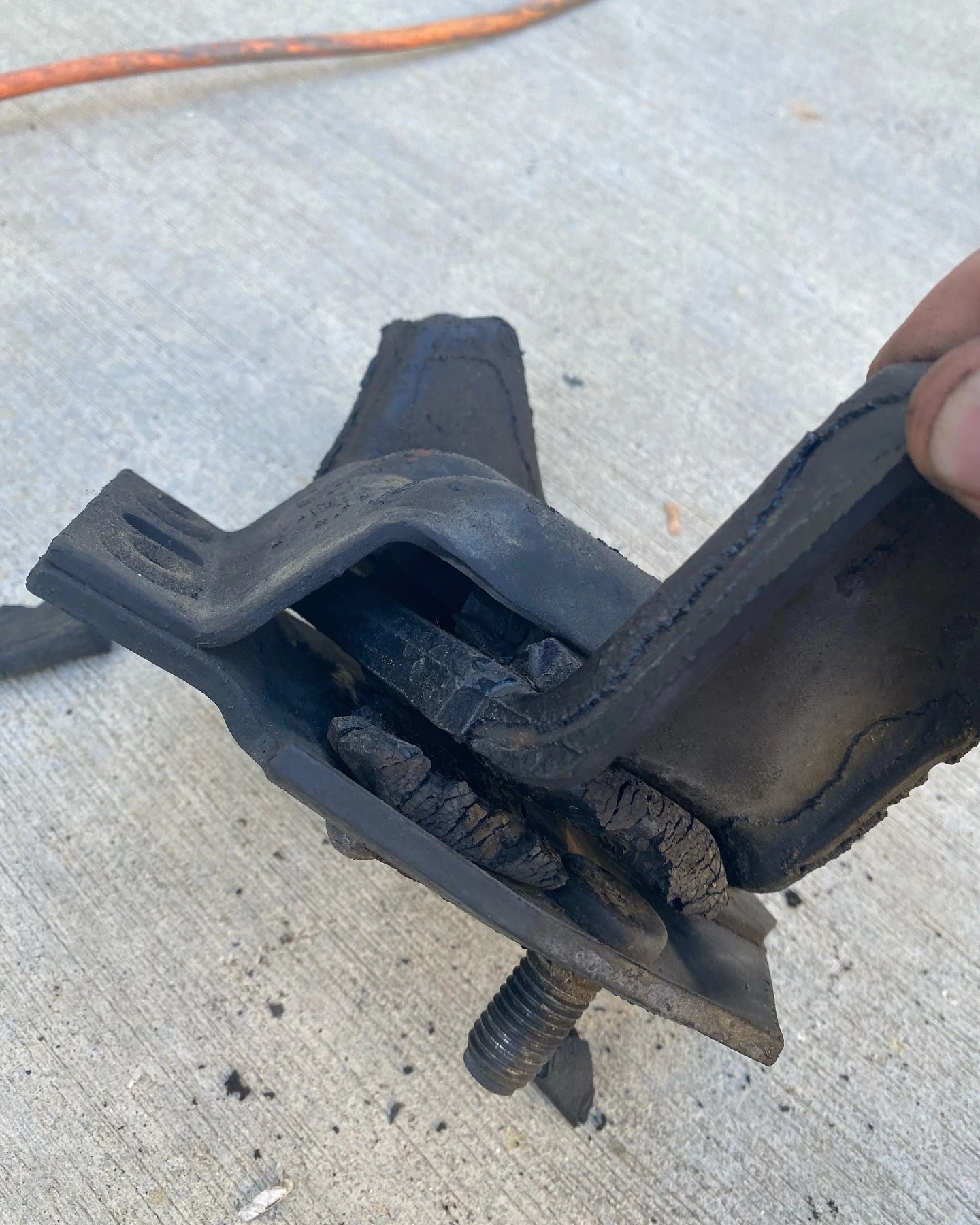

While removing the transmission mount the damn right/ passenger screw on the mount won’t budge.
I have been spraying WD40 for a week now n will attempt to remove it to day.
I’ve heard that heating up the bolt for 30sec with a torch will work. Is this true?
Is there anything that can be damaged if I heat that screw up?

Blueinfan,
Absolutely
Back and forth with heat and cold
I get it cherry red where I can and then hit it with something cold like Freeze off
Jaguar Fulcrum bolts freeze up and that is the only way
Those new induction heat gizmos are killer and one of them will be in my toolbox soon
