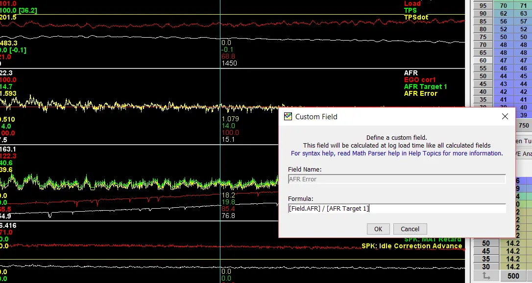

Custom error field in TS.
see the AFR error line in the log, the number in that field is what you would multiply the VE table value by.

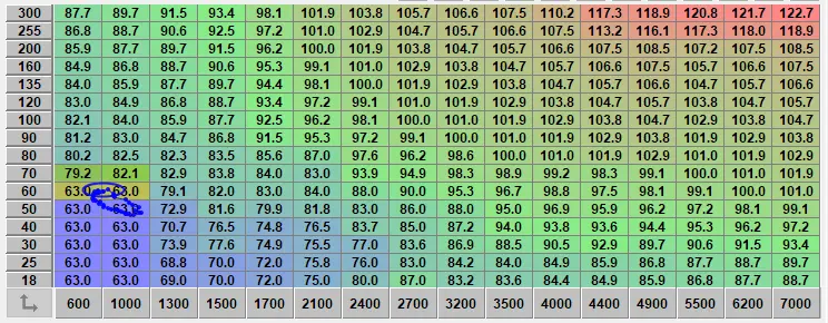

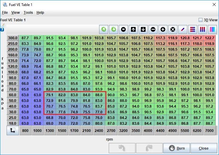

Couple issues I see just by a quick 5 minute look in MegaLogViewer.
Below is your VE Table in MegaLogviewer. As you can see you are hitting the MAP reading of row 70, which is a HUGE jump in VE then it is in your row 60. This needs to be closer together at say 65 for both 600 and 1000 RPM columns and then you can blend vertically to your 300 row for those 2 columns. I would also change the 1st RPM column to 800 over the current 600 getting it closer to your Closed Loop Target RPM. This should help with the fuel surging getting the RPM's +\- 100 RPM's from your AFR Target and the VE values closer not giving large swings of fuel. This will most likely need to be tweaked as you get this dialed in more.
Second issue is the Spark Table that your spark changes in your idle range as well, which makes for a very unstable idle as well. I recommend changing the second column of RPM from 886 to 1000 and making the timing the same as the 850 RPM column. Then update the next 3 columns to 1200, 1400, and 1600 making it 850, 1000, 1200, 1400, 1600.
The goal you are trying to do is make everything as stable as possible for air, fuel, and spark. If any or all of these are not level then you get constant surging.

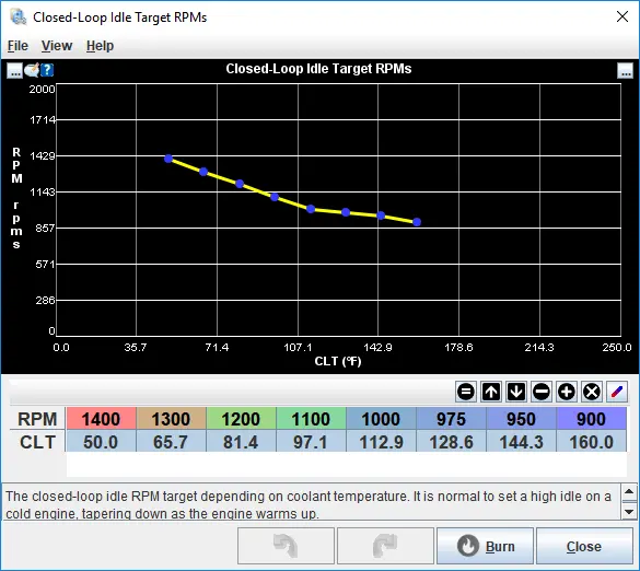

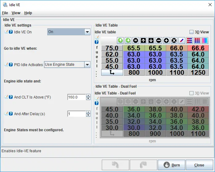

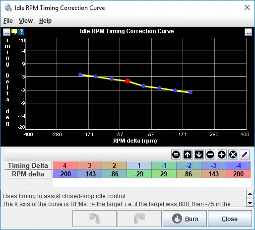

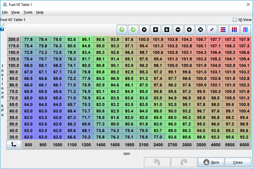

Thanks for the input guys. Here's some tweaks I made based on your suggestions and some chatting between Steve and me and have also attached the new tune file.
I adjusted the VE table to make the jump between 60 and 70 less drastic and then smoothed vertically for the 800 (changed from 600) and 1000 rpm column:
I'm a little concerned about the jump between the 1000 and 1300 column now though since it seems similarly drastic to the one I fixed based on @stanglx2002 suggestions. There are more big jumps as the RPMs increase too (plus some jumps in the red rectangle area) so curious what you guys think I should do about that?

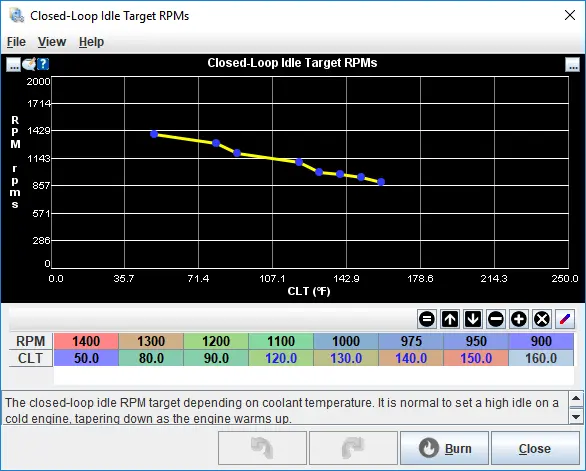

I adjusted the Closed Loop Idle Target RPM coolant values to have the final temp value at 160 instead of 140. I then adjusted the cells moving from there to the left to decrease from 160:
I made the Idle RPM Timing Correction Curve less drastic, going from 4 to -4 in 1 degree increments. I didn't change the RPM delta values at all:

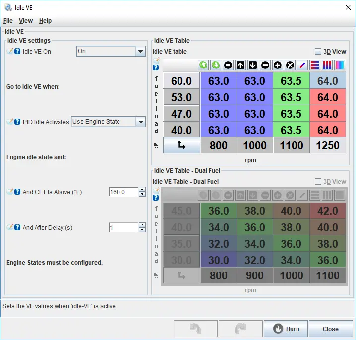

Finally, I enabled Idle VE, set the coolant temp to use it at 160, and changed the VE values to closely match my main table's idle range values:

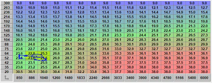

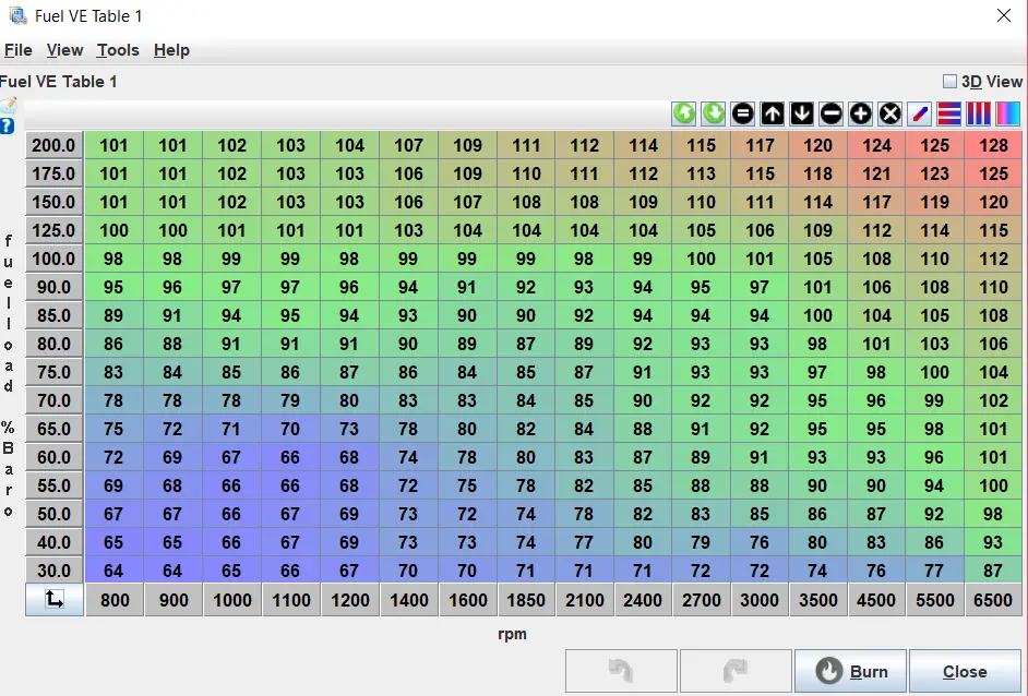

IMO your load value in the fuel table is really high.... you can lower it unless you plan on running more than 15psi. 300kpa is 30psi.....
MS3 has so much more table resolution you should take advantage of it and shift some of the columns to the left, you will want more columns between the idle and cruise ranges [below 3k rpm] and above that you only need one every 500 -1000 rpm you spend very little time above 3k rpm and when you do it is mostly wot anyway.
this is how i have mine in MS2
notice how heavily i filled the bottom of the rpm map, this car was driven daily before i decided to rebuild. It worked out well for me to have a column every 100rpm in the idle range to keep fuel right where the car wanted it, with the blower intake fuel reversion was a serious problem this helped significantly.
smooth smooth smooth its more important to have smooth number transitions than it is to be spot on the AFR target. being .1 AFR off isnt even noticeable

@a91what will add/correct my advice to my comments below...
VE Table
- I recommended smaller jumps in the lower RPM's and then larger in the higher RPM's
- What is your cruising RPM range? (ie: mine is 1500-2000 RPM's) so I set a 200 RPM difference from idle through cruising, which gives good resolution in low MAP & AFR and high Timing to combat bucking. You then progressively increase the RPM's in a linear fashion.
- Im OCD so I would have to blend the CLT to make that curve smoother
- Big jump from 120 to 130 CLT of 100 RPM
- Make it easy on yourself and highlight the whole row of CLT and blend
- I give a +\- 50 RPM delta before timing correction buts that's just me
- You also have more resolution with MS3 then I do
- Stock cams you could get away with 2-3 degrees timing from 50 to 100 RPM delta but need more with choppier cams say 4-6*
Idle VE
- I would set the MAP +\- 10 from your idle MAP reading, meaning if you idle at 60 then your MAP would be 70, 63, 57, 50.
- I keep the smaller resolution in the middle where you want idle to be, also giving good resolution too
- Set your 800 and 1000 RPM VE values all the same currently until you get a stable idle, which you can then adjust to make AFR target and AFR match
- I always try to make everything as linear as possible until I get a stable idle then adjust. If you don't then it makes it harder for you to figure out what is making it unstable
- I always tune in warm-up mode first then enable CL after I can get a mostly stable idle, but I do things differently than others

Hey guys, I've made some changes based on your suggestions and wanted to share the new tune and some of the changes I made to see what you think.
I'm planning on getting over to the shop after work today to put the fender liners back in and the interior back together. I definitely plan on doing some more idle tuning too and maybe some driving tuning but wanted to shoot you over these changes first to see if there's any more dialing in we can do before I go there tonight.
I don't have any plans to run 15psi, the WG spring is 7psi and I figure I'll just run that for now.
Since I don't really know exactly what my cruising range is (haven't hit 5th gear yet in my short drives) I went ahead and used your RPM and MAP settings since we have a similar motor/cam setup. I hope you don't mind me plagiarizing that My rear end gear is 3.08 and 5th gear is 0.63 if that helps at all to estimate...
stanglx2002 said:
VE Table
Do you think my table above looks decent enough, or are the jumps still bigger than I should have?
Another question I thought of is do I now need to adjust my AFR and Ignition tables MAP and RPM values to match the VE changes? The Ignition table is 16x16 like the VE table, but AFR is 12x12. I haven't touched them as of right now but guessing I'll at least need to adjust for the change from 300 to 200 kPA. The upper RPM limits are also different...
I went ahead and blended the CLT row like you suggested:
I left this alone for now, since I'm not really sure what they should be set to. Are you saying to have the two "middle" columns set to 0 timing and +/- 50 RPM and then go up from there?
stanglx2002 said:
Idle VE
Looking at my most recent log, the car seems to idle with a MAP around 50 so I set the idle VE range like you suggested and made the cells the same for 800 and 1000 rpm:
Does that look good? Just to make sure I understand, I'll do my Idle VE changes here now rather than using the main VE table? Like, once it's warm I should be trying to change these cells to get it to idle at the 13.8 AFR in the AFR table?
