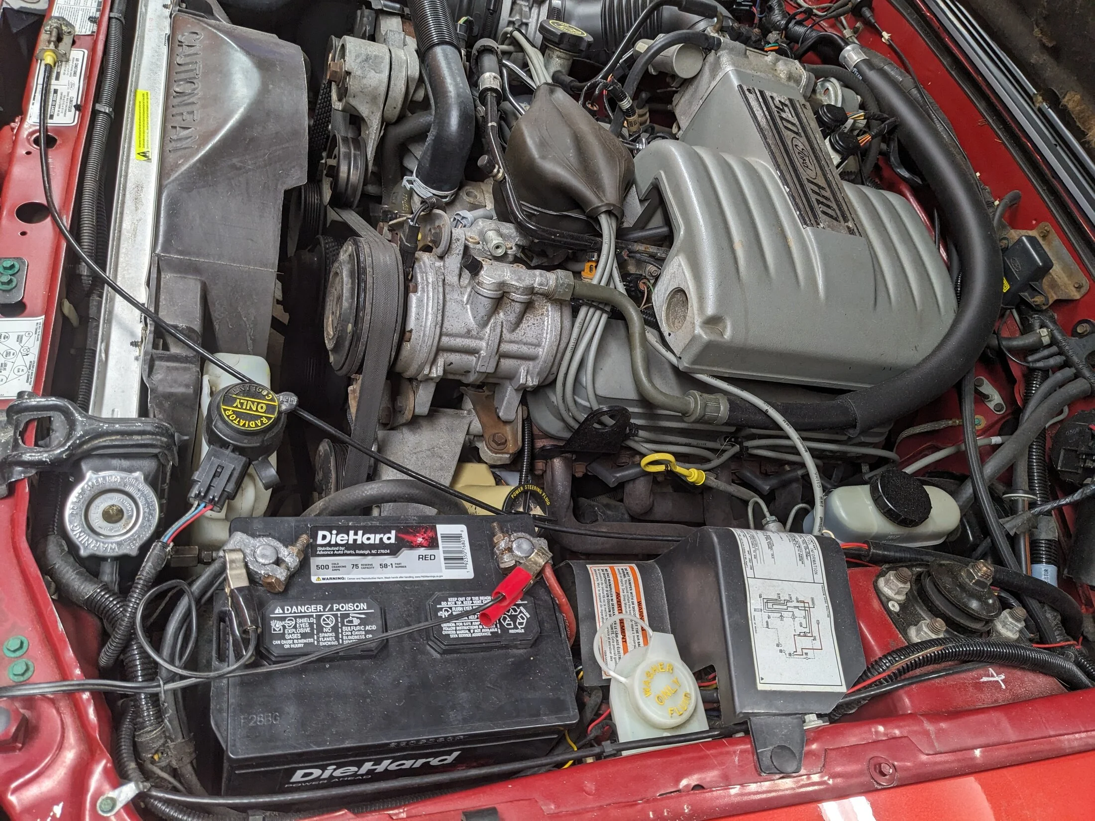

Tried it in park and neutral. Terminals are clean and making good contact. Batt. reads good on my tester and the voltage reads 13.3 volts...
