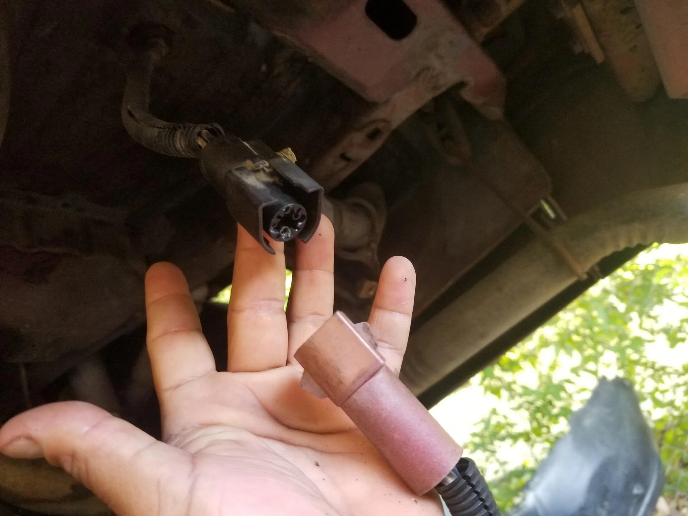

I began going down the rabbit hole of figuring out fuel delivery issues. The relay under the driver seat clicks, inertia switch passed its test. I’m getting 12v at orange/blue wire, 12v at red/black, 12v at tan/green, and 1.46v at pink/black.
I know pink/black is the wire to supply power to the fuel pump. I tried to bypass the relay and connect the red/black to pink/black but had no luck.
