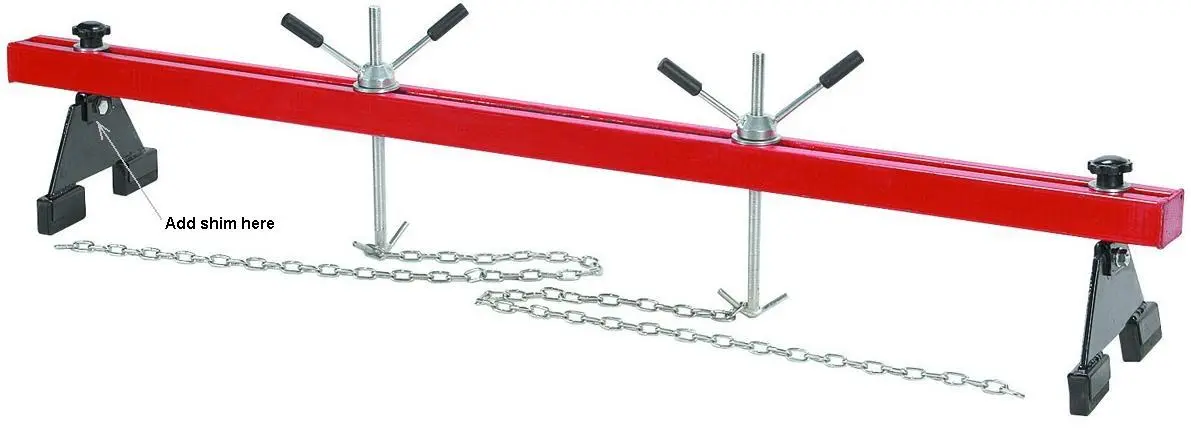

I got it done. So, I thought I'd run over the what I had to do to get it to happen. The engine has to be raised. To do that you need one of these. Add a shim to take up slack in both the hinges. It's cheap and it works fine.
