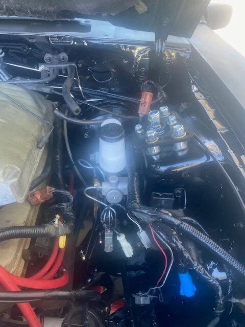

Hi All,
I updated my 1991 Ford Mustang LX Stock brake booster/ MC to a 1991 Cobra booster/ MC. I have upgraded the brake lines. Now the problem I have is is there a trick to connect the brake pedal to the booster from the inside? Can I connect the brake booster to the pedal from the inside after completely tightening the MC, and brake lines?

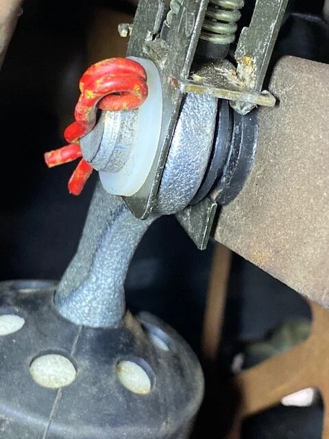

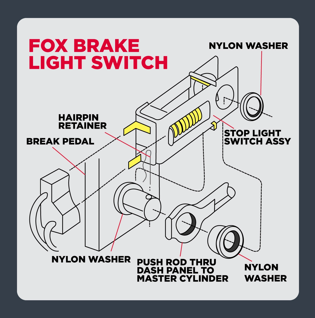

The challenge to the switch is getting the washers and clips in the right order and slipping everything together.

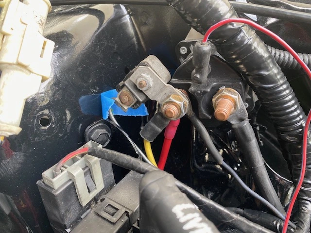

Here's the picture of the booster brake pedal and Solenoid.

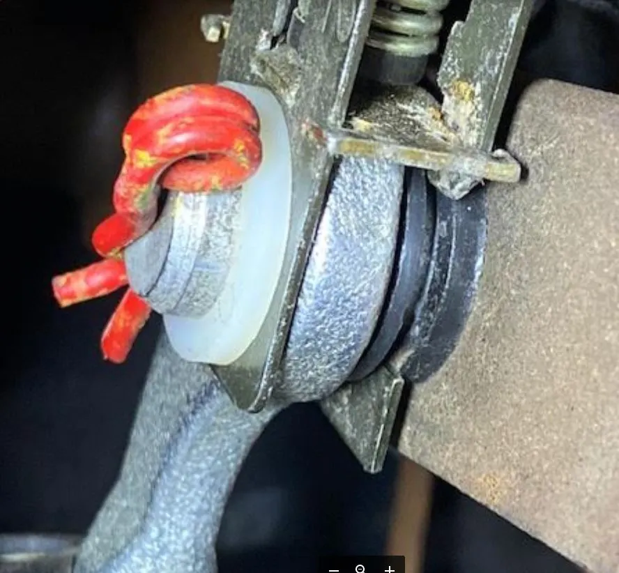

You were right, it was a challenge putting the washer and switch in order and i hope its right.
Order
