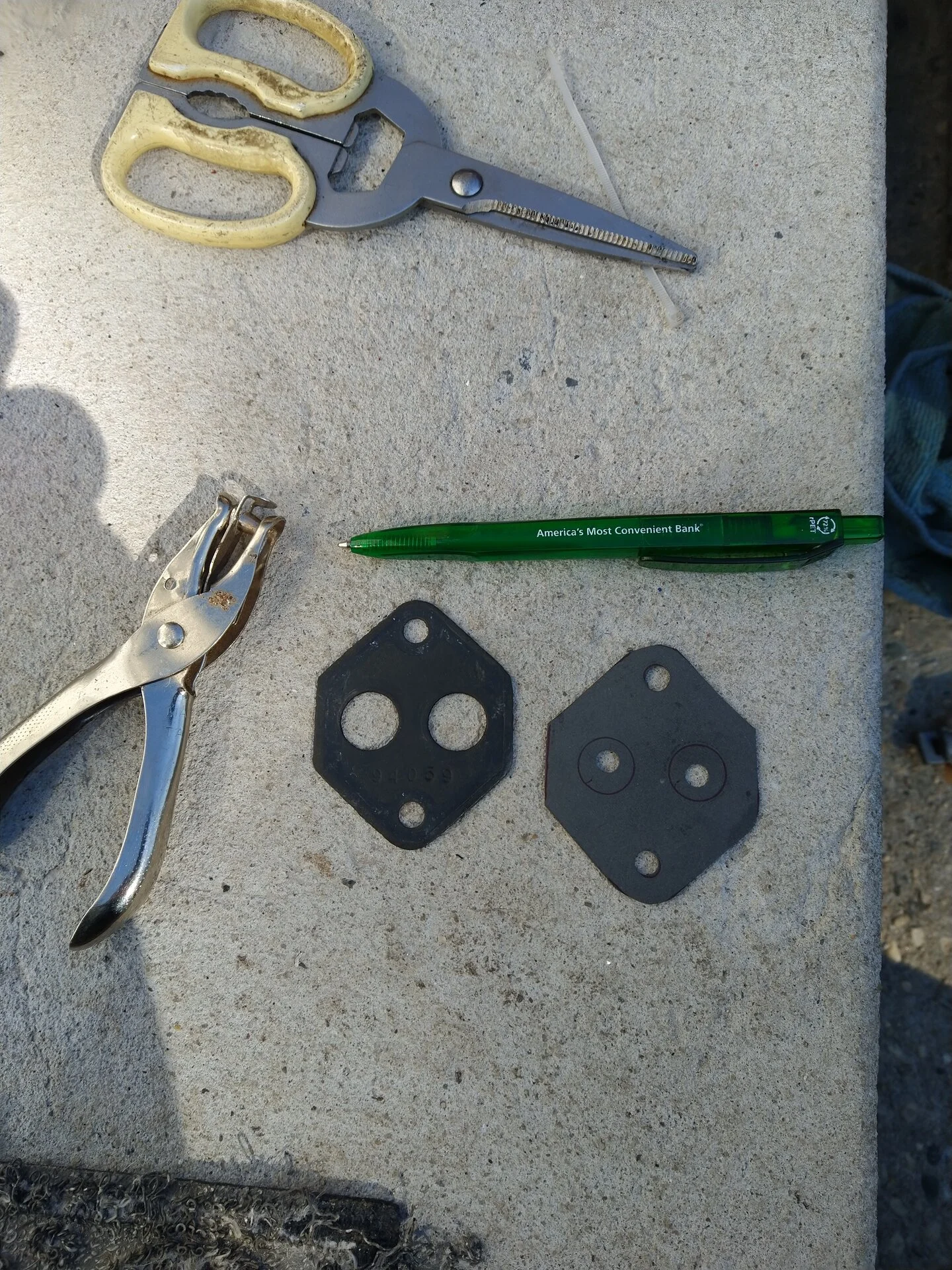

Another thing I want to touch upon is the IAC and modifying the intake air system whether adding a cold air intake and removing the hotwater line that heats up the throttlebody . By removing theheat you get cooler air which is denser so you dont need as much air to correct idle especially after youve just set the base idle...
If you still get idle fluxuations after doing the procedure you may have issues like a worn out throttlebody with massive leaks at the shaft ends ,vacuum leaks or you may need to do a timing check and reset the timing advance by disconnecting and reconnecting the spout connector.
Another thing that comes to mind is needing to replace your timingchain or servicing your fuel injectors.
But after doing everything known to the forum the next course of action is to reduce the air that the IAC flows and thats done by doing this simple thing,,,,
