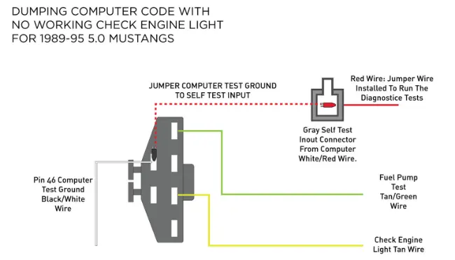

I wanted to jump the fuel pump in order to get it to run continuously with the ignition keyed on.
Thanks!
Find the test port connector behind the drivers strut tower. With key on, ground the tan/green wire and the fuel pump should run continuous
