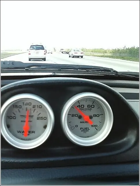

This is 100 degrees outside, 347 Stroker and on the freeway. My car never got over 200 ever. I also had the fan set to stay on HIGH all the time (key on).

And where did you get those red gauges from i wants some LOL.

My fan would work on and off, overheating at idle due to the short, I wiggled the plug and that's how i found it. Hope you get it straightened out. Here is a pic of them gauges, home made of course.
