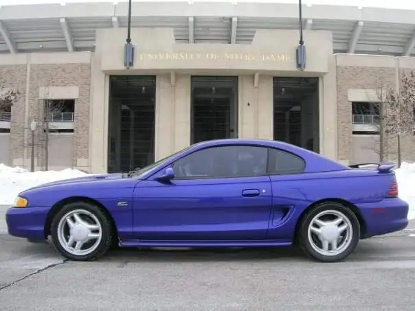

I have a set of stock bullit anthracite 17" wheels on my car 8" wide I believe , will a 255 50 r 17 fit on that rim and look good on the back , and a 245 45 17 on the front, will that work?

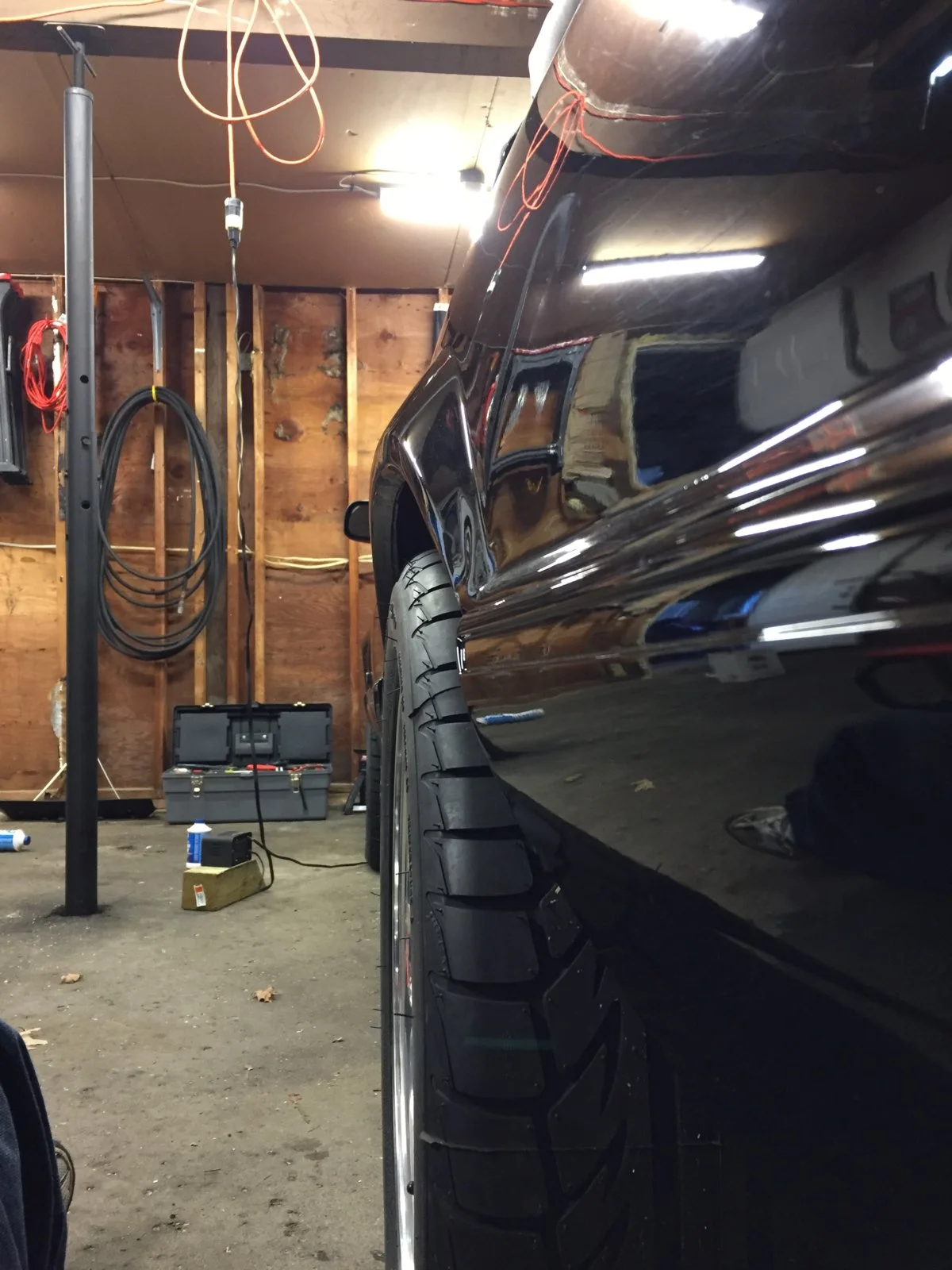

I had a 275 in the rear on the stock tribars (also 8" wide) on my '95. That filled the rear wheel wells decently until I upgraded to 10" rear aftermarket wheels. You wont notice much difference in look between 255s and 245s.
Found a picture of it. This was 245's up front, 275's in the back. They were drag radials, so the softer sidewall made it easier to squeeze them on the 8" wheel.
94-95 Cobras cane factory stock with 255/45/17s on the 17x8 wheels. Only sn95 with 17x8s to run that setup. All other 17x8 cars ran 245/45/17
I run 17x8s with 255/45/17 out bsck and it looks fine. Perfect amount of "meat" for the rim size

The 94/95 cars have a lot more room in the fender wells, and the factory wheels are sucked way further in than yours on your fox. For your setup, I think you nailed it. Your same set up on an SN95 would be inboard another inch or more.
