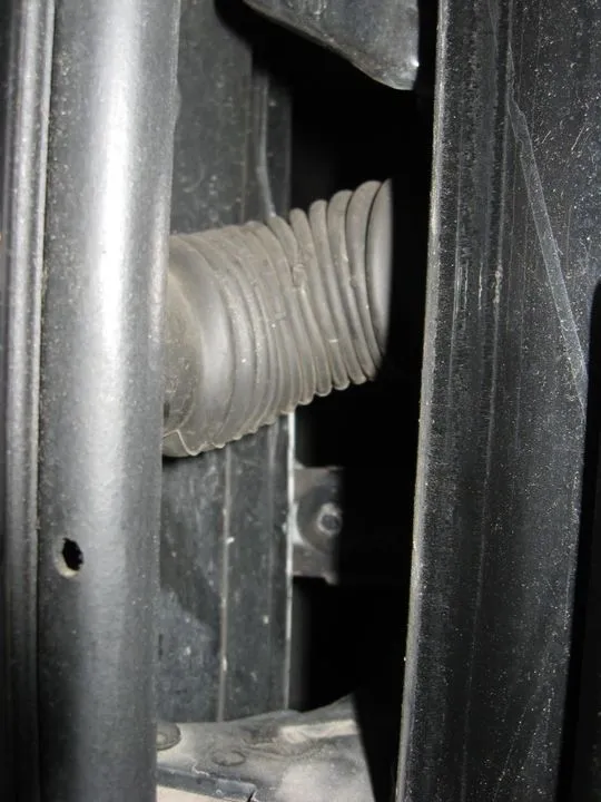

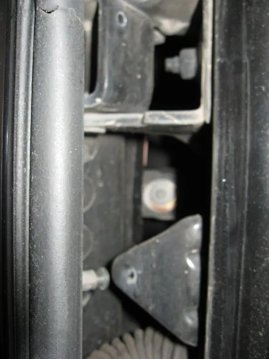

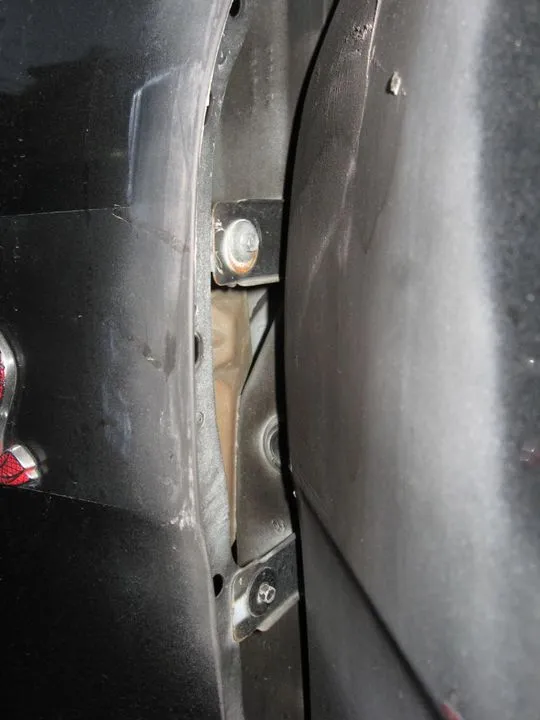

I decided to refresh my memory on these bolts, and took some pictures of the bolts on my driver's side fender. Yes bolts - I thought there was one, but there are two. As the phrase goes, a picture is worth a thousand words - so have a few thousand words. First pic is from the outside, with the door open. Don't mind the bondo. Your bolts could be facing the other way, depending how they were installed. If they are, you're going to have to take off the fender liner to get at them.
Next two photos are from inside the car, shots of the bolts through the door hings. The camera didn't focus well on the bolt, but it's dead center with the rust ring at the bottom.
And the last photo, you can just see it towards the bottom of the pic,
