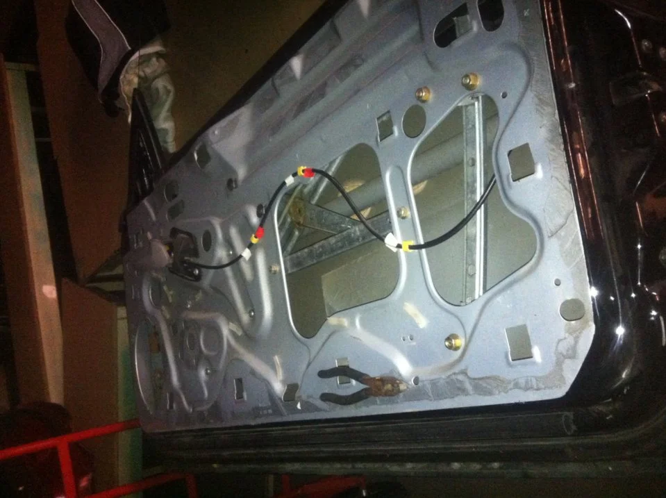

Hey I'm doing a manual to power on my 94 3.8L and was wondering what all you had to do to get the power motor for the window and power lock into the manual door ? I have all the wireing and switches and both the manual door and the old bent power door
