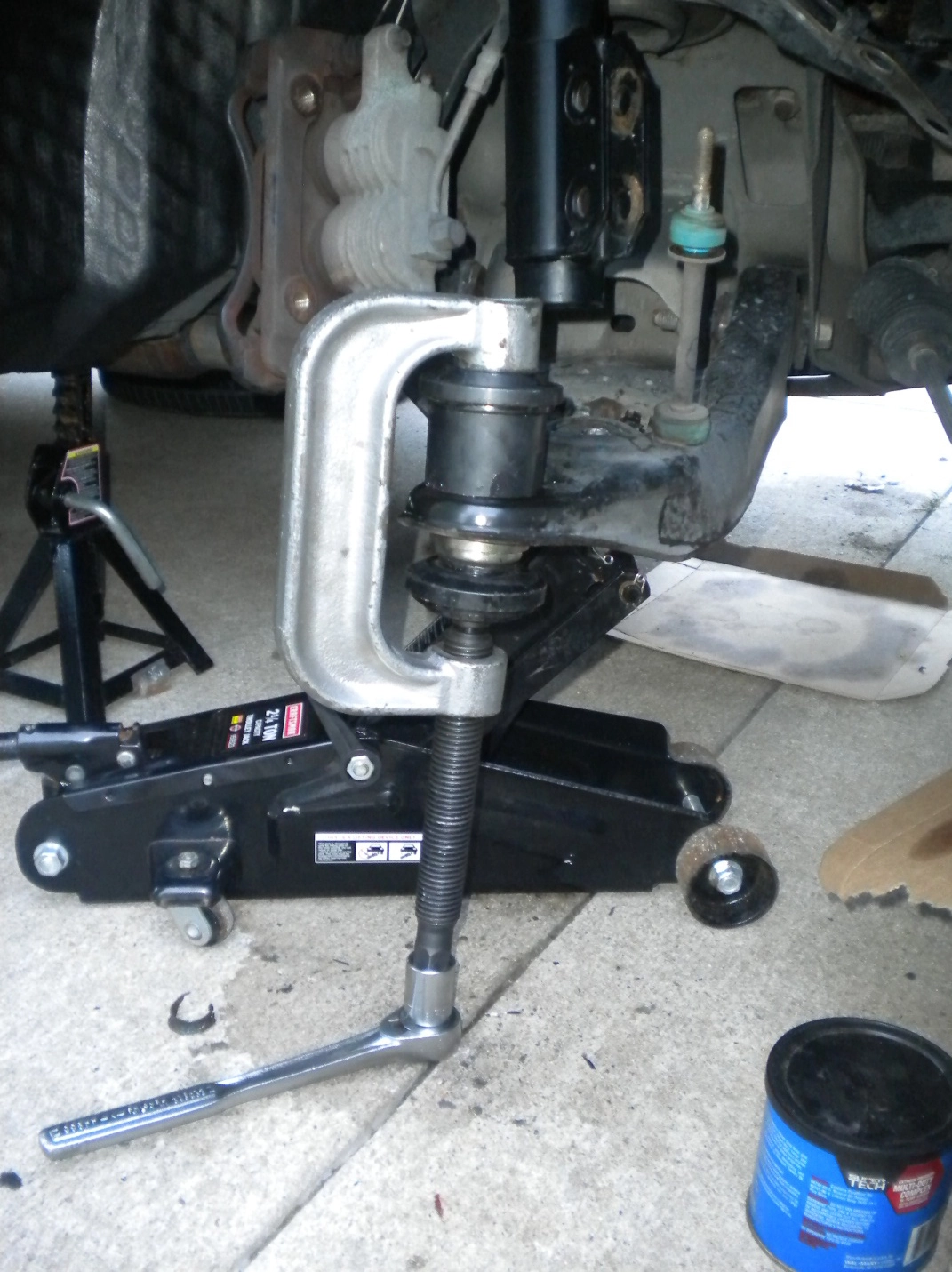

The not so basic tools would be a master balljoint kit and preferably an impact gun,and an inner tier of tool
Master balljoint kit

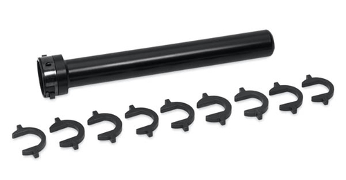

Tie rod tool

Ball joint just knock out with a hammer, is easier with the ball joint press but again I usually don't use it, takes longer.
