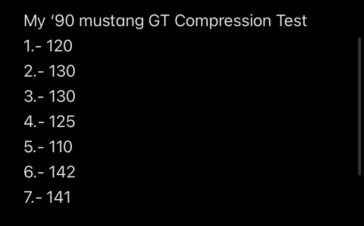

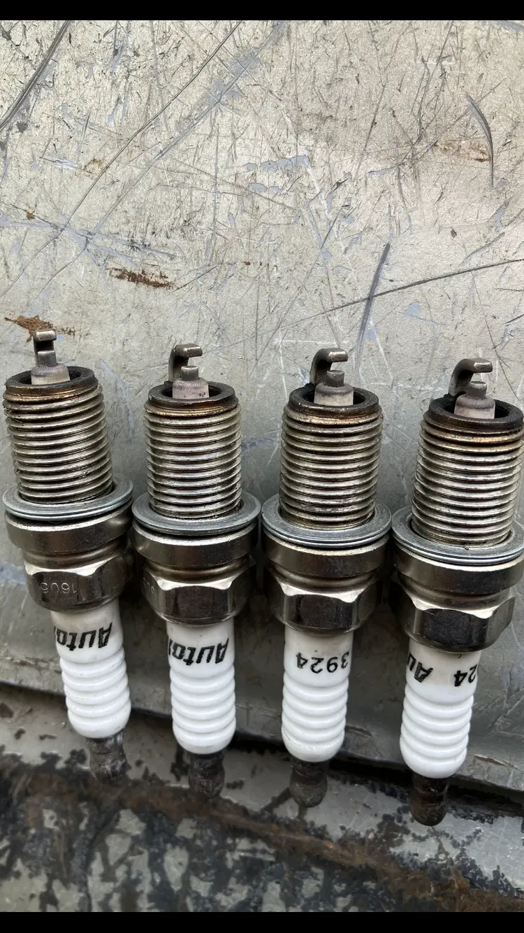

General karthief said:
Have you done a compression test recently?
Yes here are the results and how my plugs look de other 4 look the same…
General karthief
20+ Year Stangneter
Aug 25, 2016
27,959
10,600
203
polk county florida
Jul 25, 2024
#144
  • Jul 25, 2024
  • #144
Those numbers are not great but not terrible
PonyGTrider
5 Year Member
Feb 27, 2019
625
110
63
Mexico
Jul 25, 2024
#145
  • Jul 25, 2024
  • #145
I agree they don't look too bad neither the plugs. So why is half of my fuel dissapearing??? That's a real mistery
