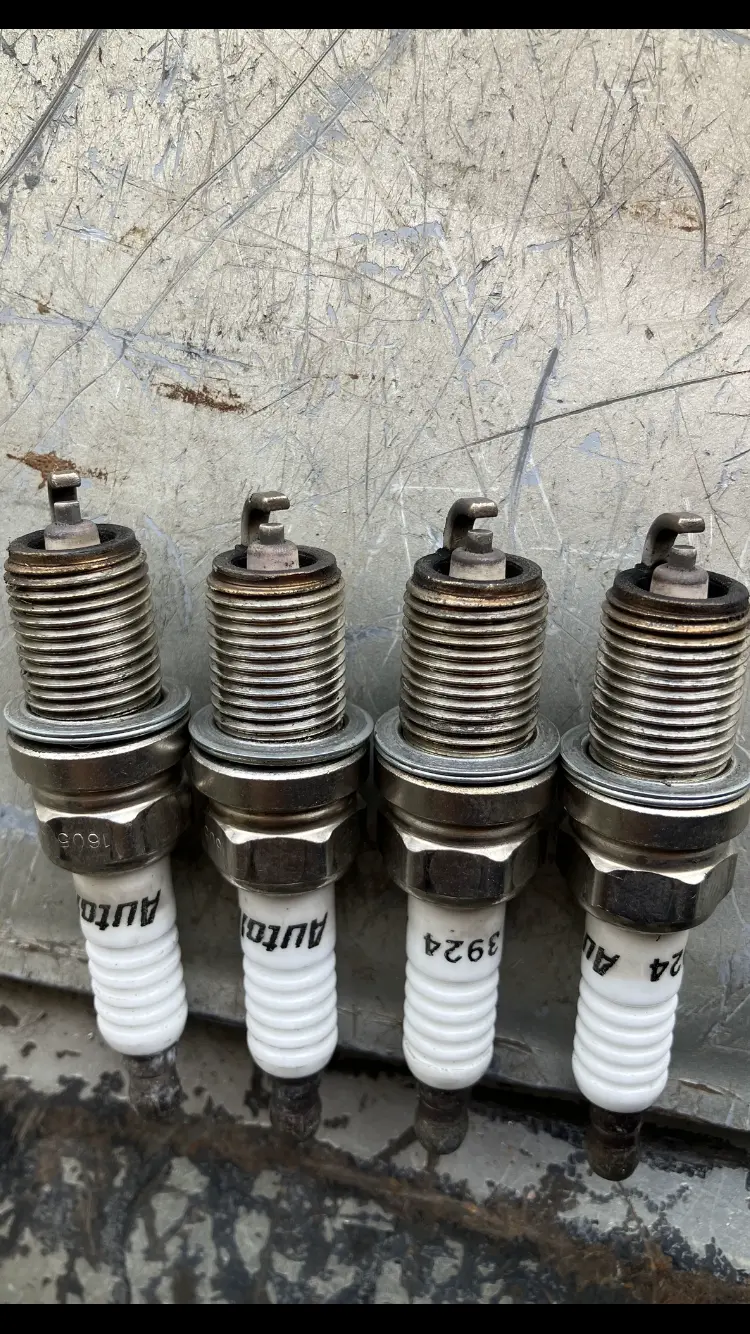

What do your plugs look like?

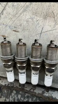

I haven’t seen any misfire at all, and with that much suggested misfire I would expect to see really black plugs but they are not. The ones from the other bank look the same

Those look pretty good.
Is it the same on the other side?
Maybe take your foot out of the radiator? :O_o:
Yep they look the same so I they domt show any misfire as far as my concern.
