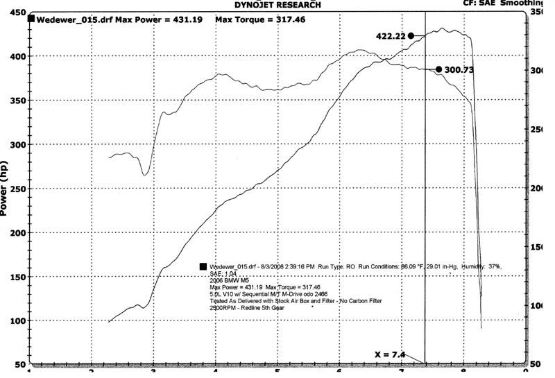

Actually most of them are running CR's of 10:1 or higher and indeed they require premium fuel to get maximum performance. With knock sensor timing retard the performance of most, if not all of those vehicles, would be degraded if they used lower octane fuel.
A good case in point is the new BMW M5; 5.0L V10, 500hp@7750rpm, 368lbft@6100rpm, redline 8250rpm, 12.0:1 CR.
Same displacement as our 5.0 engines, but maximum torque comes in at higher rpm than our engines make maximum HP.
