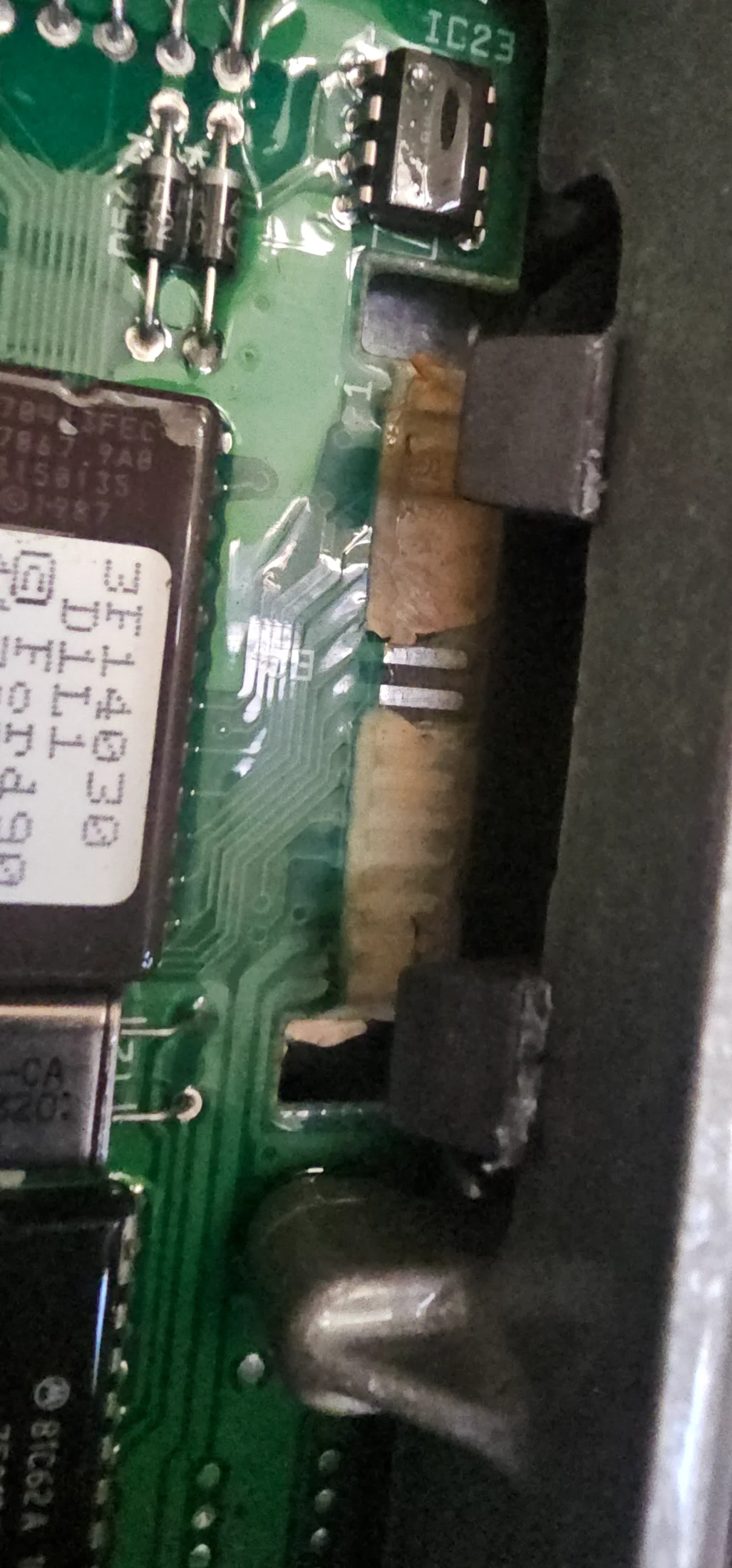

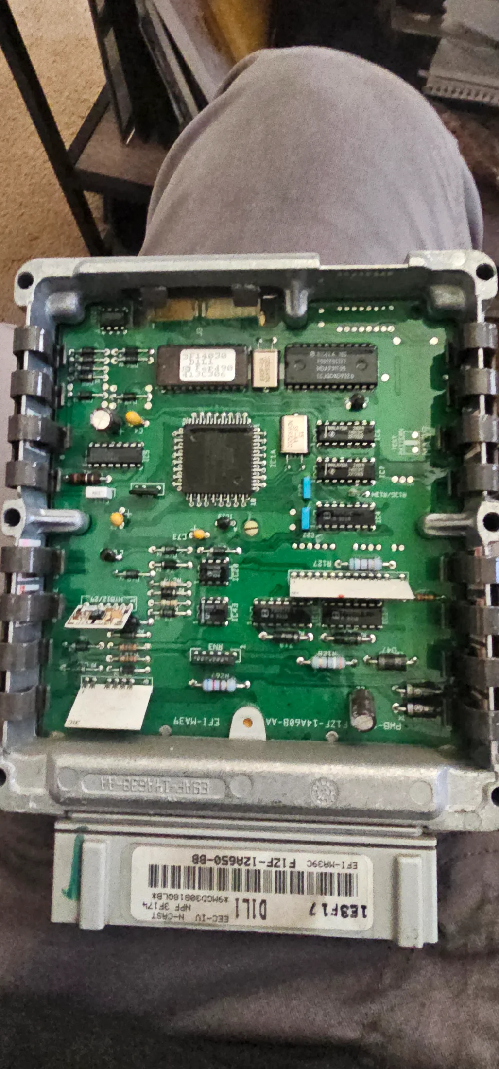

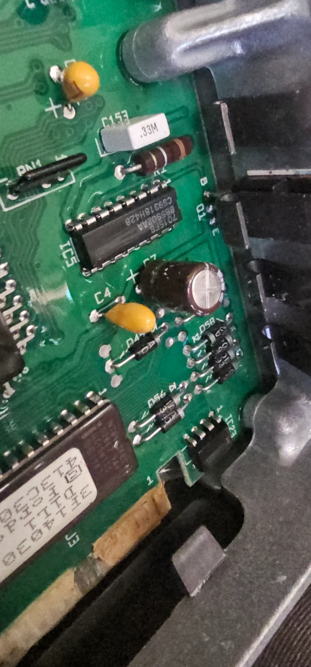

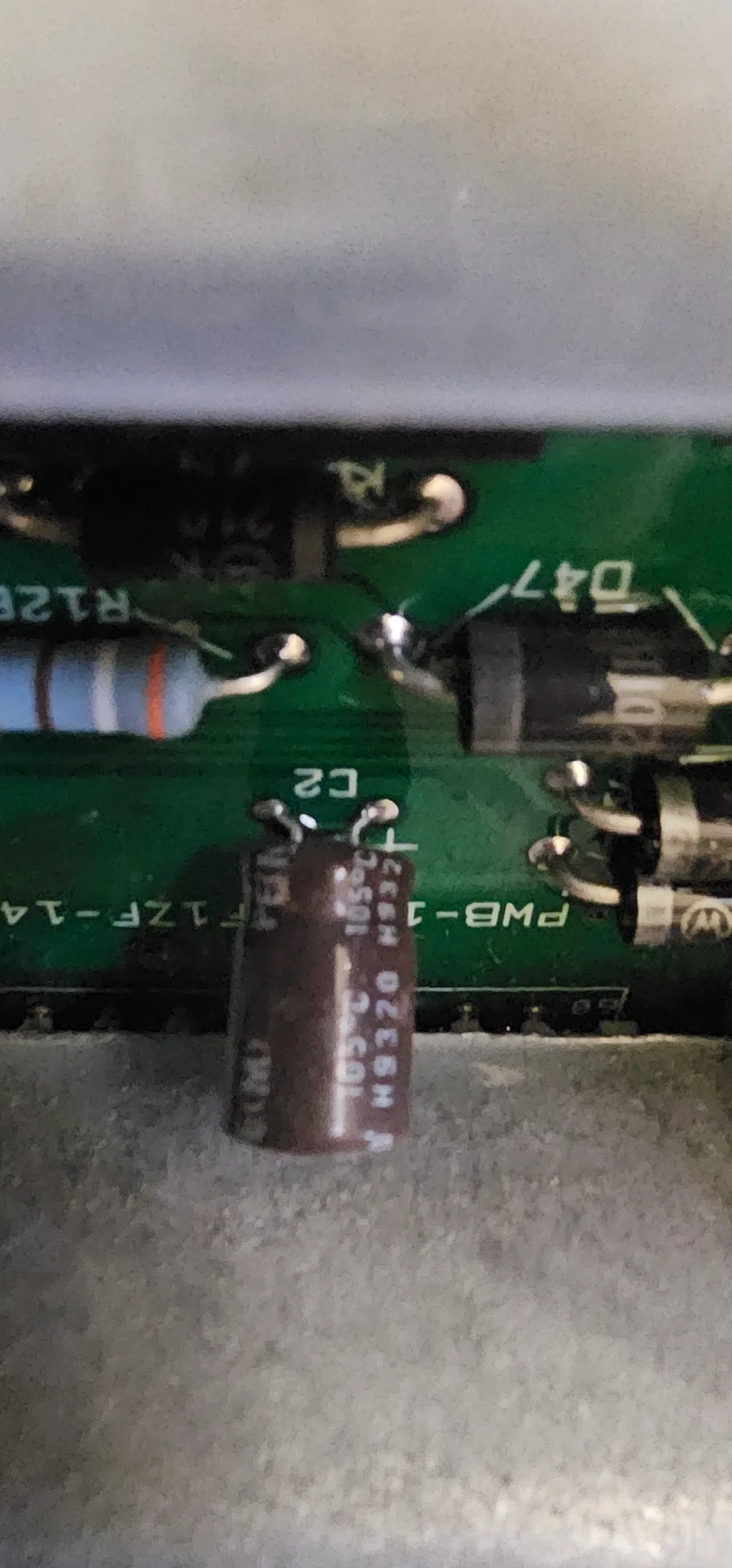

Removed the old ecu and opened it up im no profession but I know a little of what I'm doing and all the capacitors visually look okay doesn't mean they are good but they aren't corroded atleast

Removed the old ecu and opened it up im no profession but I know a little of what I'm doing and all the capacitors visually look okay doesn't mean they are good but they aren't corroded atleast there is one spot of concern which is the last picture unsure if that is corrosion or a factory coating though
