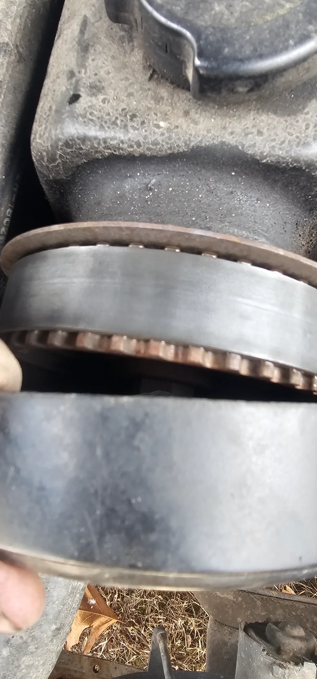

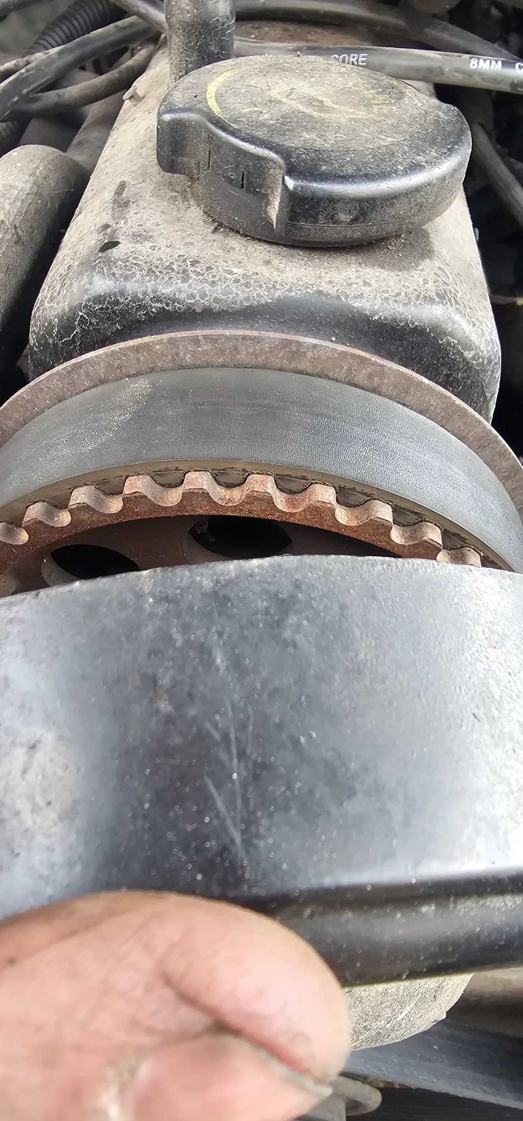

I've started taking off the timing cover it's a lot easier than it looks in the videos I watch i think mainly because they were on Rangers and there's a bit more to remove i haven't pulled the harmonic balancer but I removed the cover enough ti see the belt I will probably replace it when I have time to pull that balancer off and do the crank position sensor as well

I will say though it went from starting and idling fine to not starting at all over the course of sitting for an hour do you all think the timing belt could've failed like that all the other symptoms seem to be related to timing but it feels like it went from running a little rough to nothing rather quickly I guess if it skipped a bunch of teeth while starting that could explain the issues but even after I got it to start and run once just stalled once rpms dropped to idle
When the belt slipped on my 85 Turbo Coupe it was instantaneous loss of power but it still ran. I just brought it up as they have been knows to slip multiple teeth and cause all kinds of issues. With that said I am still leaning towards is the crank sensor failing as it is a hall effect sensor just like the PIP in the distributor on the 5.0's as well as the 90 and down 4 cylinders. Again, this could just be ferrous materials on the sensor (its a magnet) or the sensor itself has failed.
