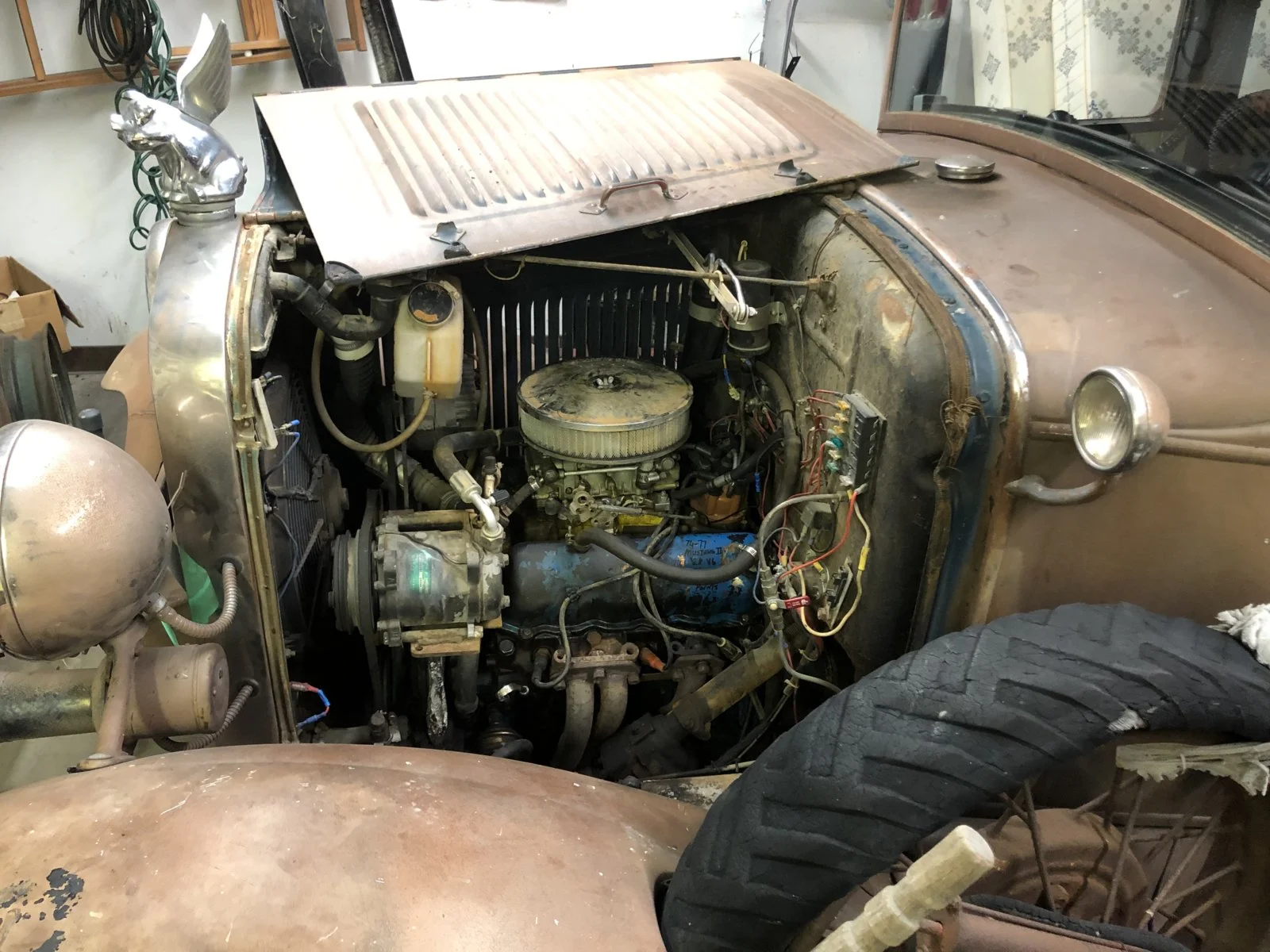

Here are pics of the car

We want a picture.

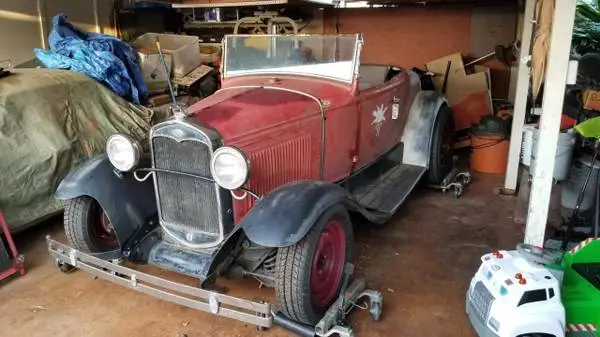

This Model a with the fordv6 is in paper now for 8500$

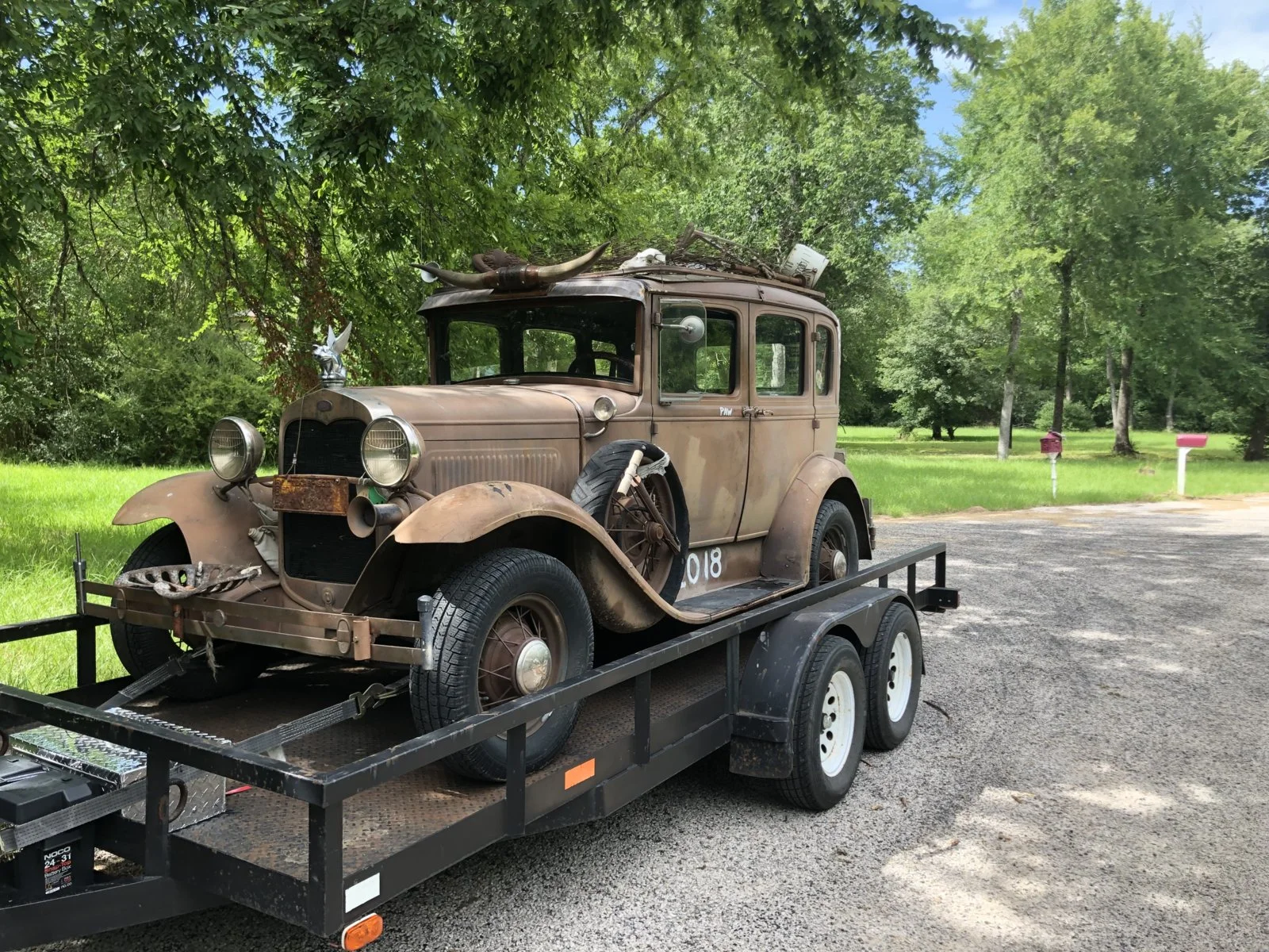

So that makes the third model A with a v6 cologne in it. The one at the top of this thread, the roadster for $8,500 and mine which is not very far along yet. This winter when construction slows down i will make more progress. (and after grass cutting season). It sucks to have a day job>>>
