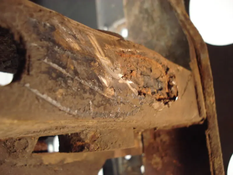

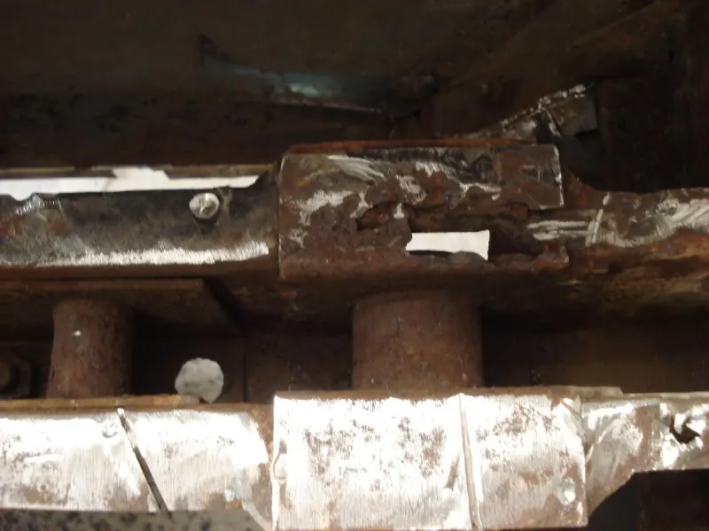

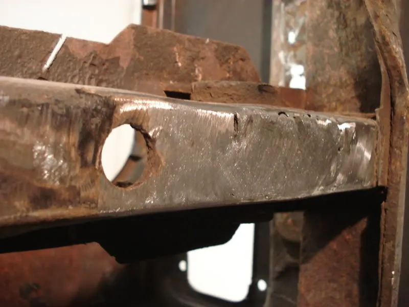

I have a couple areas on the frame rail that need to be patched, one is under the rear spring mount, the other is beside whatever that brace is?
The 1st question is just out of curiousity, what is that brace for, there was a bolt through it holding an exhaust hanger, seems like overkill for just that?
The 2nd question is on removing the spring mount, is there anything holding it in there other than some spot welds on the top flange?

That cross brace is additional reinforcement of the rear cross on convertibles.
There should be more than just a couple of welds on the spring eye. The factory dual exhaust hanger attached to holes in the rail that you don't have. You can see the outline in the surface rust around the mounting holes.

It looks like it may be more hassle to remove than it's worth. What seems to have happened is the bracket and mount have rusted and expanded causing the frame to split, like a pipe when the water freezes in it. I'm thinking maybe I can just cut out the split part of the frame, grind out the mountain of rust and then weld a patch back on. The frame is actually very solid other than those two areas and I'm a little nervous about causing more damage while trying to remove the mount. I had a heck of a time getting the bumper brace out, I could see this being as difficult. Hard to drill out spot welds when you can't see them.

You may have noticed the one I showed had already been cut out of a car. If you can't repair the damaged sections in place you'll have to cut and replace.

Yes I noticed that, I'm now hoping to repair the damaged pieces in place. My fear is my frame will look like the one you are showing by the time I hack out the mount turning a small problem into a big one.

What are those Reinforced holes for
I believe those (2) holes with tubes are for the shipping/transportation brackets. Some dealers never removed them and later others used them to suppport the dual exhaust.

The two horizontally-aligned holes are for the tie-down plates, the two vertically aligned holes are for dual exhaust, non-dual cars didn't have these.

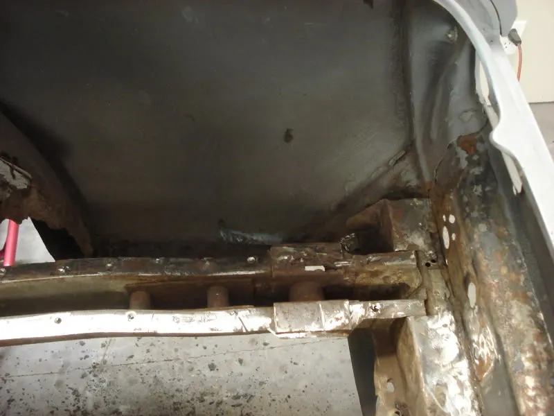

The frame I showed you was cut out from under this floor. Notice you can see the new rail under the floor. They do this one piece at a time to preserve accurate dimensions:

No harder than taking the floor out first. You see all those holes? I mean the round ones. That's where the welds were drilled. They had to replace the entire rail on both sides. Funny thing is, the front ones were OK.

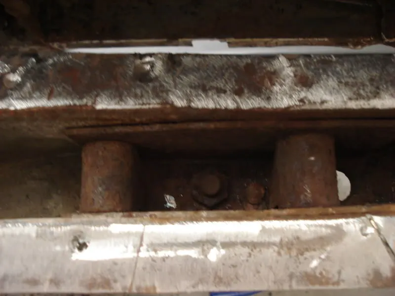

Quick question about this bracket. Is it spot welded to the frame or just held with the one bolt? I've removed the bolt so I'm not sure if it's welds holding it in place or just rusted in place?

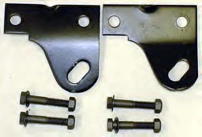

We have a terminology disconnect. Your "bracket" is the reinforcing plate intended for attaching these. They are where Ford anchored the rear end of the car during shipping:

Well that makes much more sense, so the dealer didn't always remove the bracket. Mine was removed so it was the reinforcing plate I was thinking of, bad terminology on my part.
Do you know if it's welded in place? There was a bolt through the bottom center of it which seems redundant if it's welded?
It may be easier for me to patch the frame if it's removed but I don't want to go all nuts on it trying to remove it either.

Shouldn't be a bolt there, that must have been added by someone. They were welded in place, so they wouldn't shift prior to the plate being bolted on, and of course since they were captive in the rail, they'd rattle if loose.

Thanks, I guess I'll just leave it there and weld around it. Unfortunately stacking metal on metal is just asking for a rust problem. I fixed the part under the spring mount, still have to finish the weld, ran out of shielding gas as always on a weekend when they're closed
Thanks for always taking time to answer my silly qustions
Looked like this before and so does the side by the reinforcing plate
