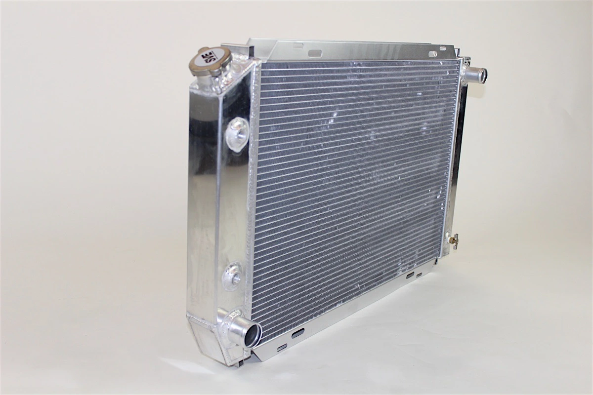

Hi again. Building my 93 notch. Just bought a new sve radiator kit and noticed the radiator had 2 holes on the left side right below the cap, what are those for and do I need to plug them?

The holes on the left side are for an automatic transmission cooler, so you dont have to plug them if your not using them if you dont want too.
