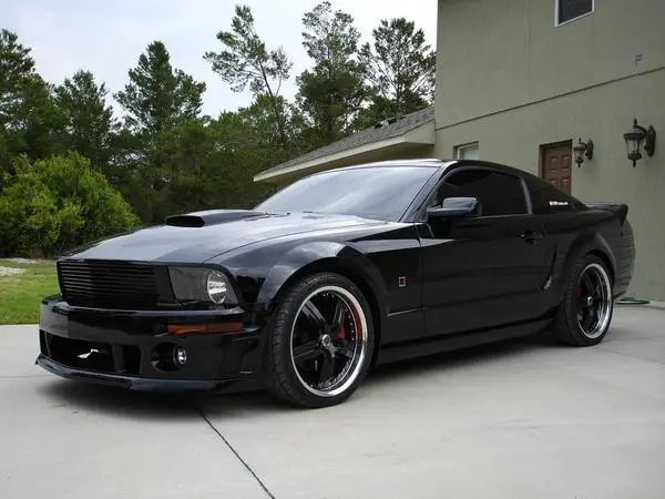

No, mine do not. I do know a few people who are running some 20s with some odd back spacing and a big drop that do rub though. At the same time, I know some people who running big drops and 20s with no problems. I'm running 20x.8.5 American Racing Rogues all around, going to do 20x10s in the rear soon as I get some more power. I'm running the Steeda Sport Springs with Tokico D-Specs, no rubbing, even over rough terrain going fast.
