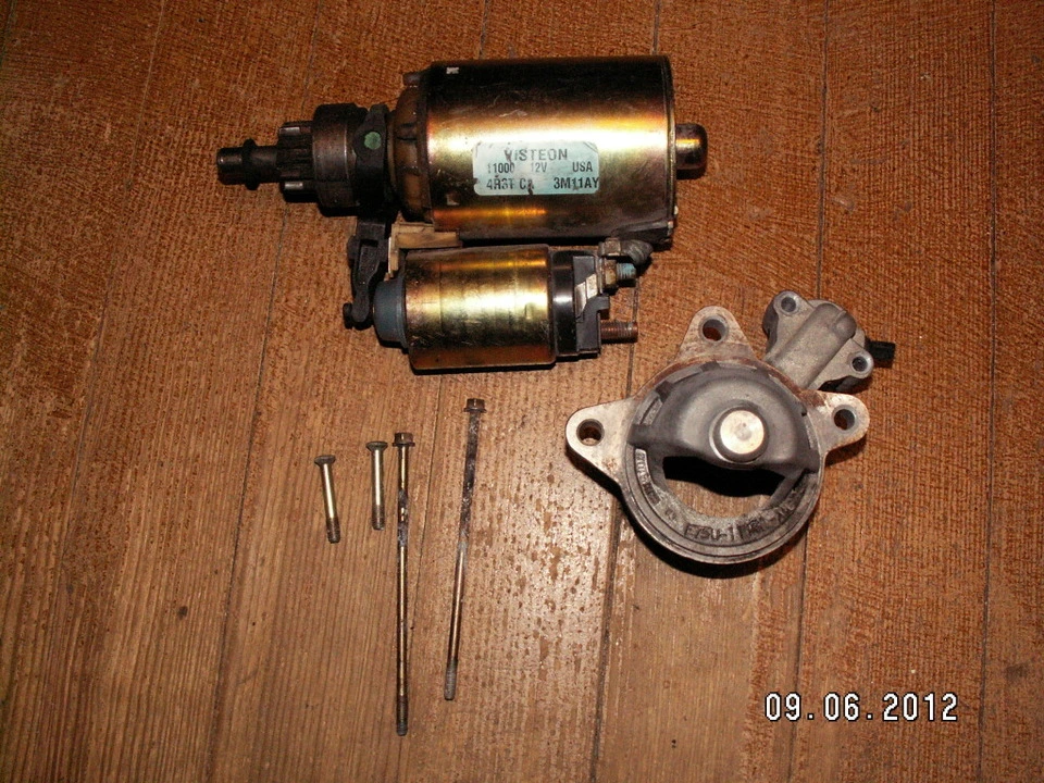

Here's the motor the way i got it. from Ebay for $20

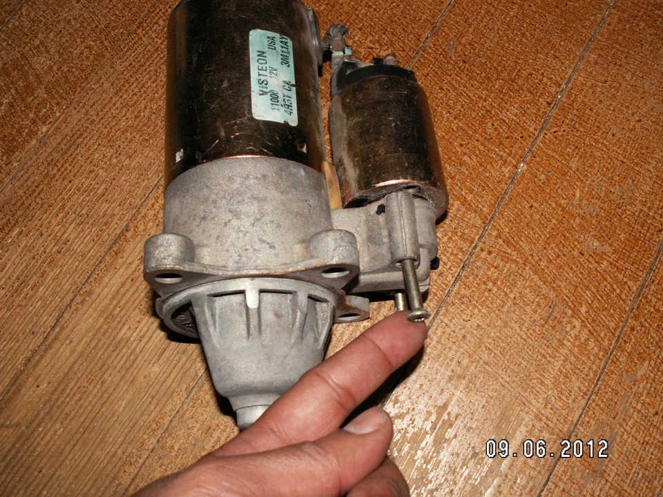

Solonoid T25 torx screws

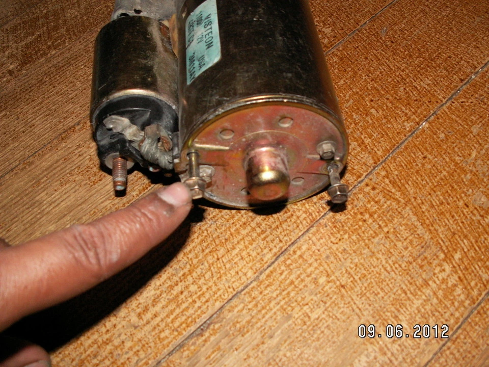

8mm screws for the motor

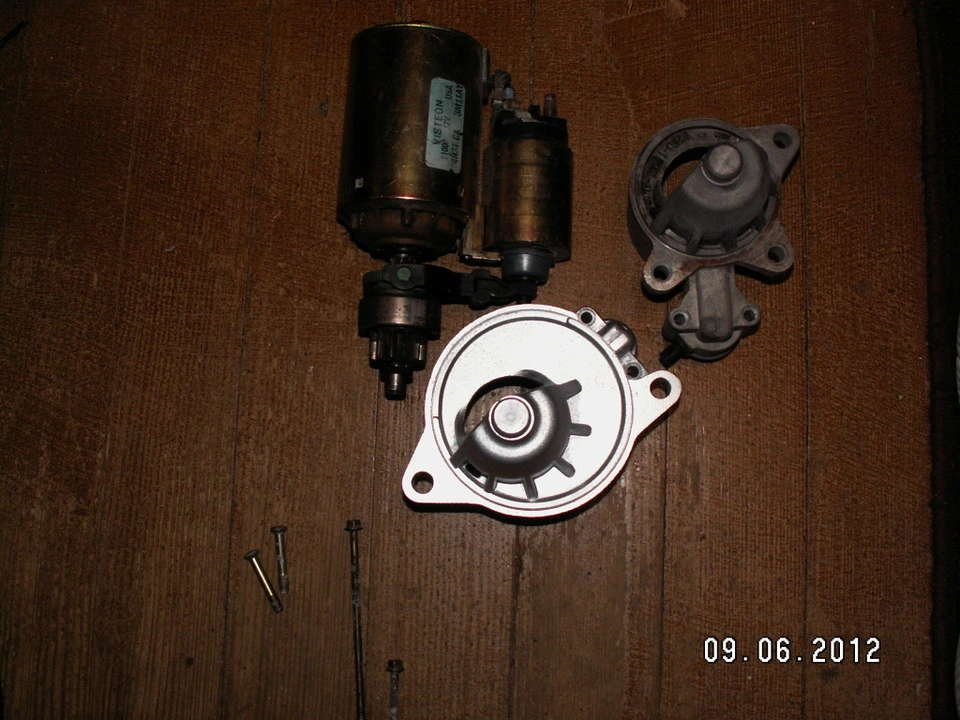

With the 4 screws removed everything slides out like below

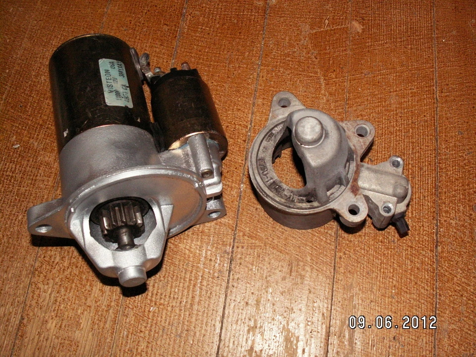

My nose from the old starter that failed alongside smaller modular nose. (Dis-assembly is identical for old starter)

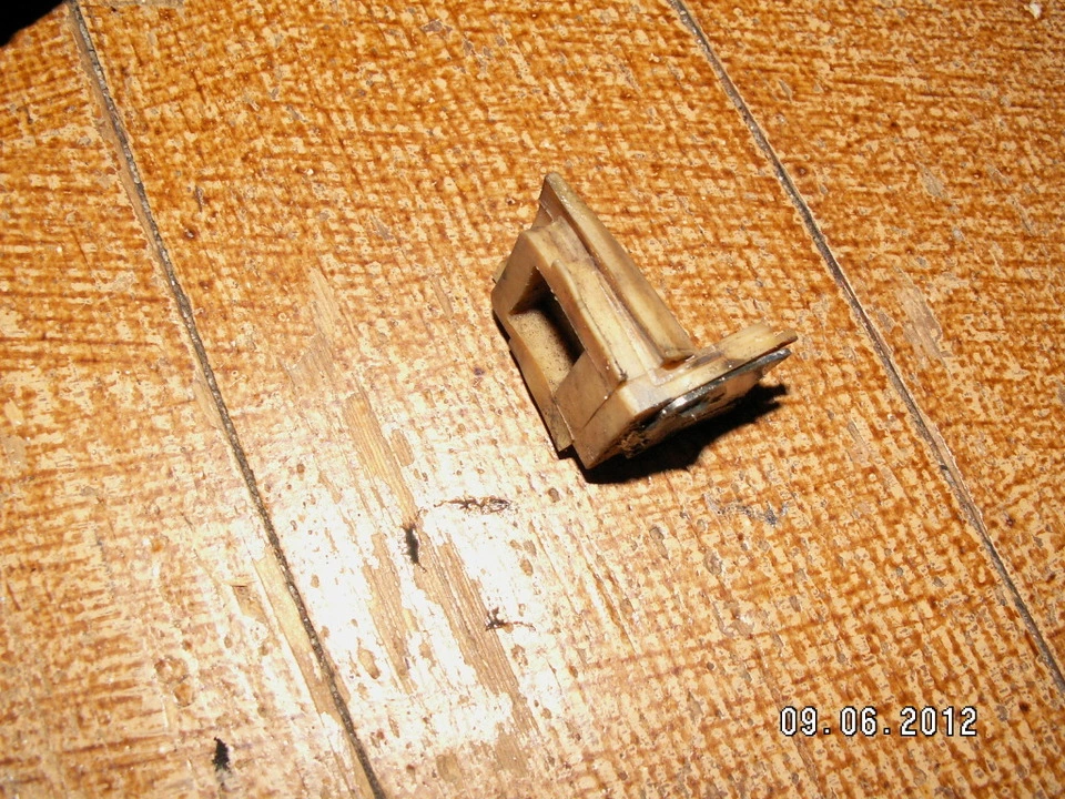

This gasket/striker piece was different between the two starters and i needed my original as the new one was wider.

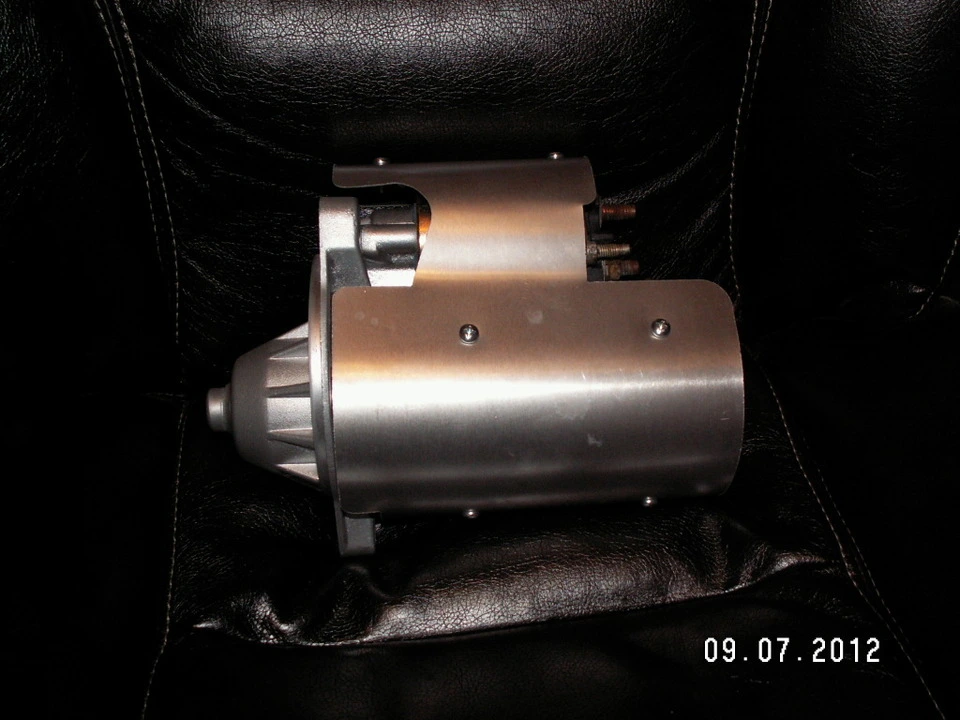

Below is the job done...
With an aluminum heat shield
I did this first with a mustang starter i had lying around when i needed to fix a friends 1994 v6 explorer. It seems all the ford guts are the same. Only the nose and possibly the gasket/striker piece may vary in size.
Side note.... the 2004 mustang had needle bearings in the nose which my 95 starter did not. But both shafts are the same....Ford just improved the housing by adding needle bearings in later models. I added bearing grease to the solenoid arm/striker area as well as in the nose where the shaft sits.
