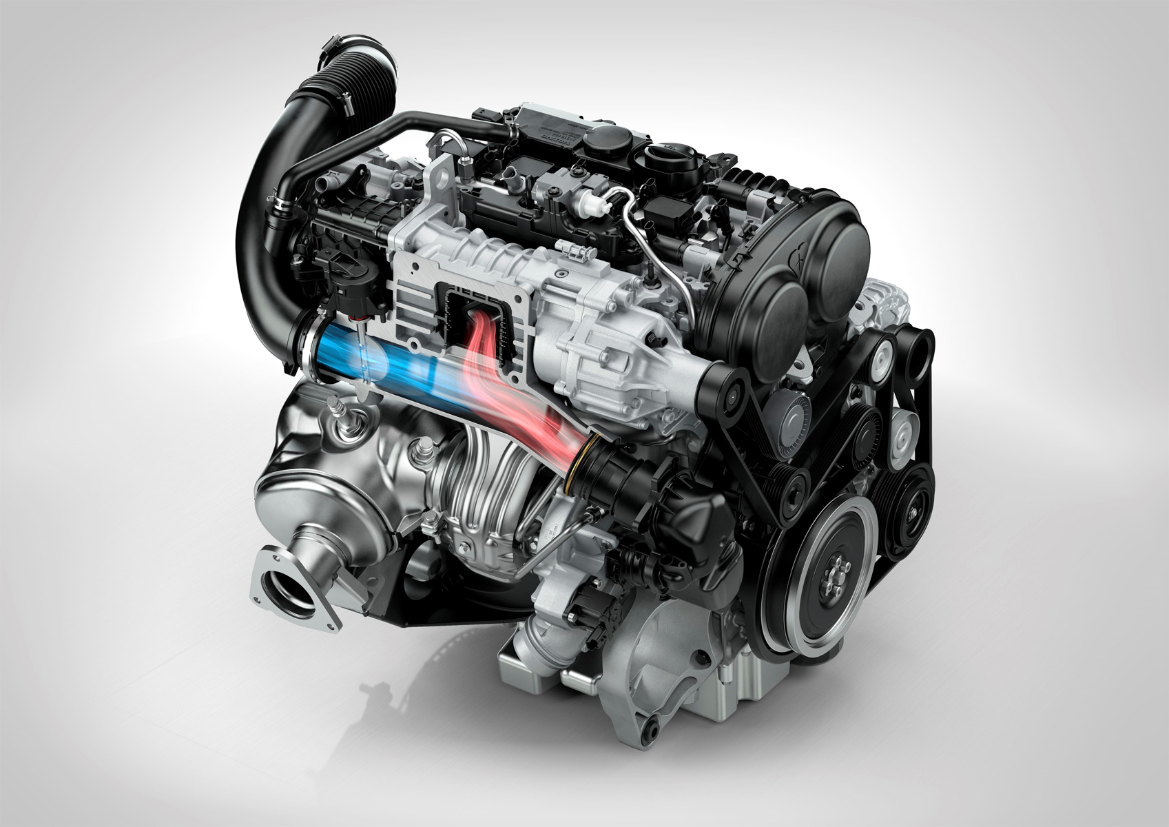

Then there is always a third rarely-utilized option:
Twincharging using both a supercharger and a turbocharger...compound boosting that has the potential for the best of both options. Hard to say how well a carbed engine would take to it though, most likely you would have to do some serious work for the carb to retain the pressure. I have seen a total of one twincharged engine personally in my life....it was a Supercharged Ford 3.8 with a large turbo on it....sitting in a Chrysler Conquest....in the junkyard. I always wondered if it was just an unfinished project or whether he quickly overboosted and broke something in the engine. A twincharged engine though, would give you 100% coverage of the entire engine RPM range though...probably one of the hardest builds to pull off without breaking things with quite a few engineering challenges.
