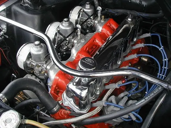

If I were to go through the effort of cutting off the stock manifold, I would be far more likely to use 3 Weber sidedrafts myself on a fabricated aluminum manifold...one less turn for the air to make.
Here is an aussie I6(detachable manifold non-crossflow head it looks like) with triple single barrel sidedrafts in a classic mustang.

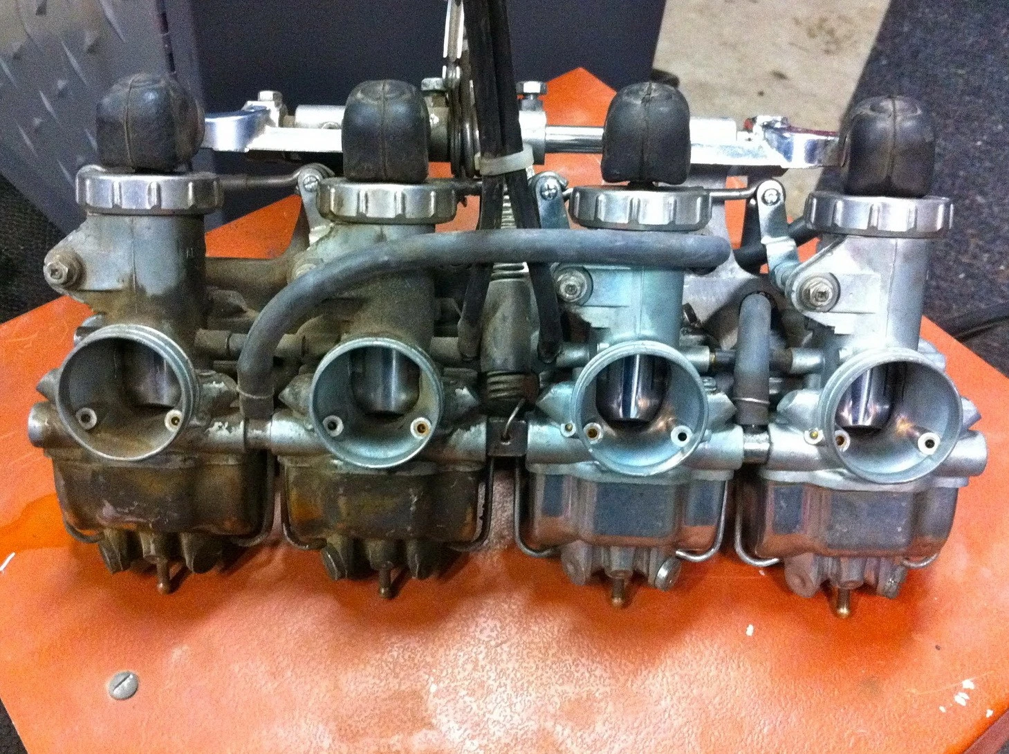

Another option is motorcycle carbs...they are single barrel, and you could easily adapt them 1 per cylinder since often they just use a short hose to clamp to the head(less manifold fabrication needed, though still some):
Most are set with a pre-determined port spacing....but you could always make a linkage like I use on my ITBs:
In your case, you would just be interested in a single bank though, much easier.
