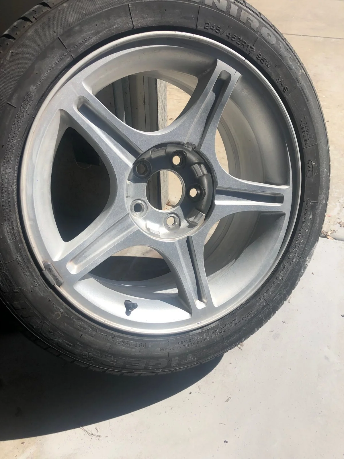

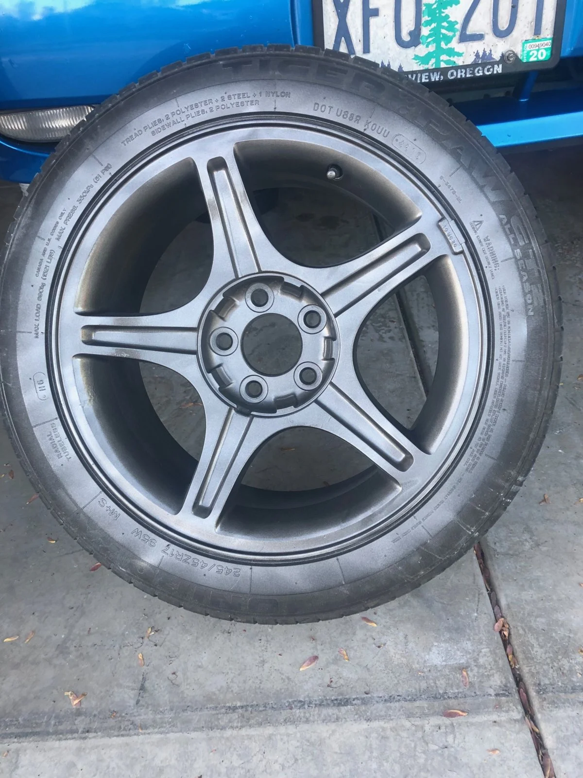

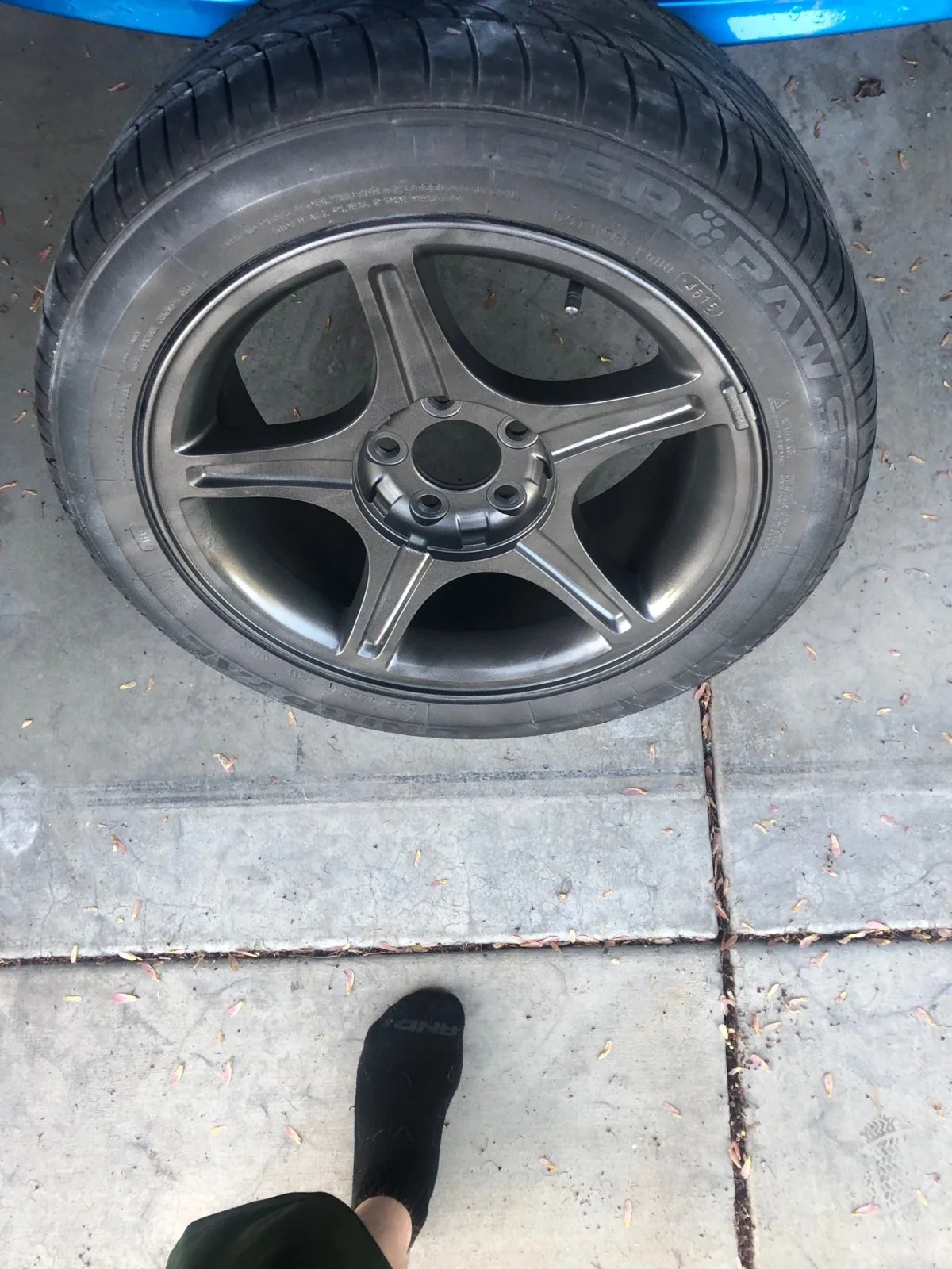

wanted a new look so I bought some wheel paint and after a light sand and clean they have a whole new look
