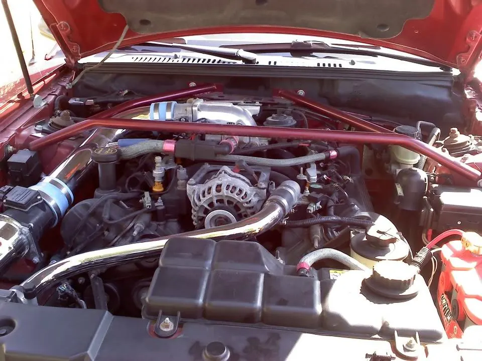

Hey all! Glad to find the site, as I am in a bit of a predicament. I have a 2000 Cobra R Clone 4.6 DOHC, performance pully system and tons of mods under the hood. I have included a few pics to show what she looks like.

It turns out it was a plethora of problems! I had to replace 2 O2 sensors, the fuel pump & the battery.
I should would like to have a few words with the butthead who did the mods on this car. I may be a chick, but I know my way around a car. This "dude" had wires shoved here and there, jerry-rigged the coolant sensor after installing a SS pipe, and while I can appreciate the $$ that went into doing all of this, he would have been better off paying someone to do the mods than doing it himself.
There was no seal on the gear box and I had less than 1 cup of gear lube when I took the rear end apart. (My father in-law, husband & I) Cleaned it all up, lubed it back up and it spins like a friggin top now! Replaced every filter and liquid in the car, and man can it fly.
