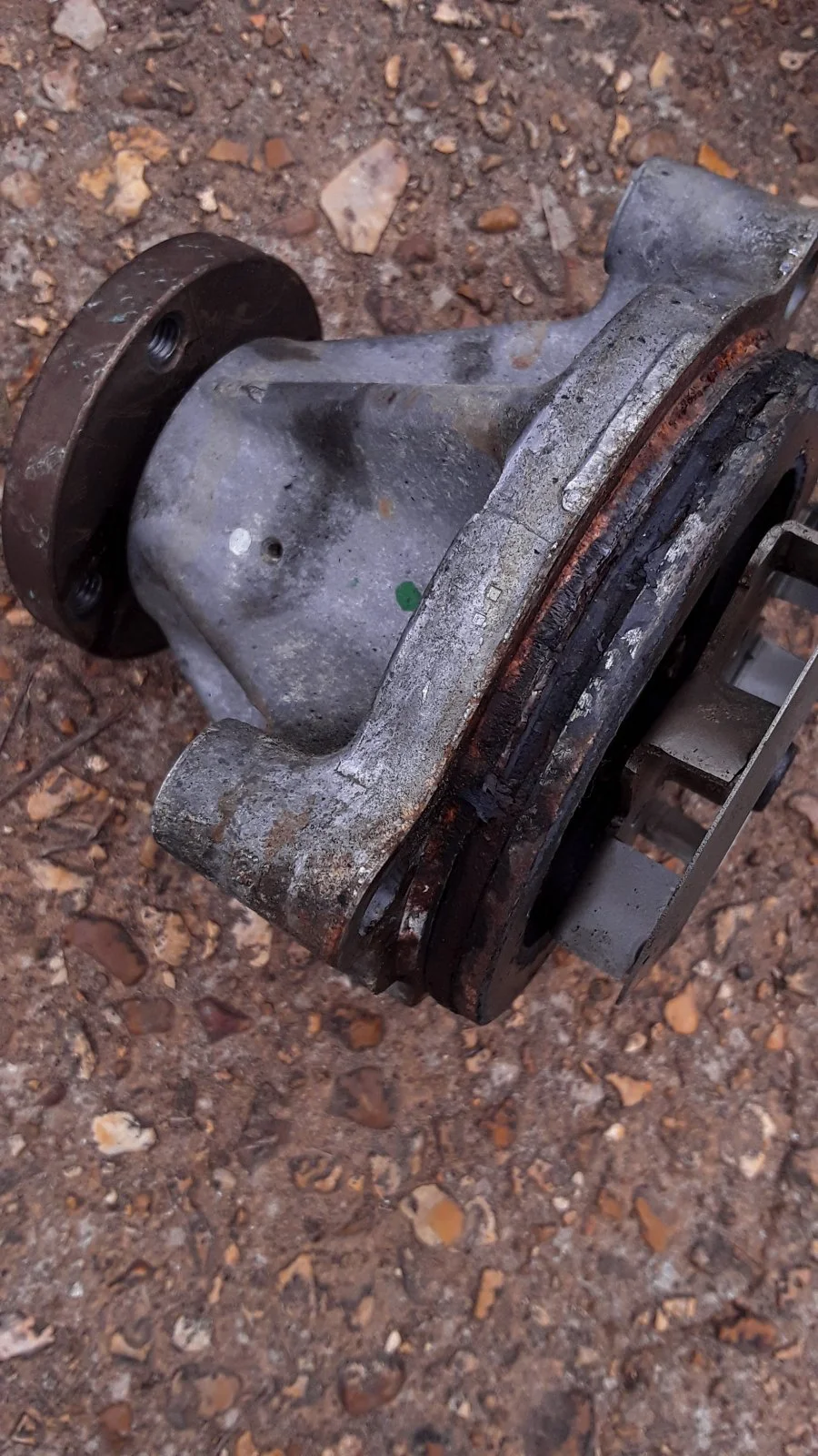

So You are Very Correct! The water Pump was an easy fix! I only struggle with getting the old one off! What a complete nightmare! Once I had it off then it was very simple to put the New One in! While I was doing that I also changed out the Serpentine Belt and cleaned the engine! I also checked hoses and all other pulleys for damage! Everything went very smooth! I added 2 pictures of my old water pump! Wow! It was Not looking so Good!
