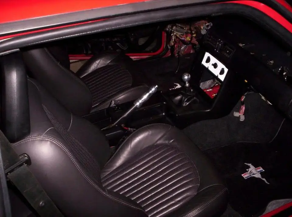

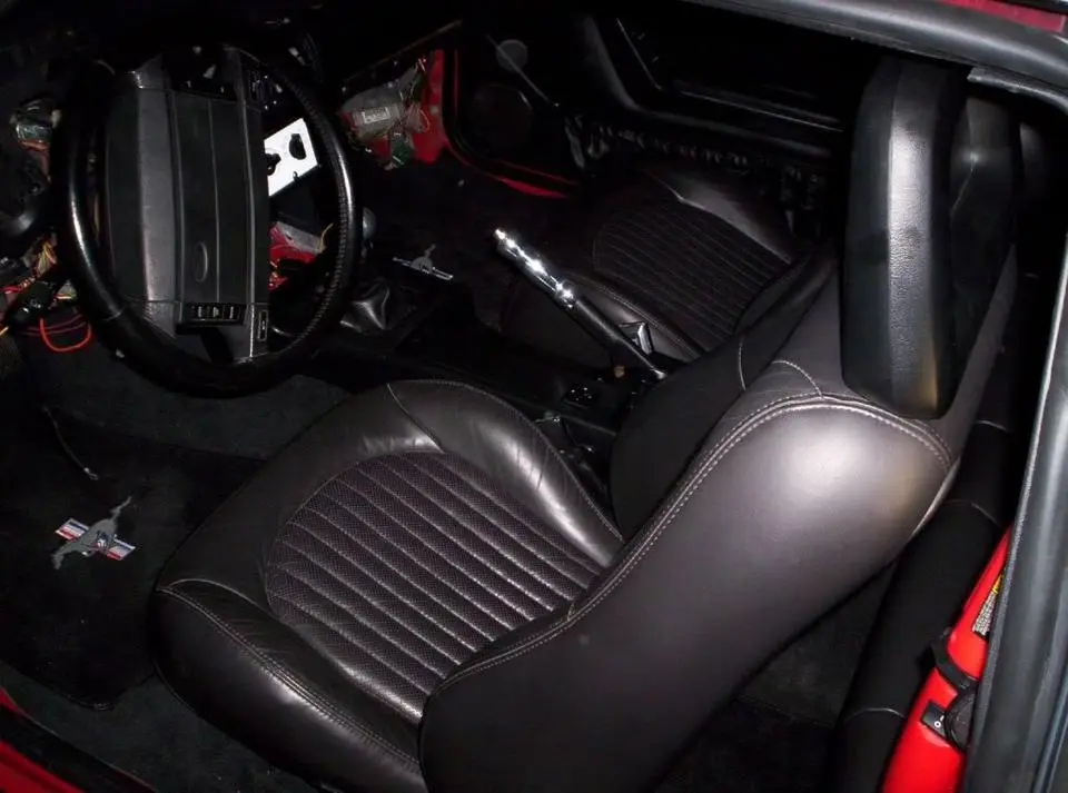

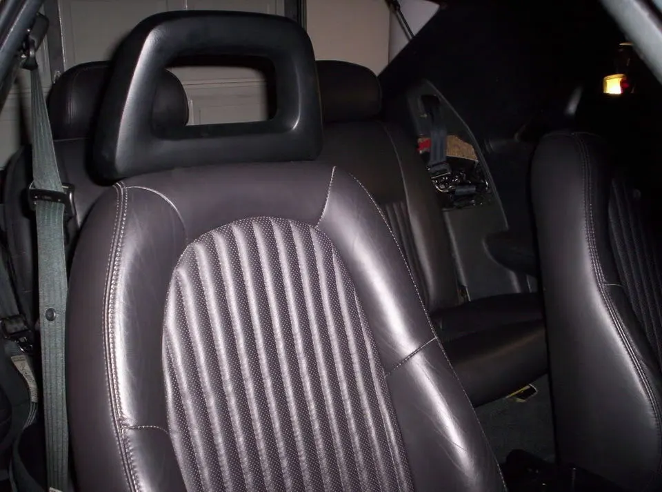

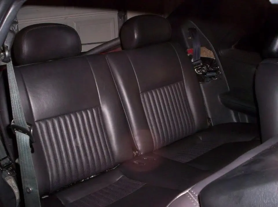

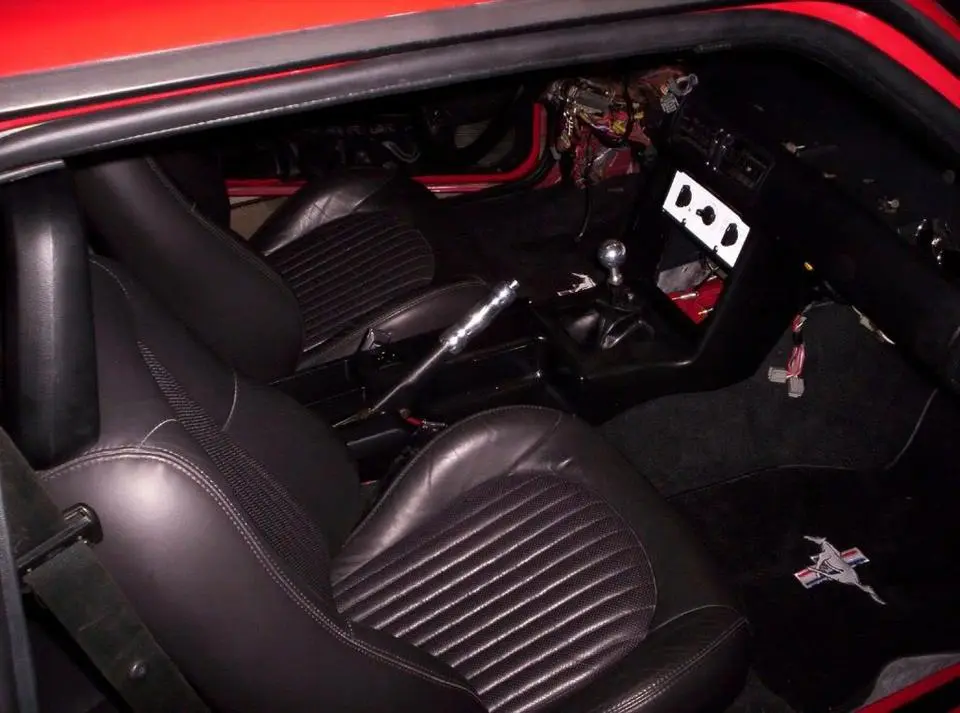

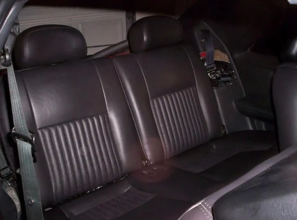

Here are some pics of a friend's Bullitt seats in his 91 LX to tide you over :D
