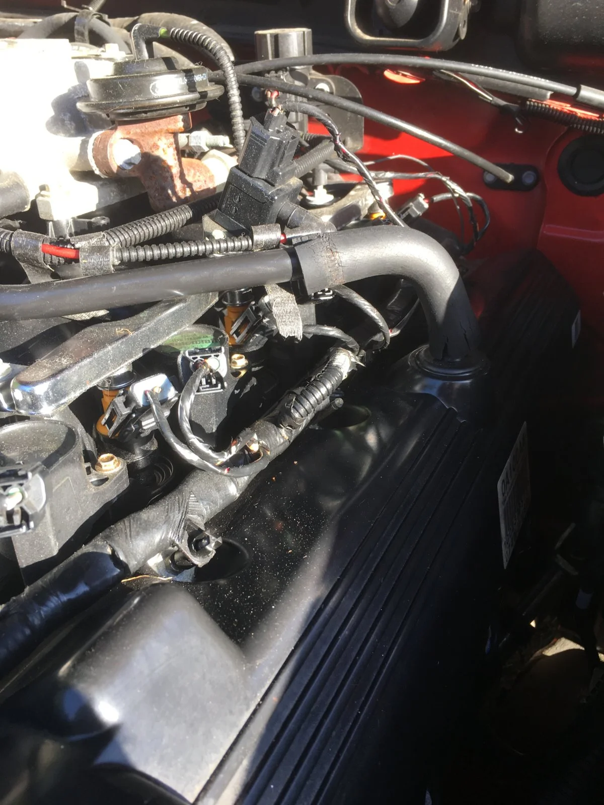

I am trying to find a hose also, it is breather hose from the driver side valve cover, it is a 90 degree bend.
If you can't find what you need and don't have to worry about emission testing((won't pass visual) then since the PCV is in the other valve cover I believe, then get a push in filter/breather
and cap off that line.
I haven't gone out to measure/look at mine, but the photo Peder posted looks a lot like a bypass hose would work...see if your local parts store can hook you up. Failing that, by replacing the straight nipple on the valve cover with a 90 degree, one could run a rubber hose the entire length (negating the need for the metal tube).
