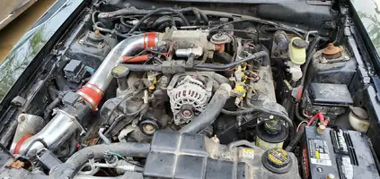

I let it idle for probably 30 minutes like this. Still no codes. Then I remembered to do the KOEO and KOER tests with my scanner. KOEO came back fine. KOER shows a P1000 and P1101. Maybe it's the MAF causing this? I did take the cold air intake off and clean the MAF. I also installed a new SPECTRE air filter because the old filter wouldn't clean. It also seems to only idle like the above videos once it has some heat in the motor. At first I thought it had some bad gas in it. Timing is randomly off, maybe? I will add some live data later this week. Here is a pic of the engine as it was when I got the car. It has yellow coils (Accel maybe?) And orange injectors.

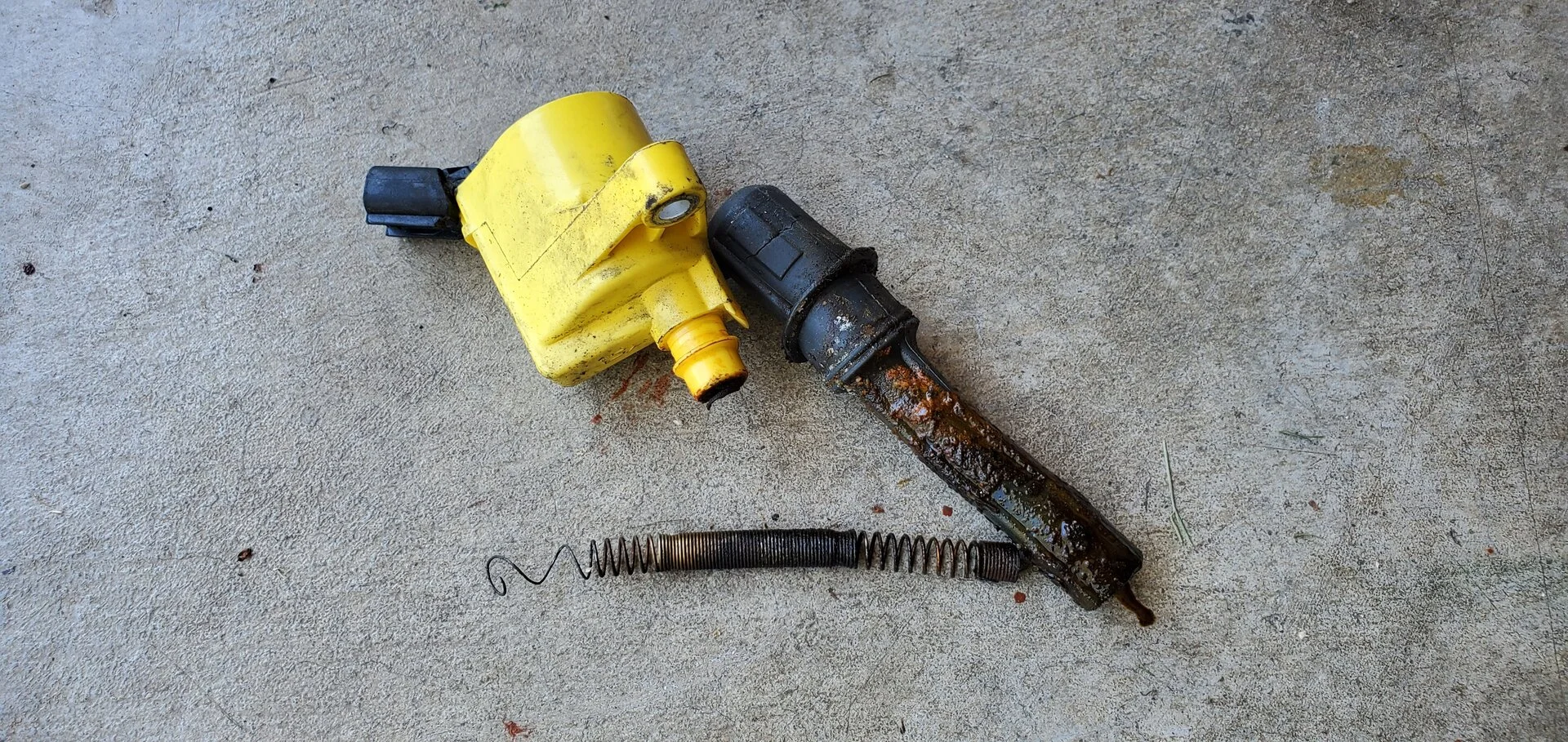

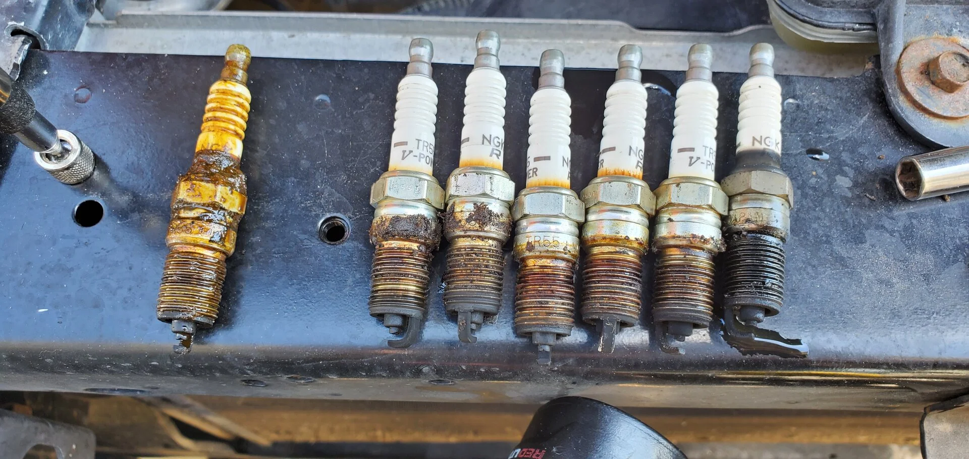

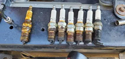

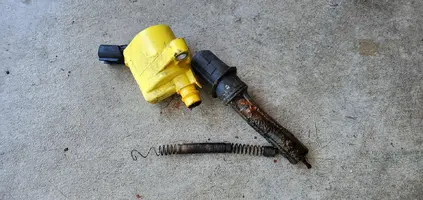

So all 8 plugs were NGK TR55s. And they were black. I replaced the #4 coil and all 8 plugs. I also swapped the MAF sensor with a used unit from pick and pull. It still hates anything below 1/2 throttle, but I managed to run it up the highway about 5 miles. It pulls fine at full throttle. Anything under half and it won't stay running. Tps voltage reads .95 with the key on. See pics below of the coil and old plugs. It almost seems like a ground issue. Is there any live data that I can show you guys that might help?

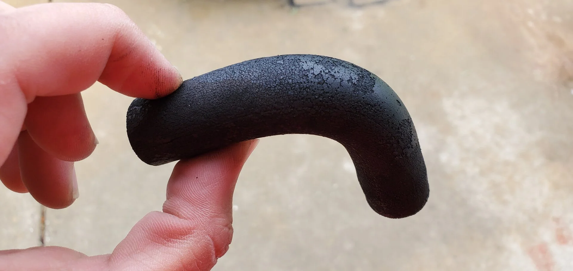

I got it to run well enough to take a 17 mile drive last night. It ran crappy, but it ran. When I got back it had a P1151 and a P1131. I didn't mess with it much today, but for the 2nd time starting now, there's been black splatter on my driveway behind the tailpipes. It's oily. The plugs I changed were black and only had 13,000 miles on them. Oil getting past the rings maybe? I had about 30 minutes before work so I checked a few things in general under the hood. I noticed that the elbow from the vent fitting on the drivers side valve cover to the plastic tube was all but dust. It was rotted bad. When taking the tube out of the rotted elbow, the other end that goes into the intake tube just fell of the hose that attaches it to the intake tube. Very loose. So for the time being, I grabbed a zip tie and pulled it as tight as I could. It's now tight enough that it won't even turn in the hose. I put a new elbow on the drivers side at the valve cover. Ill check it Sunday to see if that helped any. There is a vacuum fitting off of the back of the upper intake that goes to a hose that runs down beside the passenger side strut tower. Where does it go? I couldn't see well enough to follow it. That hose is fairly rotted as well.
