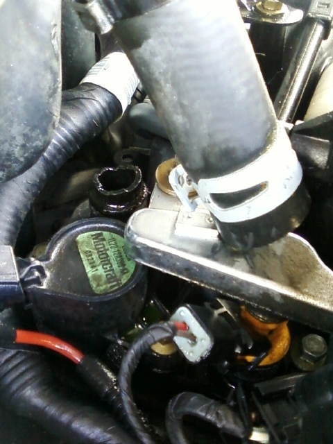

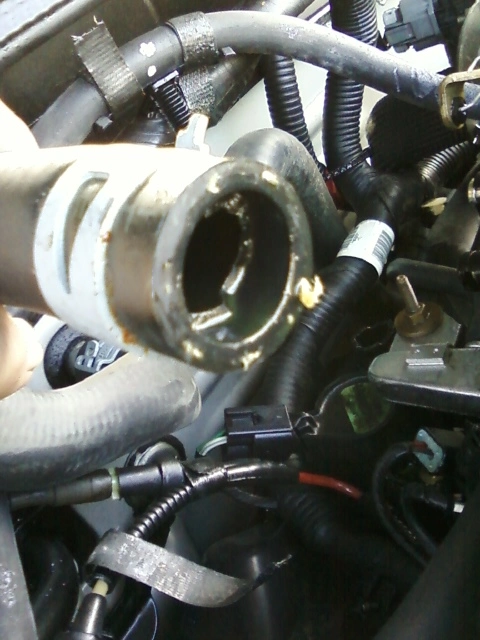

So I'm driving my car today and part of the intake manifold cracked where a heater hose(?) comes off the firewall and into the manifold, Im just curious how common this is or why it may of happened, the car has 75K miles. I noticed the intake is plastic which kinda surprised me but I guess ford has there reasons for using it.
When this occurred it caused quite a smoke show,smoke was billowing out from behind my car and from under the hood, also my right rear tire, rear bumper area / taillights etc got coolant sprayed all over them, my motor was totally drenched as well.. Good times...
Not much to explain here lol...
Part of the intake still clamped in the hose....

hey man... thats the line that goes from the engine to the heater core (climate control). the best thing to do is to change the intake manifold which runs for about 250.00 i think.. thats for thwe stock fodr racing one. quick repair? plug it or find a tube or something that can fit throught the manifold and onto the line, but this is only a temporary thing. eventually will crack again... th process to swap the manifold my look tortuous but it is rather simple. the haynes manual has a good description on how to do it. hope this helps. keepme posted on what ur thinking on doing. cheers!

The intake manifolds on 96-00 typically crack at the plastic coolant crossover, found on the front of the intake. I have not seen one break back at the firewall though. The revised intake, which features an aluminum coolant crossover, still has a plastic nipple for that particular coolant line that broke on you. Hopefully this is just a fluke, though you may want to see if something applied force to the line causing a break before you replace the intake.

Yea I was also wondering why it would break at this neck location, Maybe the hose was somehow restricted and the force of the motor twisting etc caused it to eventually snap off, but I was able to move the hose around fairly easy so not sure...
