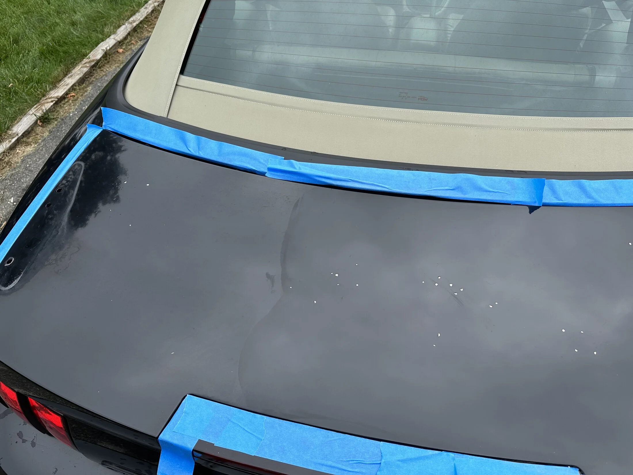

Apparently I only took one pic in progress.
The trunk has issues, which is why i didn't feel too bad drilling into it. I should look for a replacement one if i see any local cars gettng parted out.
I used 3000 grit for wet sanding and then followed up with Meguires compound and polish. I don't know the cuts off the top of my head as the bottles are home. Since the trunk was "junk" i did a quick job, but it came out decent. I'll spend more time and detail on the main body panels.
But left side of the pic is as is, and right side is post compound but before polish. While you can see a differences its hard to tell what the difference is. But the left side is very "milky" while the right side is clear and has more depth to the reflection.
You can also see the mulitple chips in the paint on the top. Only panel like this. They are deep, so it's either body work and full repaint to the trunk, or find an 01-04 donor trunk and hope the paint condition matches.
For the record, even cleaned up this car is not a show car. There are still going to be scratches and flaws.

Gotcha. Meguires ftw. Polishing with a DA, random, orbital? or by hand?
Ya, I knew the trunk had all those chips in it.... like some body strolled across it with old school steel spike golf shoes or something.... still tho, a great improvement. I know you still want to do plenty to it, but whatcha gonna do with the door handles?

By hand on the wet sanding, then I used a DA. I used a Griots Garage DA and their pads.
Worked well. I am by no means a paint correcting pro, but this attempt yielded decent results.

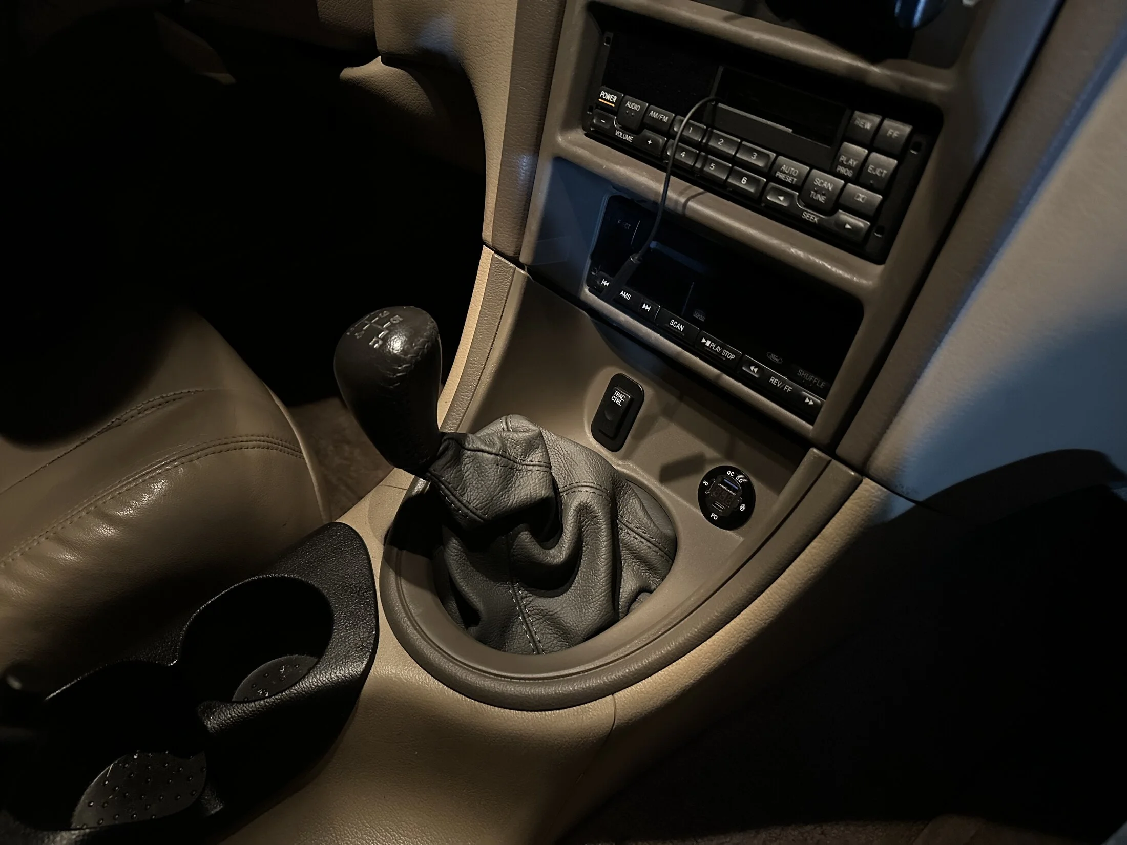

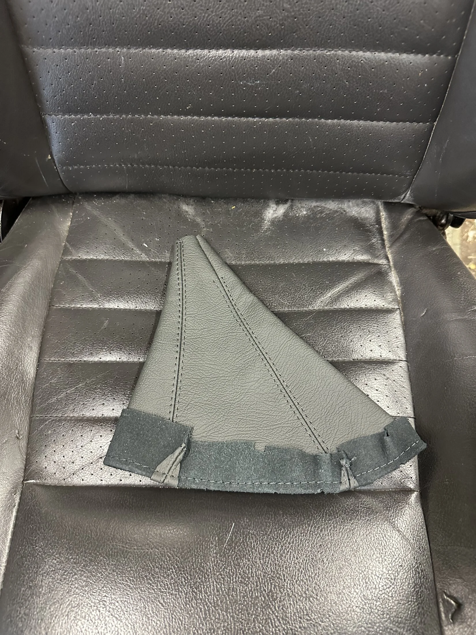

Bought a leather boot from Redlinegoods to try and class up the interior a tad.
Reactions: General karthief and bird_dog0347

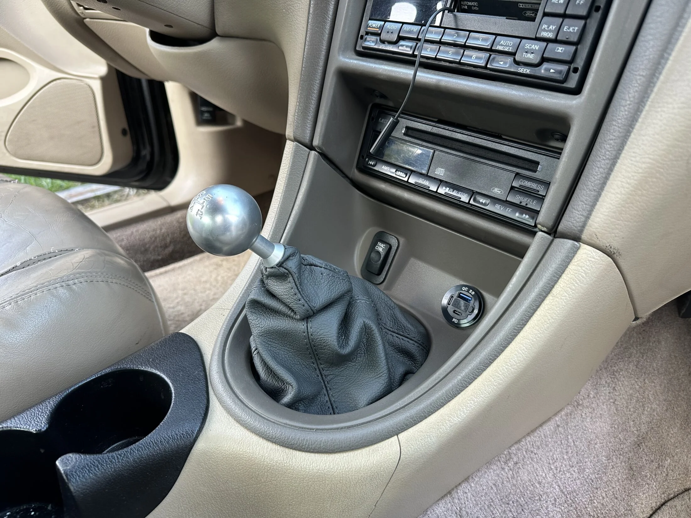

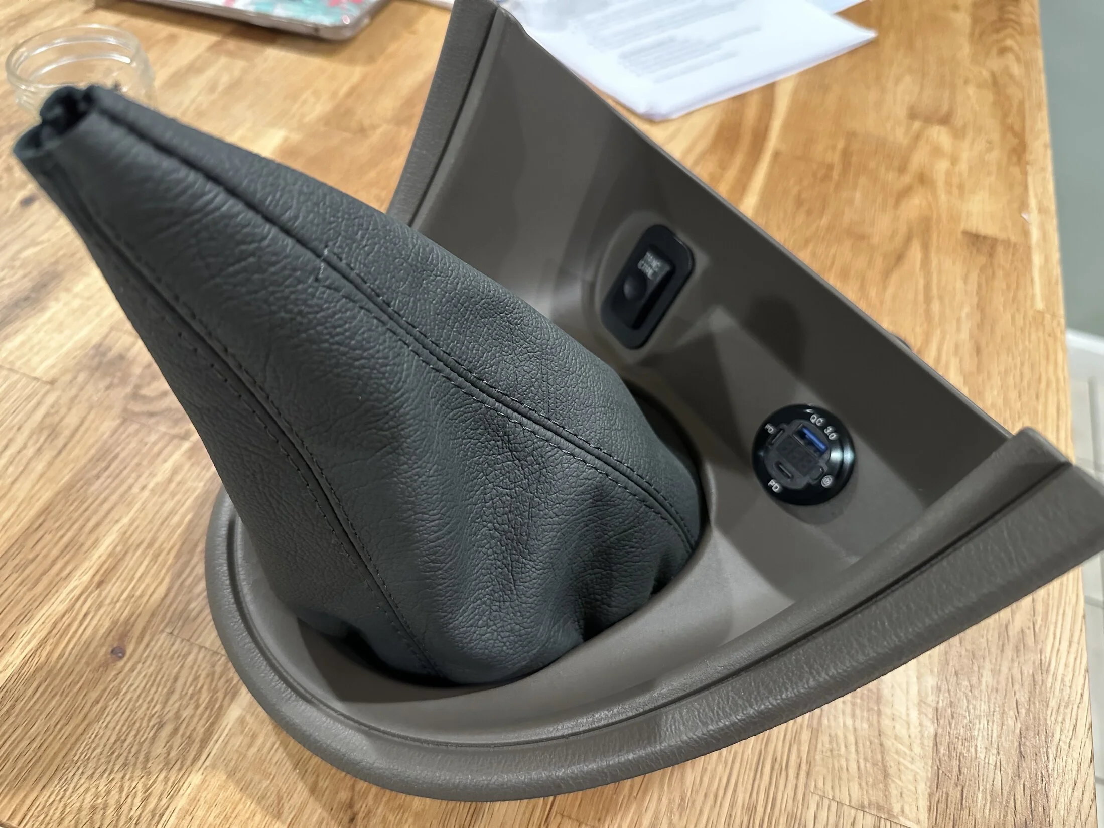

PITA to mount, but it’s on. Took the opportunity to do a fresh respray with the LMR paint.
Too dark for now, but wasn’t happy with how the Mach 1 knob joined with the boot. Stuck the stock knob on for now. Trying to find one of the old ford racing 5-spd knobs like I have in my fox. If I can track one down, that’s the winner. Not a fan of the repop version.
Now I need to paint the radio bezel too

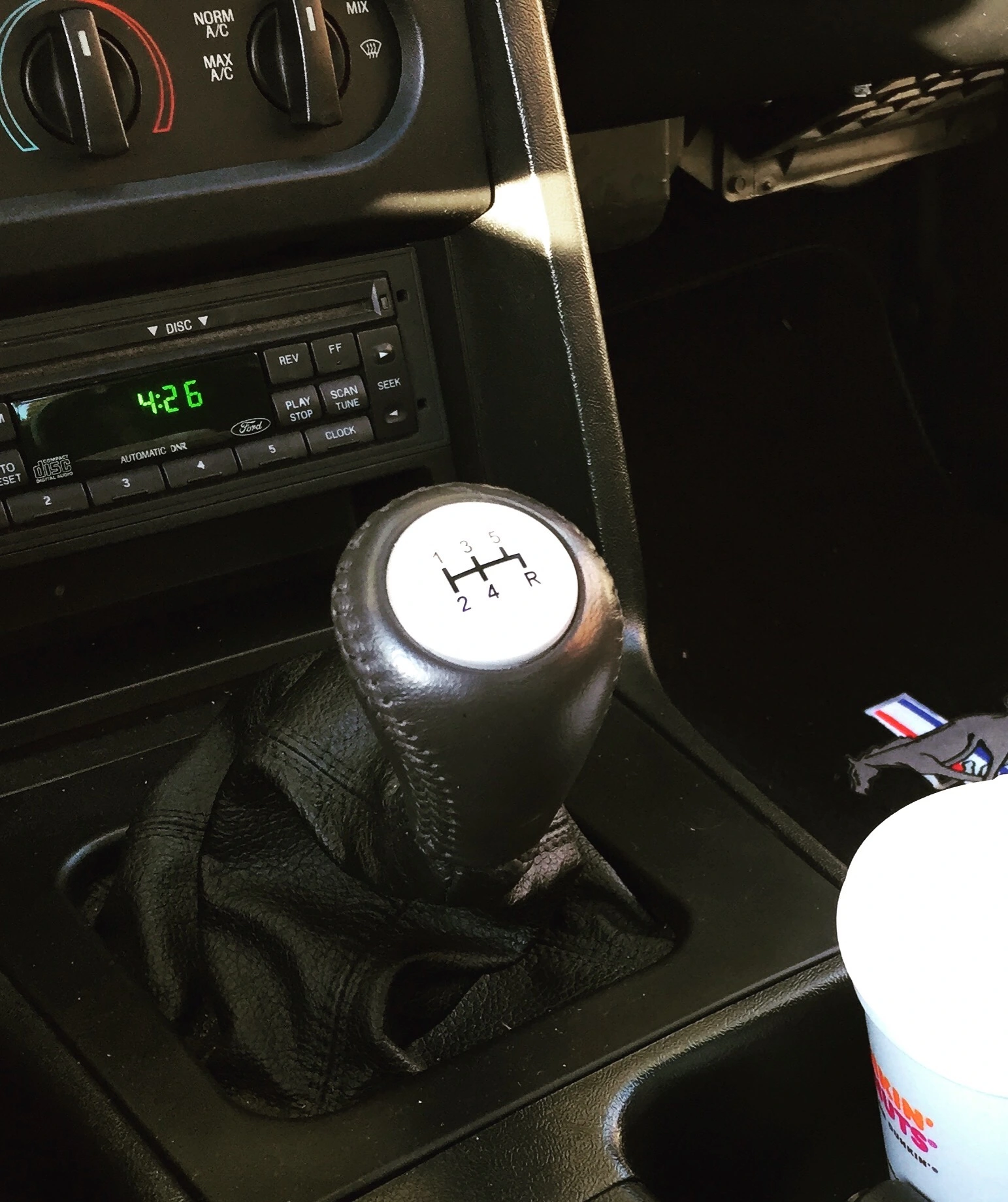

That is the factory 99-04 GT knob. I have several of those. Ford kinda used the same inner body and just changed up the exterior for that knob design. The Ford Racing one I'm after is the same except for the brushed aluminum plate on top. I have one in my Fox. Got a few ebay keywords saved to see if one pops up. I'm going to stick with the 99-04 knob for now, and maybe try to make my 03-04 mach 1 knob work with the boot.
But this is what's in my fox and I love this knob. It's the Ford M-7213-G. LMR has a knockoff, but I beleive the top cap is plastic. I'd rather find the original
https://lmr.com/item/SVE-7213H/mustang-cobra-shift-knob-5-speed-sve-79-04

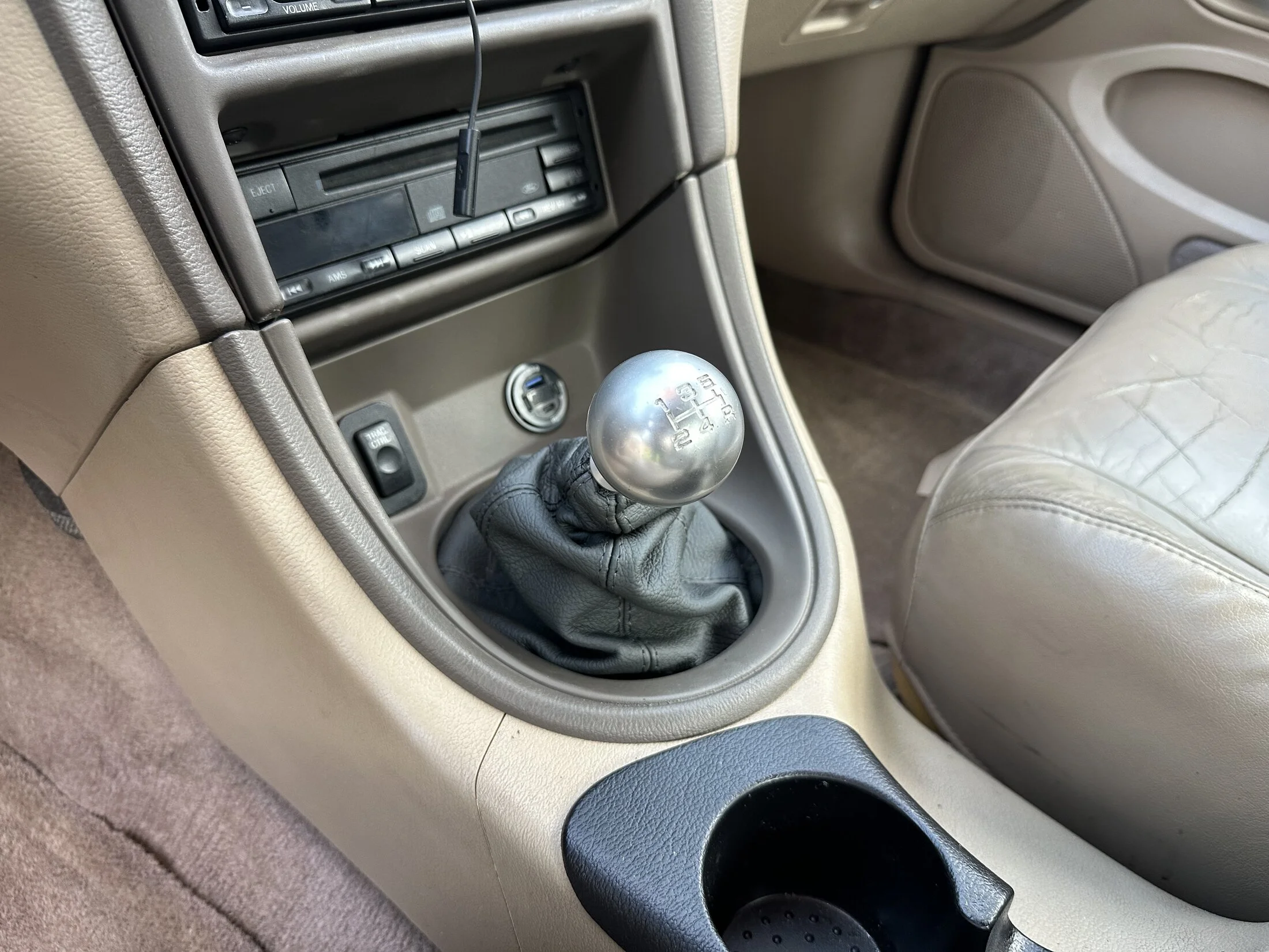

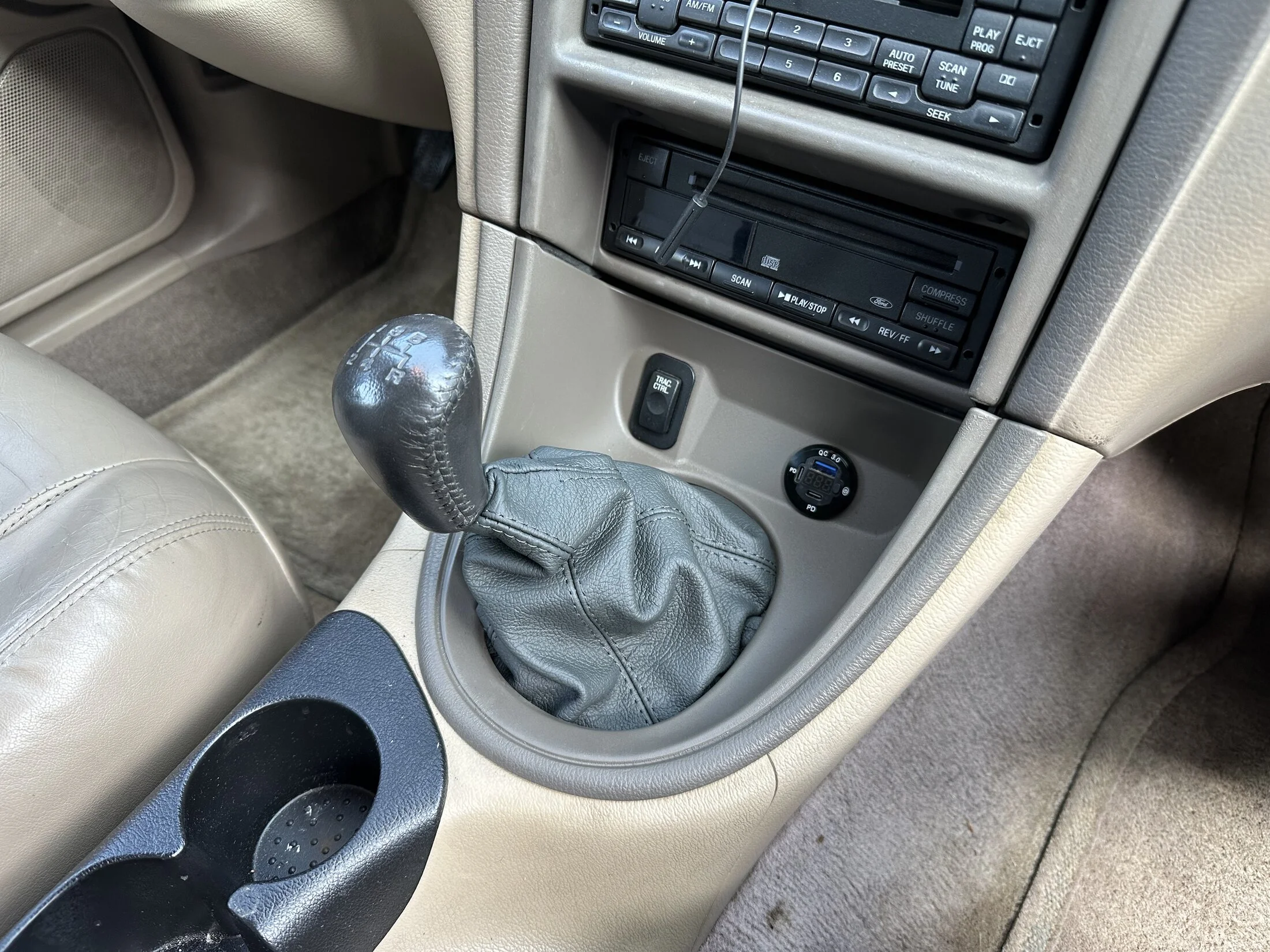

Meh, didn’t turn out the way I wanted. Color match is better in person but I can’t get the material to sit right at the base of the knob. I wanted to use the Mach 1 knob but it was worse. I’ll have to play around a bit

swapped to the short MGW race handle. Different angle so the material lays better. The shifter handle actually feels great, I thought it would be too short.
But the material lays better and I got it to work with the Mach 1 knob. I’ll try this for a bit.

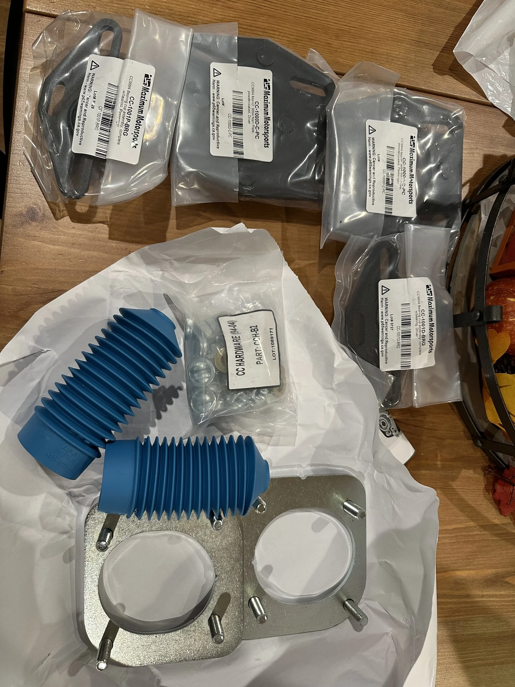

MM caster plates showed up. One more part incoming…
